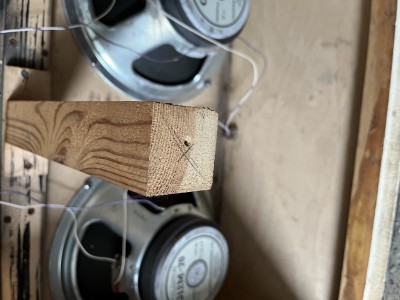

I had a friend drop in his old Marshall cab for a rewire, and I found fleece cloth wrapped around the post. I thought that is there to stop vibration. Sure enough the post was loose, I took the post out and with the help of a friend we replaced the staples with screws and glue. It’s quite solid now, I hadn’t intended to put a screw into the back baffle (fibreboard, not real wood) but he assured me that the screw would stop any possibility of the post vibrating against the back of the baffle.
It seems like a good thing and don’t know why Marshall doesn’t do it, any thoughts on the matter?

Hole drilled to secure the rear baffle

Good idea. Fiberboard glued to end grain. They should have predicted this point of failure.
Re: Centre post on Marshall 4X12” cabs?
The cabinets are designed in away that they should be tuned.
I shim the post from a handle hole. The back is marked inside for the position, and I hammer wedges in until I get the similar tight response to match cabinets to each other. The backs of the cabinets is arched out enough to see if you look very close. About 3/8ths in the middle.

Mark wrote: Fri Mar 28, 2025 12:47 am I had a friend drop in his old Marshall cab for a rewire, and I found fleece cloth wrapped around the post. I thought that is there to stop vibration. Sure enough the post was loose, I took the post out and with the help of a friend we replaced the staples with screws and glue. It’s quite solid now, I hadn’t intended to put a screw into the back baffle (fibreboard, not real wood) but he assured me that the screw would stop any possibility of the post vibrating against the back of the baffle.

this is a metal mod that makes for a deader, tighter cab. A bit of resonance is good for rock though

Thanks for the tip, luckily the screw can always be removed. I will try with and without the centre screw.

Reeltarded wrote: Wed Apr 02, 2025 12:33 pm The cabinets are designed in away that they should be tuned.
Tuning the cabs has never occurred to me. Did the wedges cause vibration or fall out?

So, the cabinet is sealed and I have a handle pulled out. I have installed a post that fits perfectly. I make .5in wedges and install them from two or three directions. about 1/4in of each adds to the shim depth. The only thing that can move them is age. They shrink.
I have used stepped metal wedges but they do fall out after a cabinet rolls a couple weeks and Highway Star has pounded through it 10 times.
Come at the post from both sides with a wedge until they overlap and it's basically like chock blocks on a jet. No knock, no scrub, no rattle. Full throttle. Big bang.

how much it matters depends on how resonant the cab is and whether you hit it with massive bass riffs or not. For classic rock I prefer stock cabs. but metal often calls for stiffer, tighter and deader cabs
