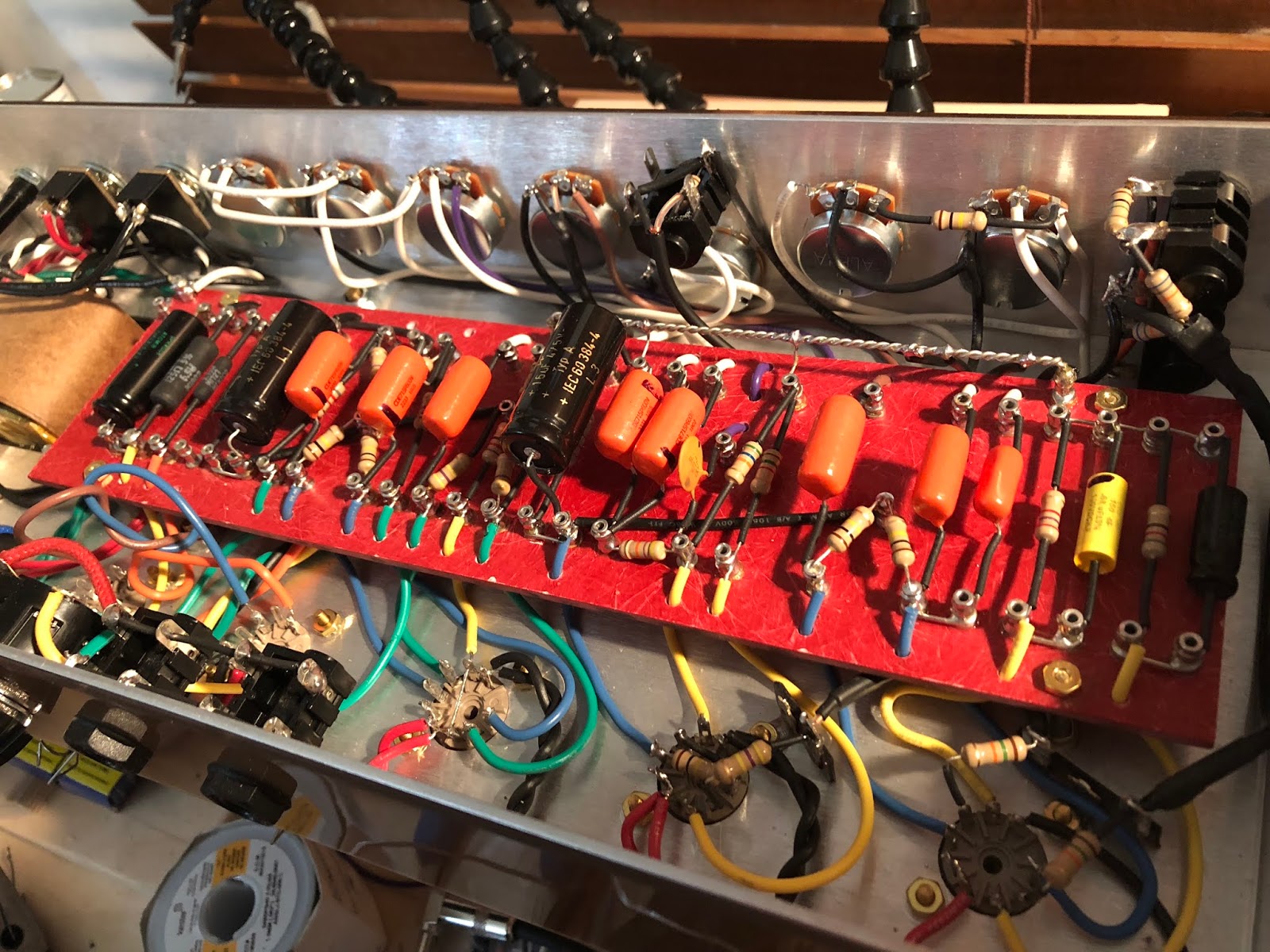

I understand and appreciate the give and take on the capacitor foil orientation issue. I'd never paid attention to it until this 18-watt TMB build. For what it's worth, I decided to mark them and orient them as correctly as I knew how. I fired the amp up for the first time last night and the amp is utterly dead silent when not playing. No hum whatsoever. I also took an effort to heat shrink the leads on all my board components which I also had never done before, as well as used Mogami shielded wire for the signal wires under the board.
Sounds nice, man. I have some fizz to work out potentially, and I'm going to switch out my JJ EL84 for some EH or better tubes. Looking for more bass.
