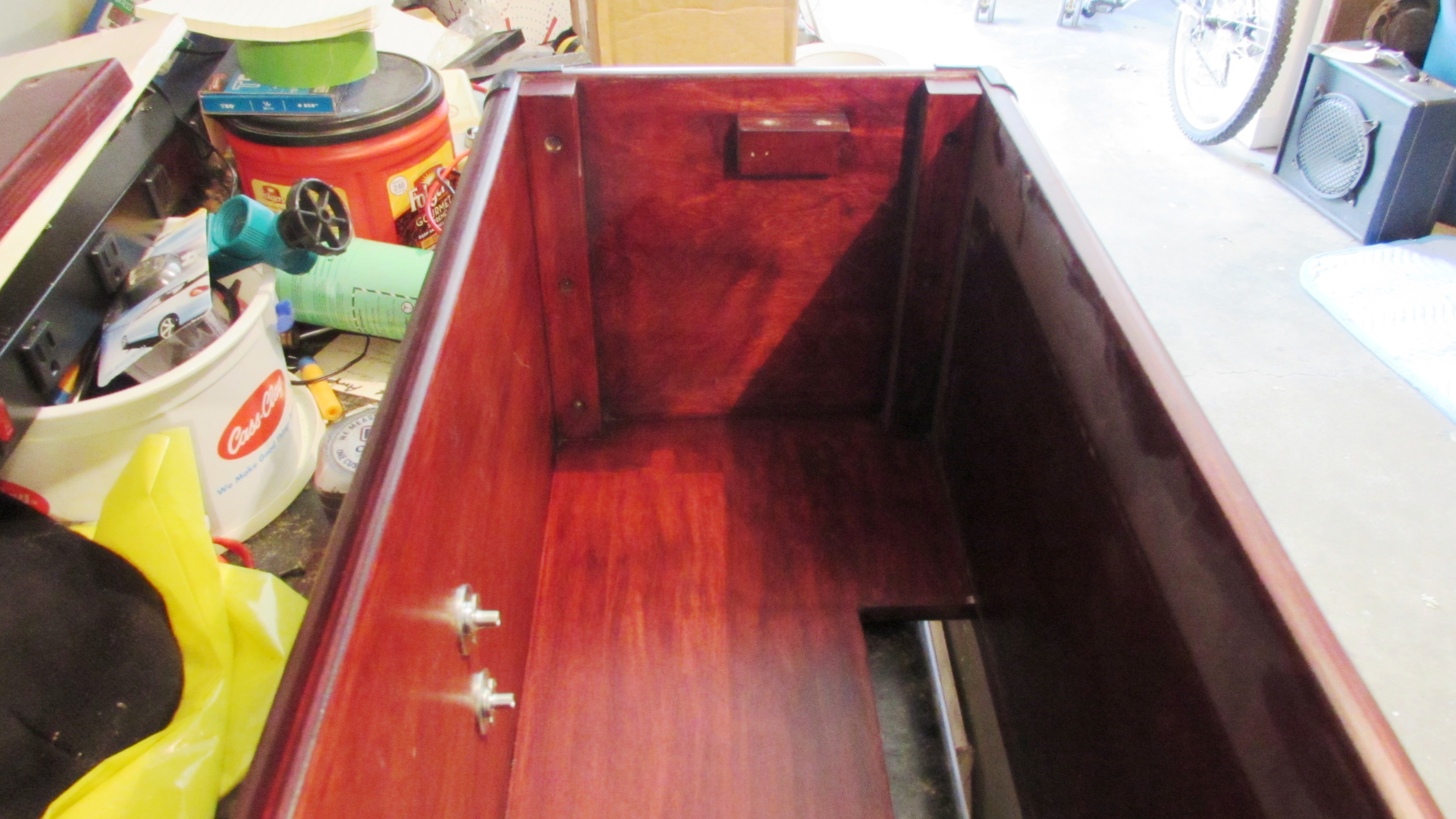

Was working on a guy's Ceriatone Super Lead 100 and I liked the cab a lot.
30.5" L x 9.5" D x 10.5" H
16.5625" x 2.375" front opening. Front is not inset it is 30.5" long
Back is 29.3125" inside Length chassis opening 27.75"
Made from 3/4" hardwood

Cool,I built a hardwood mohogony cab for a guy.Gots a pic somewhere but they look really cool,I like that one Mark

Many of you guys build some beautiful cabs, but I would be afraid to take them out of the house!
