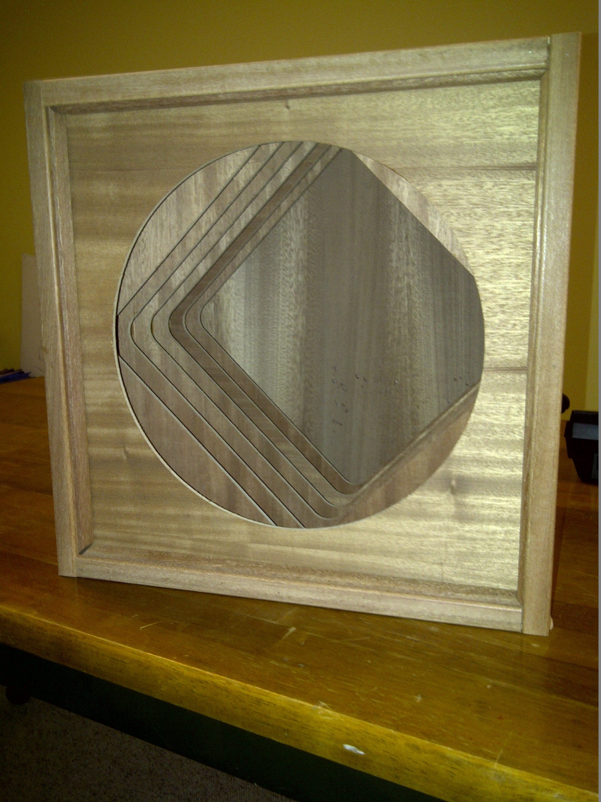

Re: Cab Resonance
Geeze:
This was my try.

Re: Cab Resonance
Come on now John, you tease. How did it sound? How much did it weigh?
That is a clever design and wood work.
Re: Cab Resonance
That's a beautiful box right there. I've not yet had a chance to try any of the above methods, but plan to.
I'm not entirely sure what you meant in your first post, John, regarding the 1/1 wedge. Sorry if I'm being dense.
Re: Cab Resonance
Cantplay wrote:Geeze:
This was my try.
I've never seen anything like that. It sure looks fantastic. How does it sound? What driver works best in it?
