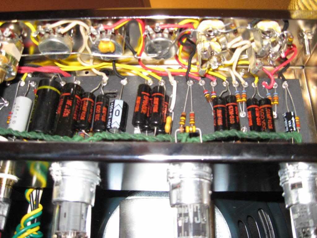

Blackburn wrote:Are those black beauties in there? Whenever I see someone use caps that aren't of the norm I get extra curious...
Clips!
Yes, those are NOS Sprague mylar film and foil caps. I stumbled onto a stash of them, and I wanted to give them a try during this build. I had to parallel a few caps to get the right values. Unfortunately, I have no recording equipment to make clips. I don't know if those caps (or any caps) have any magic mojo, but they have the vintage cool look.
