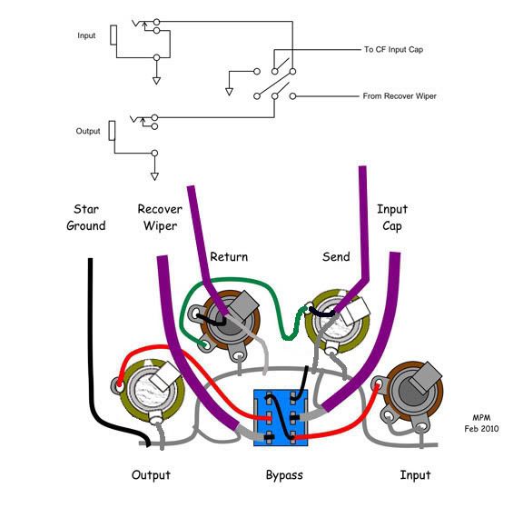

Re: Dlator - a couple of questions on my build
Rog,
Your lead dress isn't too bad but I would make a single star ground at the point between the board and pots.
Bring the ground from the jacks to there.
But, if you are not having any hum issues then don't worry about it.
Also I would try to use the least amount of coax cable you can get by.
If your top end seems muffled it could be that.
The bypass switch doesn't use any shielded cable if you locate it right above the jacks.
Maybe this diagram will help better.
You don't really have to install the switch, it's just a neat mod for the loop.
OK Tom and Angelo, thanks to your combined info, the bypass is in and working!
Tom, I also moved the jack ground as you suggested. All seems relatively quiet. A bit of hiss when the recover out is at 2 o'clock, but this where it sound best at the moment.
Thanks guys, it really is a great addition to be able to A/B between amp and Dlator.
