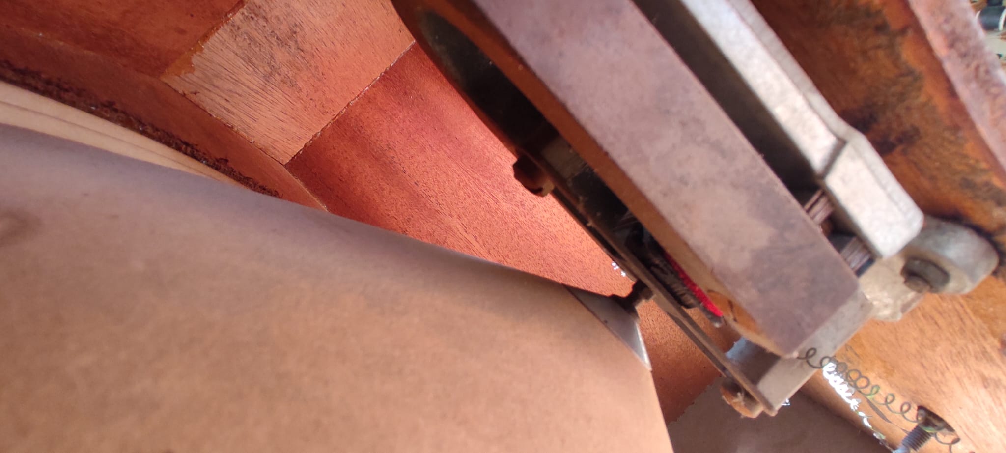

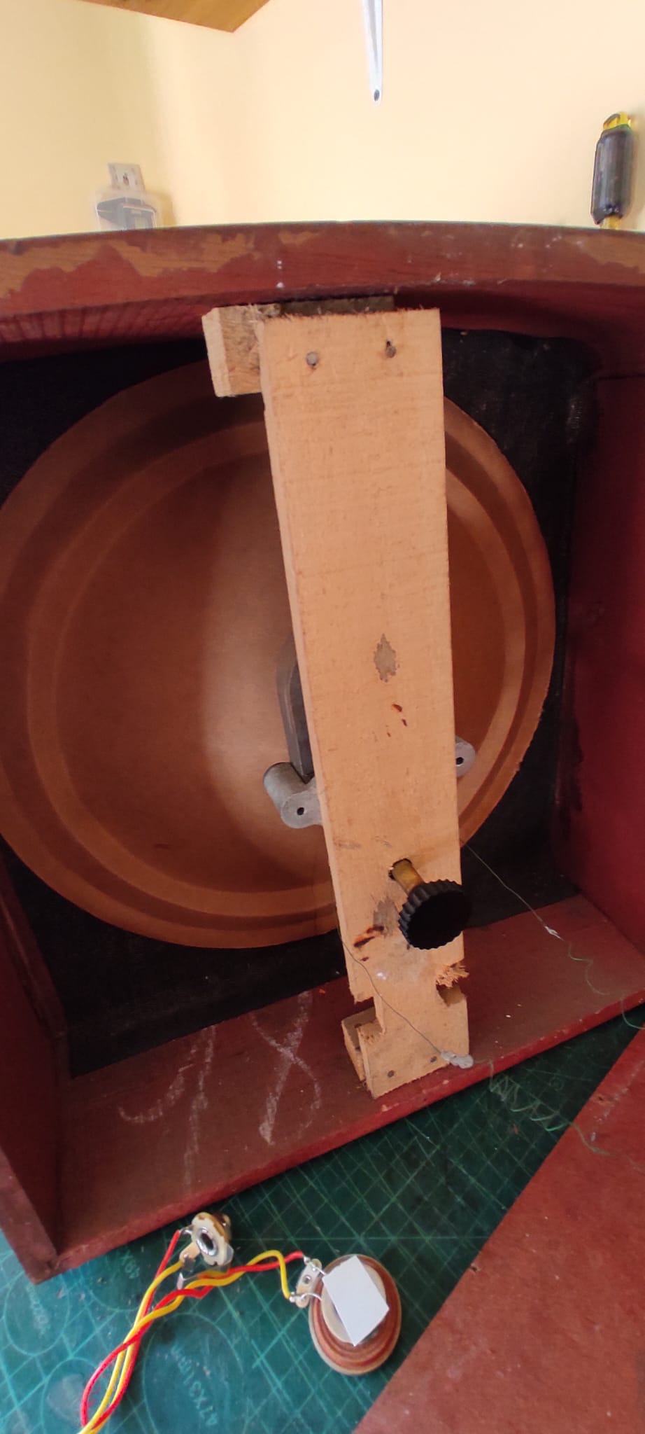

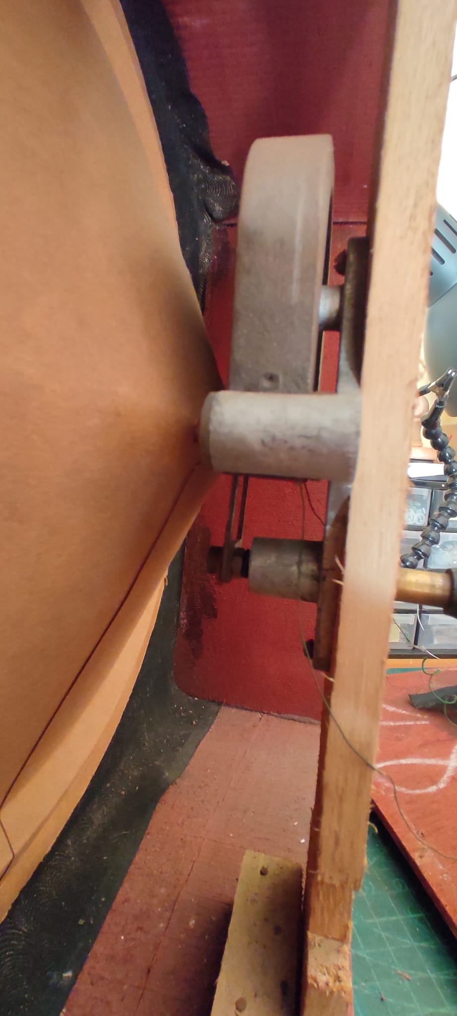

Here are some pictures. I have 3 speakers of this kind and they all have the same type of coil and magnet. The screw in the back acts as a On/off switch I would say. You screw it and it makes contact and you can hear the speaker work.
Sorry for the messy pics, its not easy to shove the cellphone. The back lits are not possible to open except for one.

A photo clearly showing the component that the wires connect to would be beneficial.
Are there definitely only 2 wires from the speaker assembly?
Are any of the components magnetic?
I get the impression that it’s not the standard magnet / polepiece / voicecoil / former / cone design.
Maybe more akin to a cone attached to a solenoid slug assembly.
