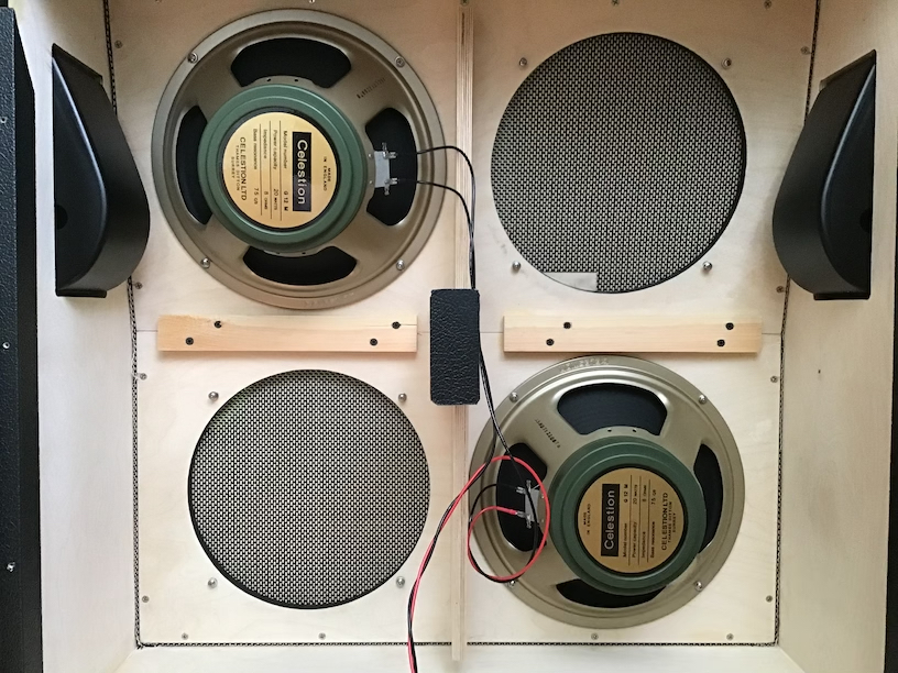

I've actually played the AX84 1x12 design. It was loaded with a Celestion Gold. I found it to disperse well and it was plenty loud. Your question comes at a good time as I've been doing some thinking lately about speaker cabs. I really like the sound of a 4x12 with two of the speakers removed and the remaining two placed diagonally (upper left and lower right). However, I do not like the weight of the 4x12 cabinet. With this setup and an 18W Lite amp, I like two 8R Celestion 20W Heritage run in series for 16R, and tested with a 102 Dumble, a pair of Scumback 16R M75s run parallel for 8R. I have been considering other 1x12 designs such as the Dumble 1x12 ported cab (Larry Carlton style), the widebody Two Rock style with large elliptical port, and Forte 3D side-ported cab. A long while ago, I had some 1x12s I had made (all sold now), one of which I used for many years with an EV as a reference cab. It was incredibly full sounding.

Nothing special, just a Marshall style slant cab.Mark wrote: ↑Mon Aug 03, 2020 11:44 pmI have experienced this where the treble response is dependant upon where you are standing. It is a bit painful.I have been enjoying a detuned 4x12. I like the "air" and wider sound it gives without the beamy, honky sound some fully loaded 4x12s can give.

I’m curious... With the 4x12 loaded with two diagonally arranged speakers, did you also try them loaded horizontally, or vertically?Colossal wrote: ↑Tue Aug 04, 2020 3:32 amNothing special, just a Marshall style slant cab.Mark wrote: ↑Mon Aug 03, 2020 11:44 pmI have experienced this where the treble response is dependant upon where you are standing. It is a bit painful.I have been enjoying a detuned 4x12. I like the "air" and wider sound it gives without the beamy, honky sound some fully loaded 4x12s can give.

Yes, I did actually. I tried two on top, two on bottom, and two vertically. Two diagonally was my preference.

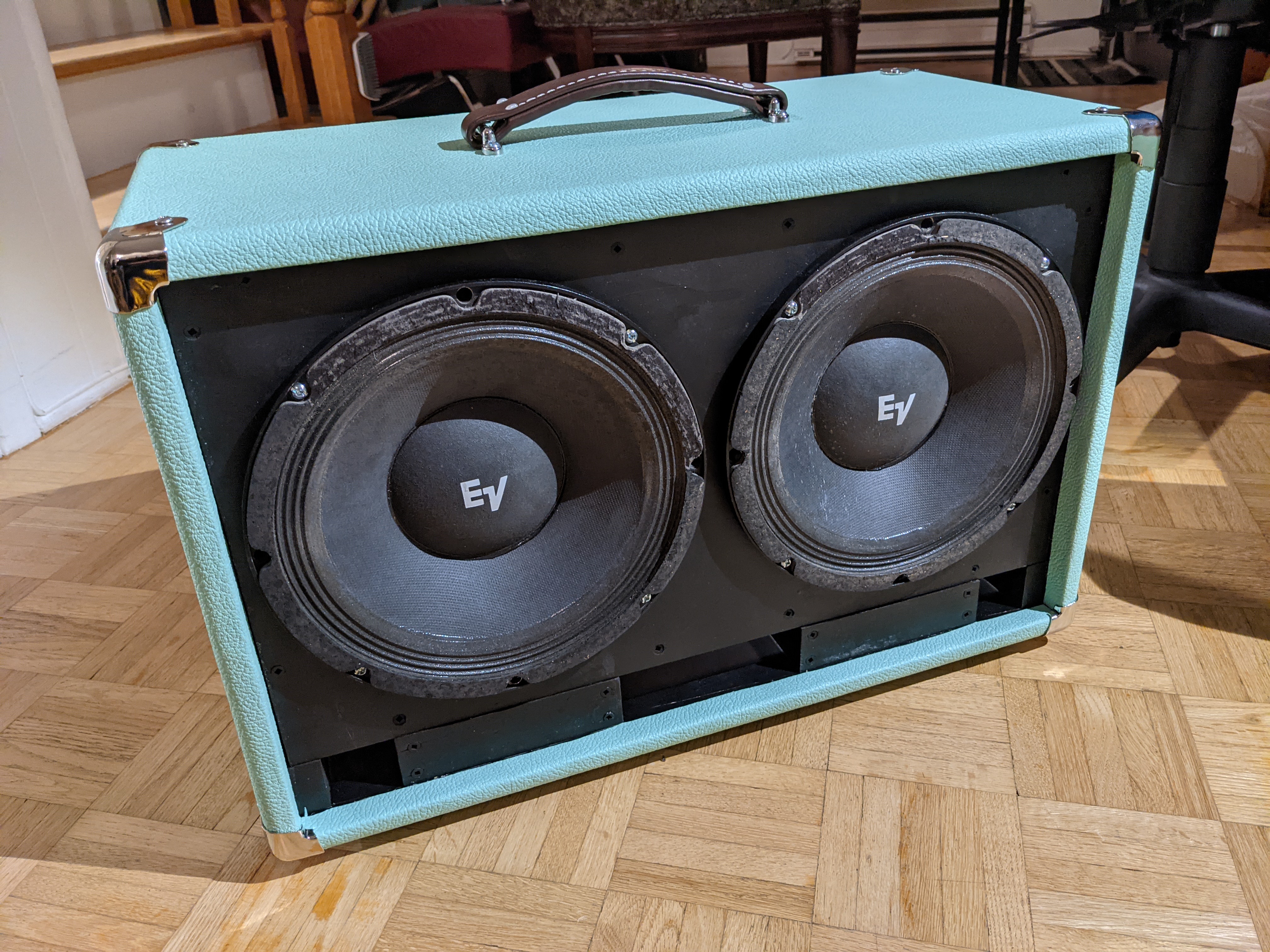

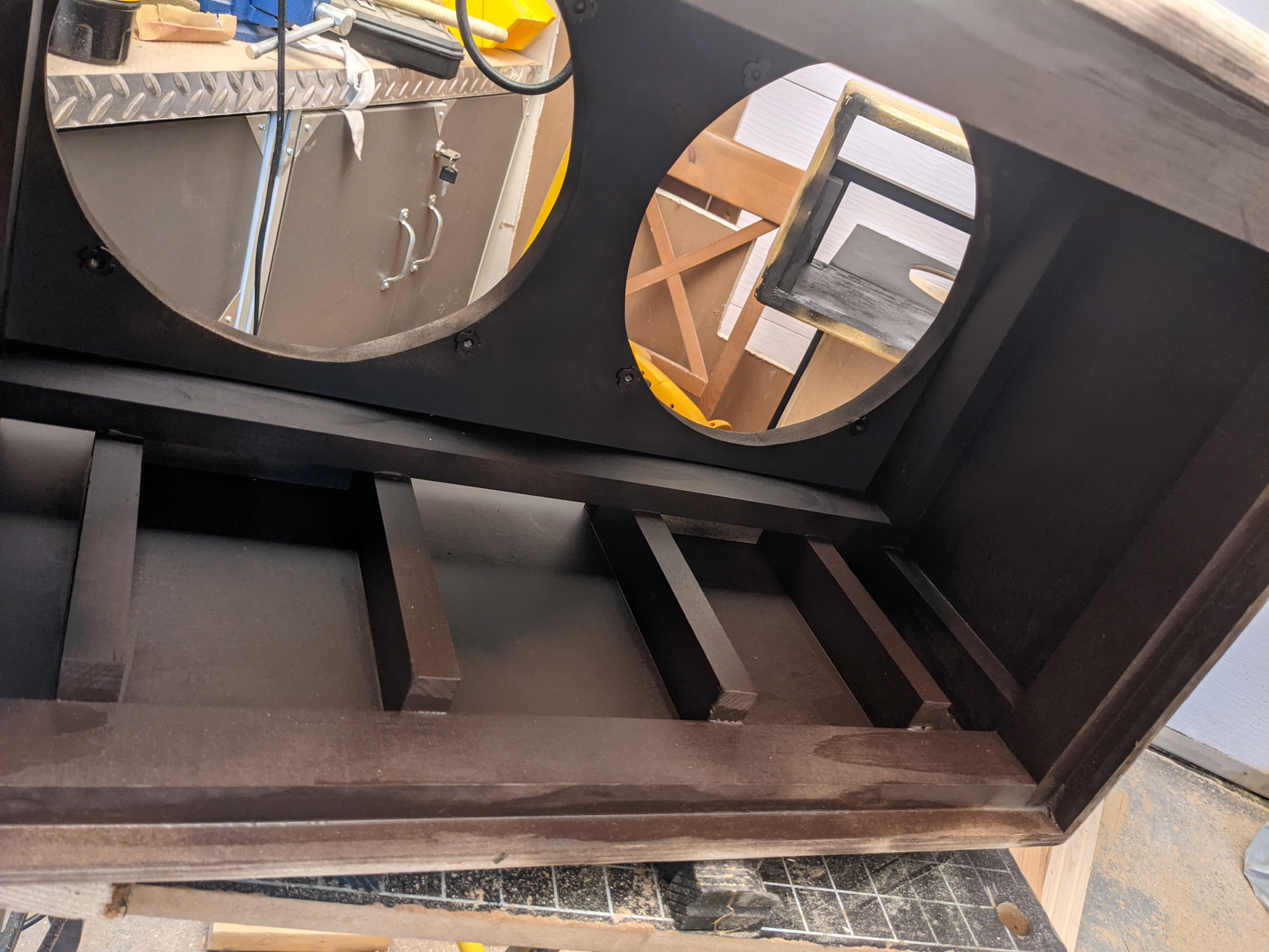

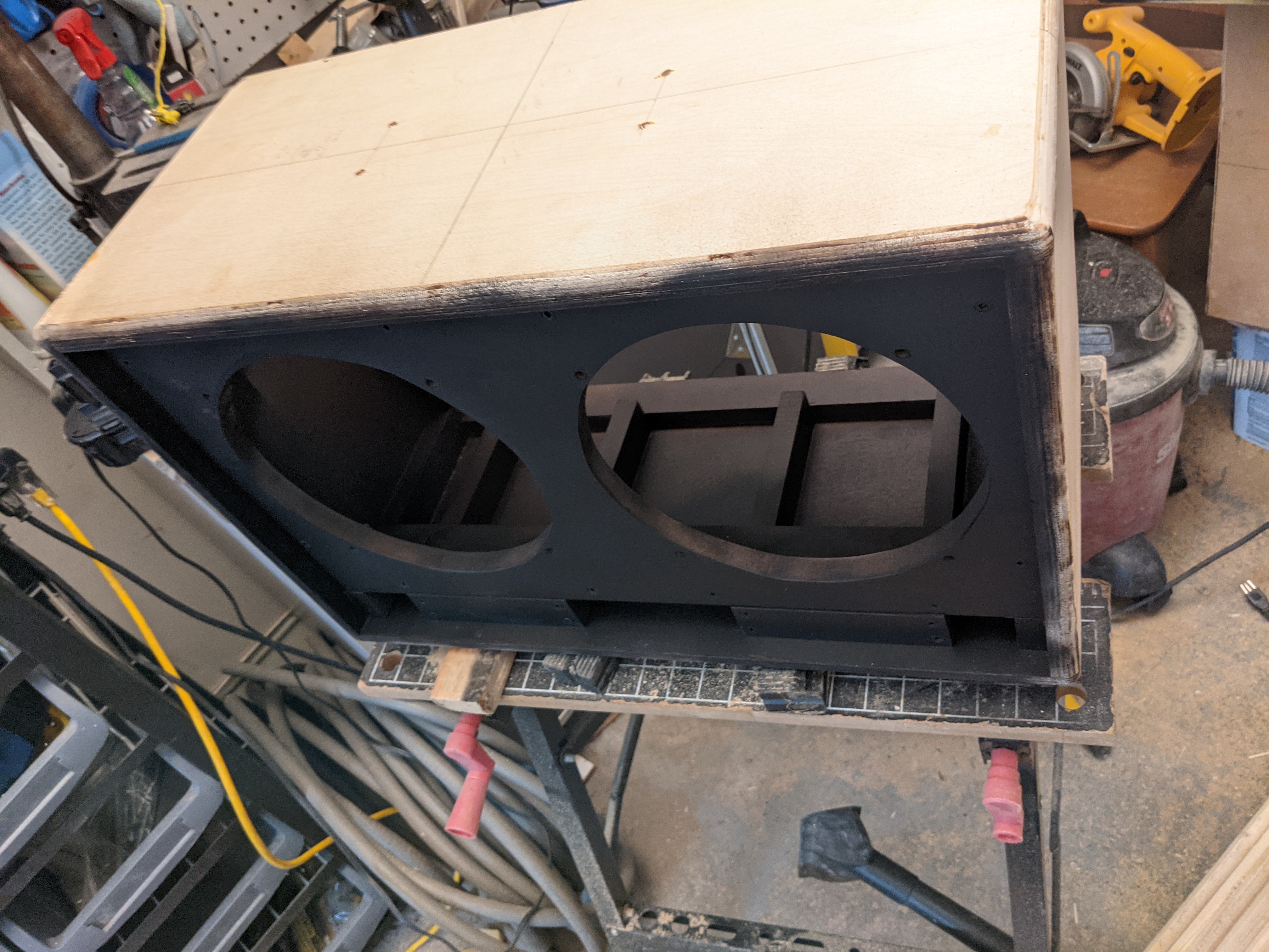

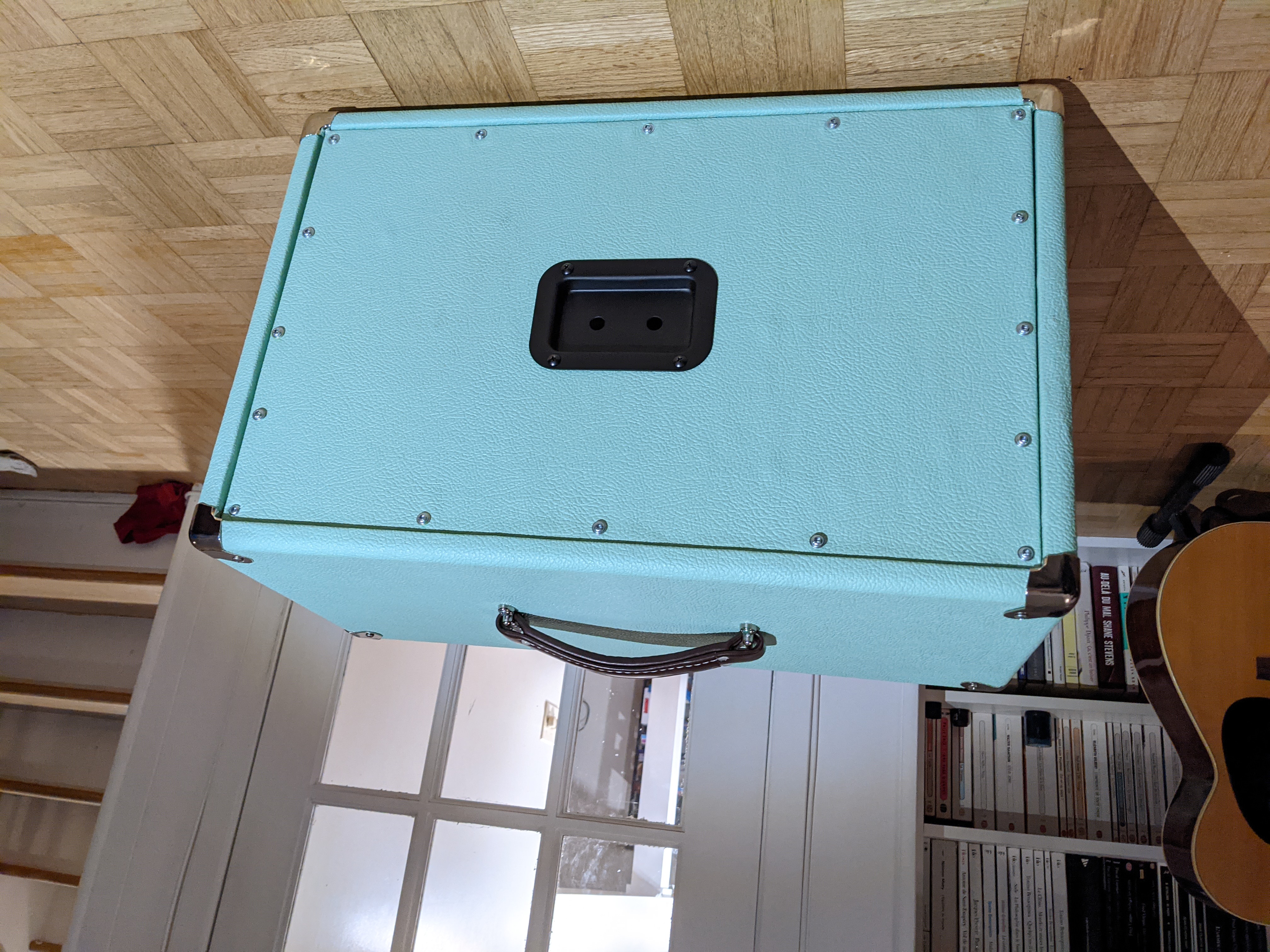

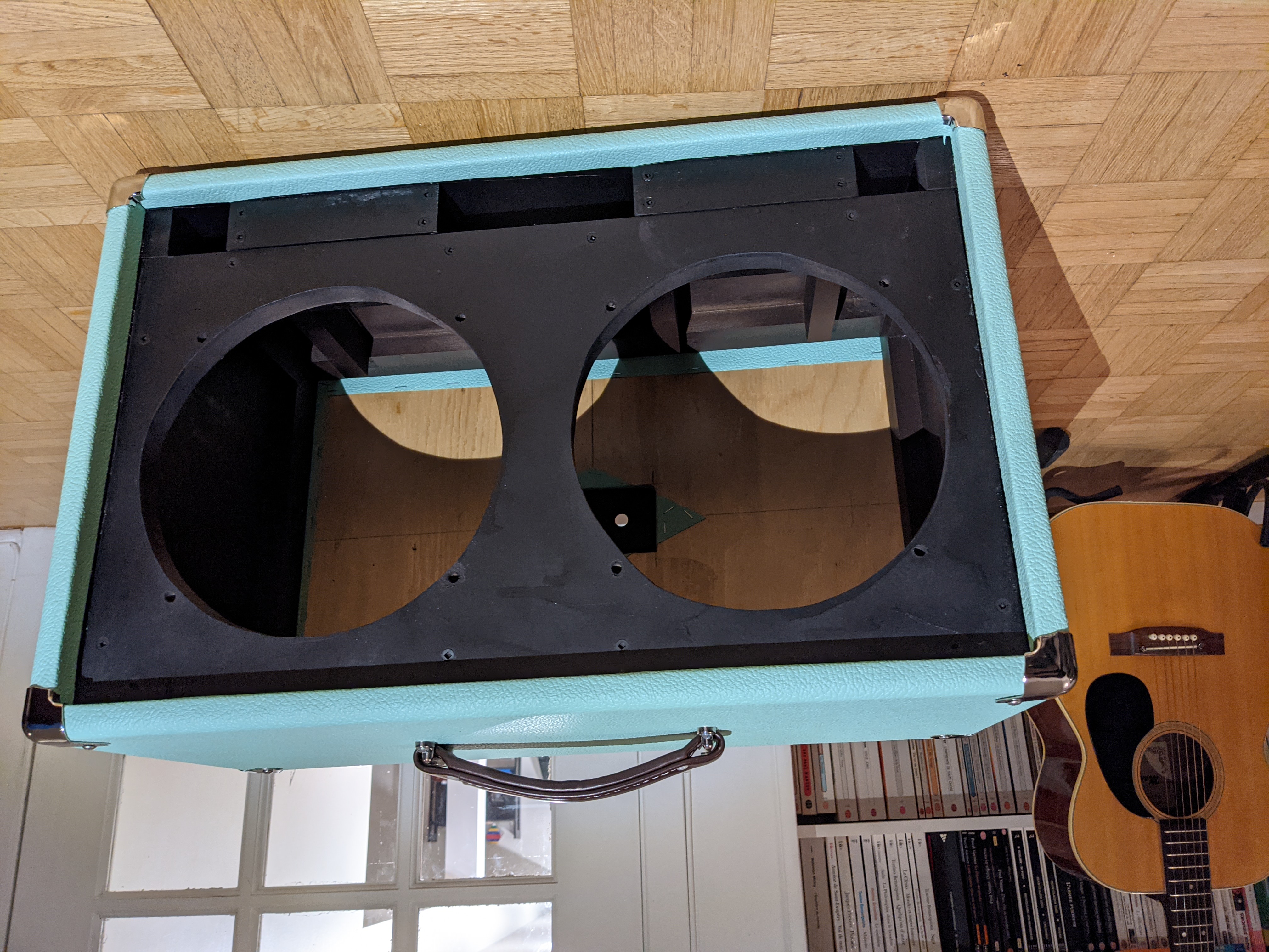

I am a fan of the EV TL cabs, and EVM12 speakers. Back in the day, I took the TL806Q design, and cut it in half, using the cabs for our PA mids with EVM12S speakers. After downsizing the PA, I found that they make great guitar cabs after bringing one to a pedal steel player when he blew his Black Widow 15. I ended up selling/trading both, but built another cab when I started with pedal steel, my wife has also used it for living room jams with her bass!
