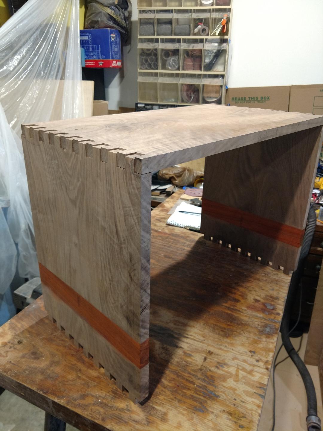

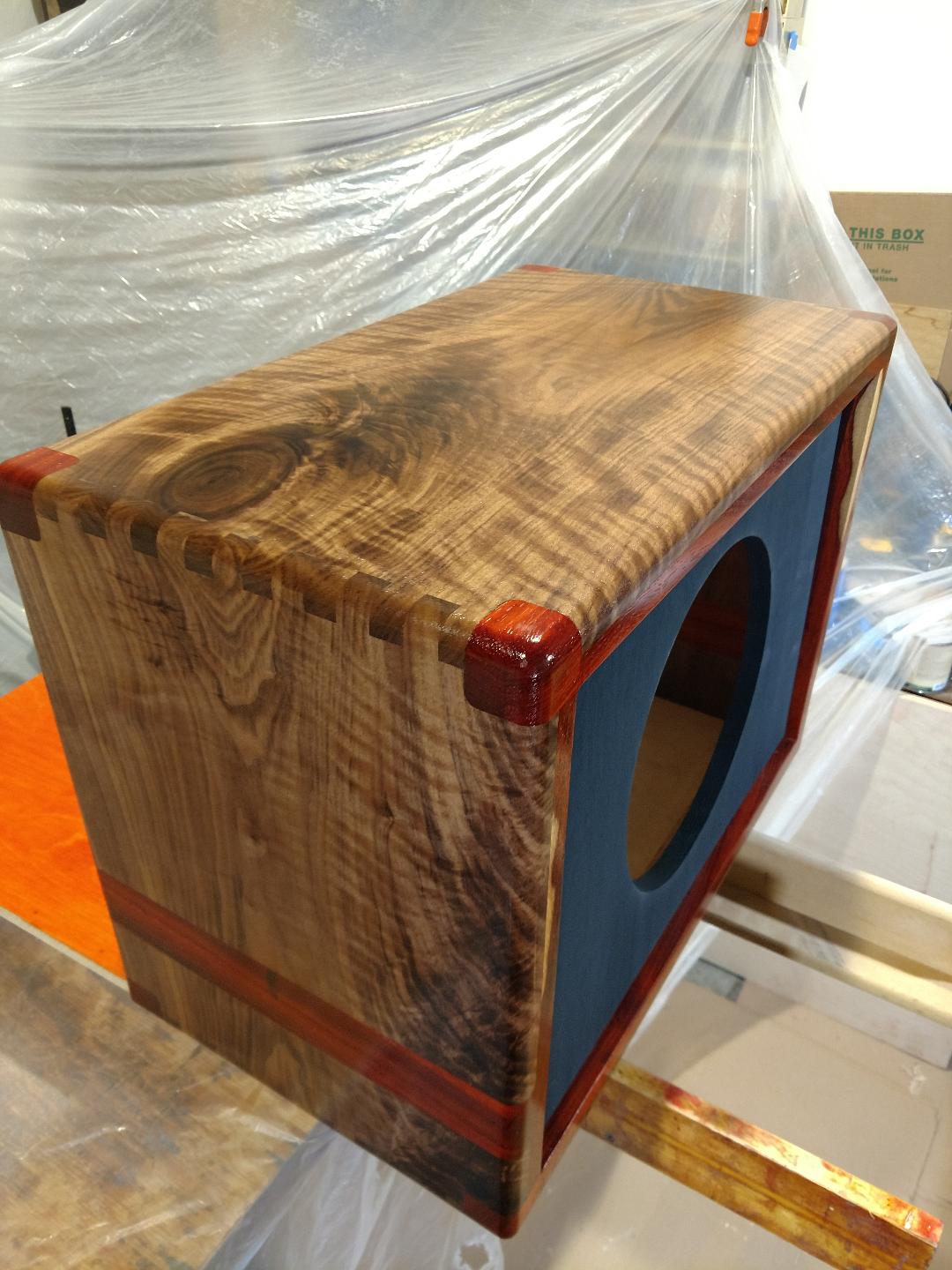

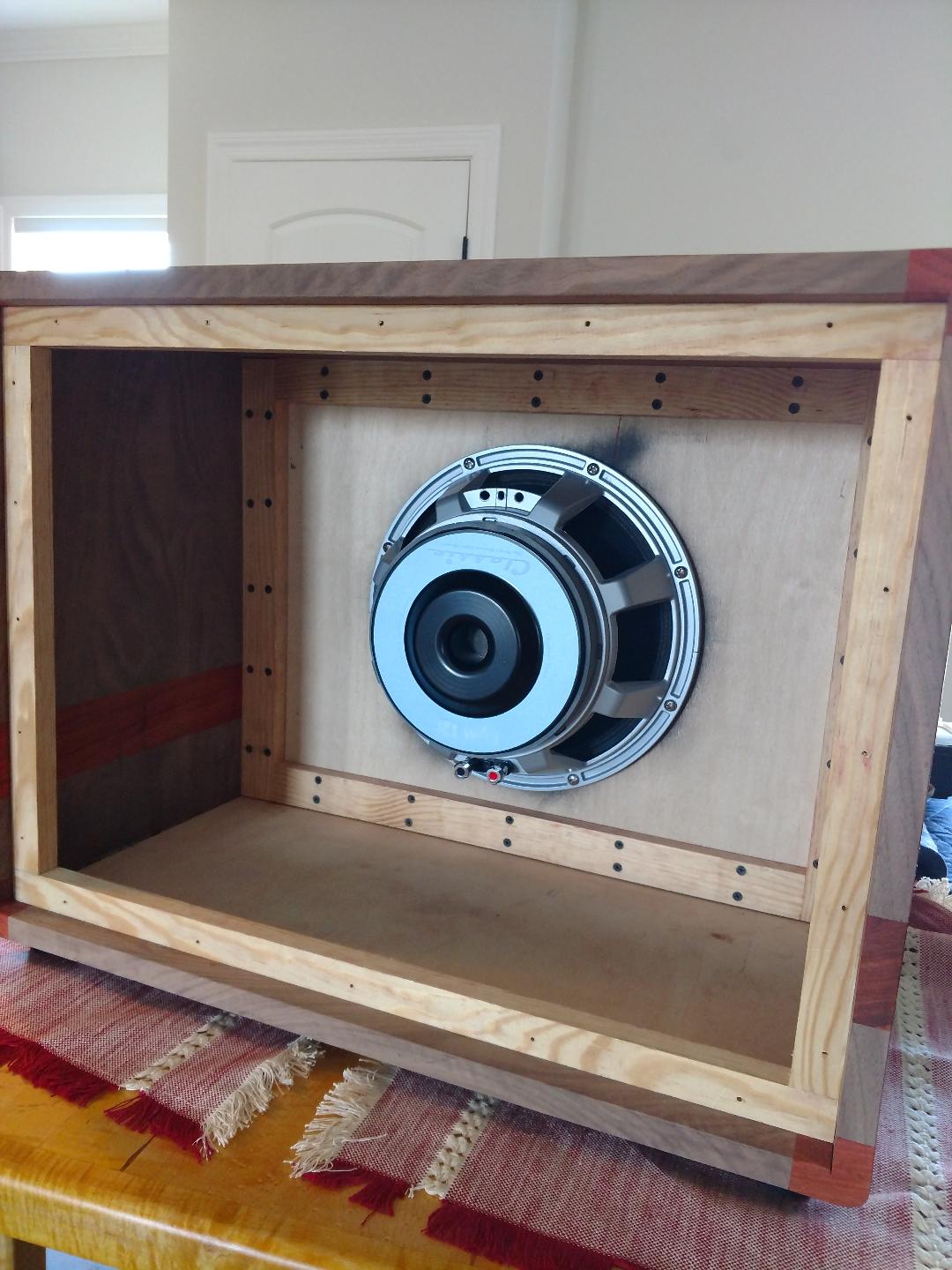

On TGP there was an interesting thread on cab resonance and Zilla cabs was referenced particularly their Fatbaby. I've never been convinced of oversized cabs do anything like the gushing claims I've heard for years so this was a good time to build one. And a 15" wide piece of figured walnut [and padauk for the corner blocks] just managed to follow me home recently.
I had a fubar and had two sets of dimensions for cabs and used the shorter cab for the sides. After power words were used I artfully stuck in a 2" piece of paduak to correct the error.
I decided to round the corners of the blocks for visual interest.

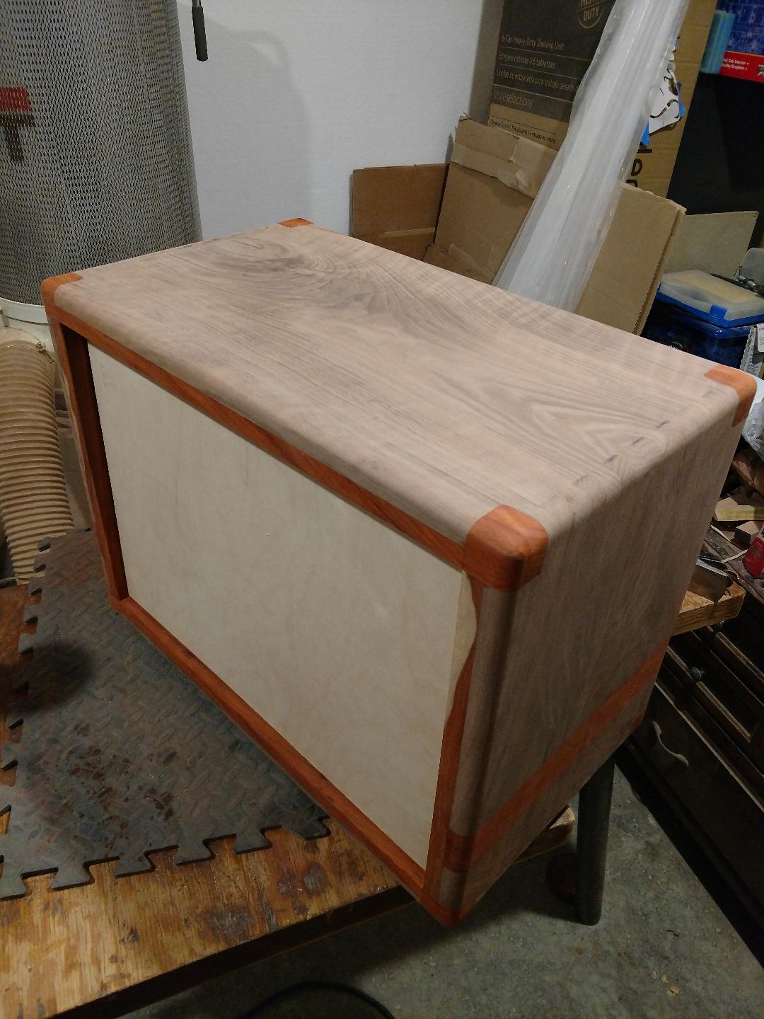

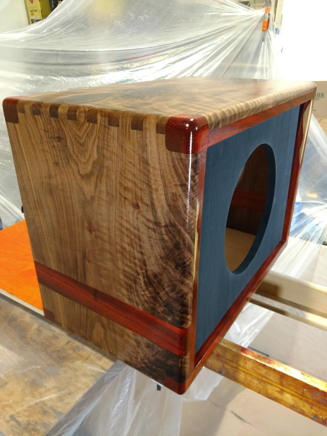

Here it is sanded to 60 grit with the plywood bottom and fake fingers glued up.
Last night I sanded to 220 and sprayed on numerous coats of lacquer.

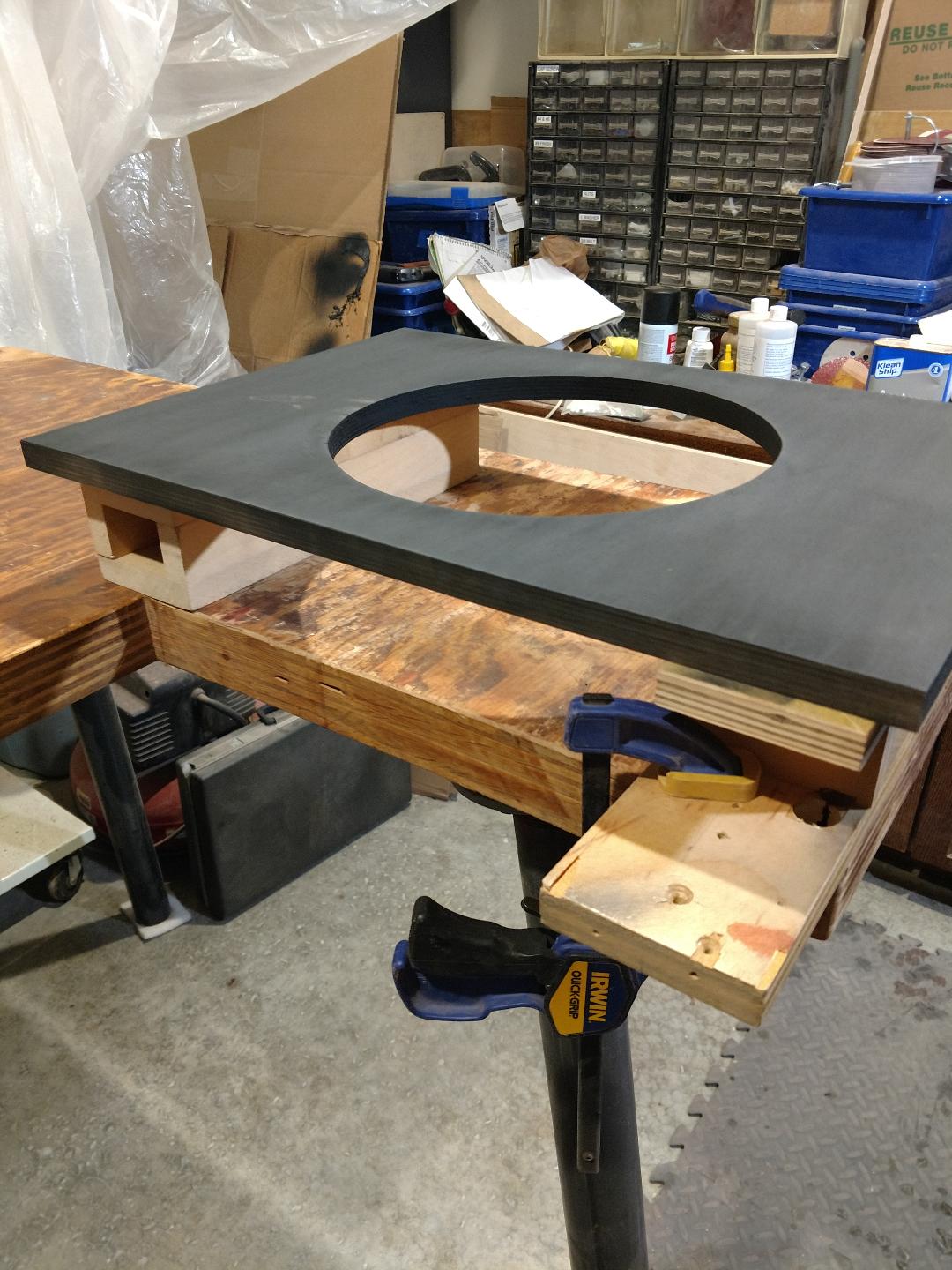

Here is my process and fixtures for grill cloth installation.

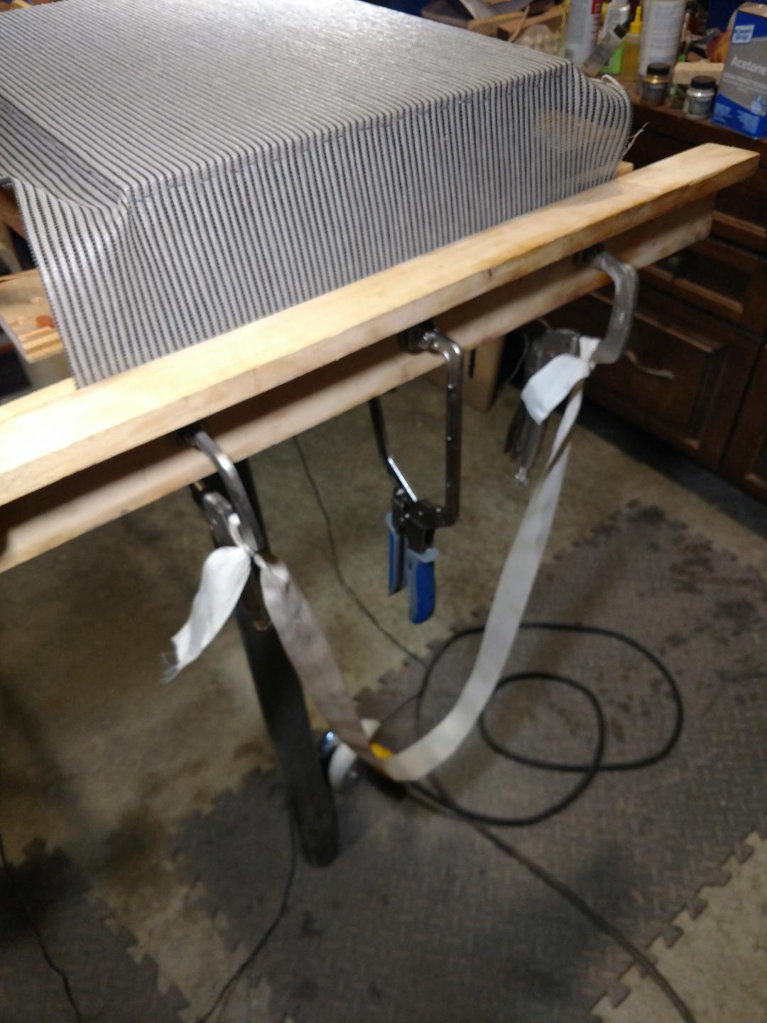

This is the jig I've been using for the last few years. The baffle is held on one edge by a couple of screws and the whole contraption is clamped to my fab table. The other end is supported by a wooden fixture which allows me to clamp the 'loose' side down. A truly necessary bit as I put a bunch of tension on the grill cloth to get it tight.
This is the size 12 'hands free' tensioning device - a woven ribbon tied to the clamps holding an L bracket and a backer clamped to the grill cloth. My size 12 steps on the ribbon and tension is applied. I had to place my 85lb mill vice on the other end of the fab table to keep that end on the ground.

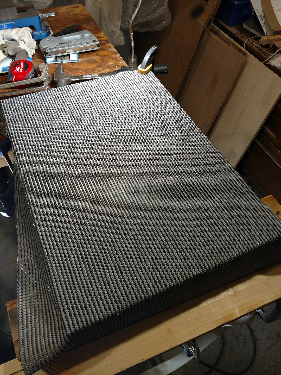

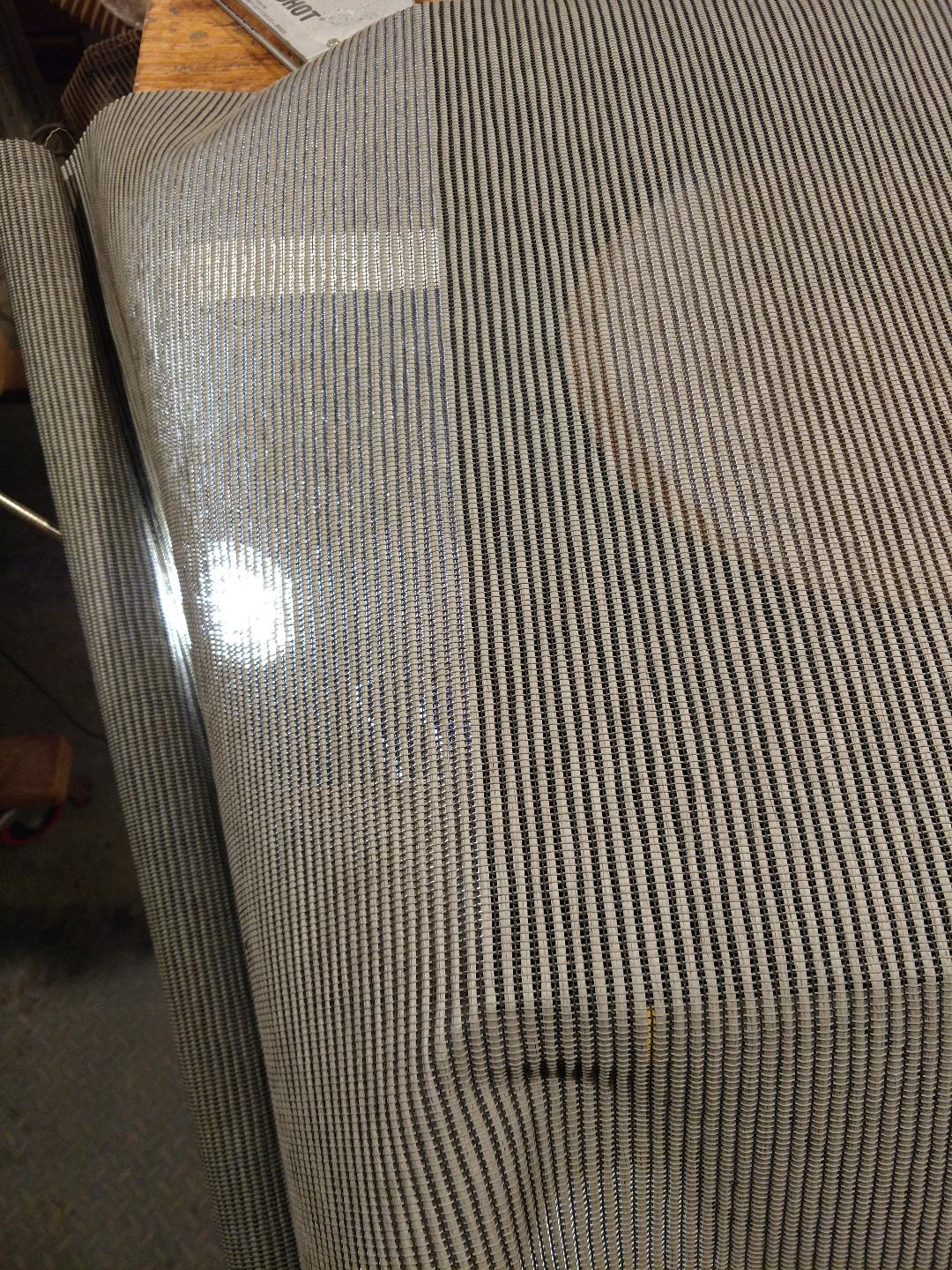

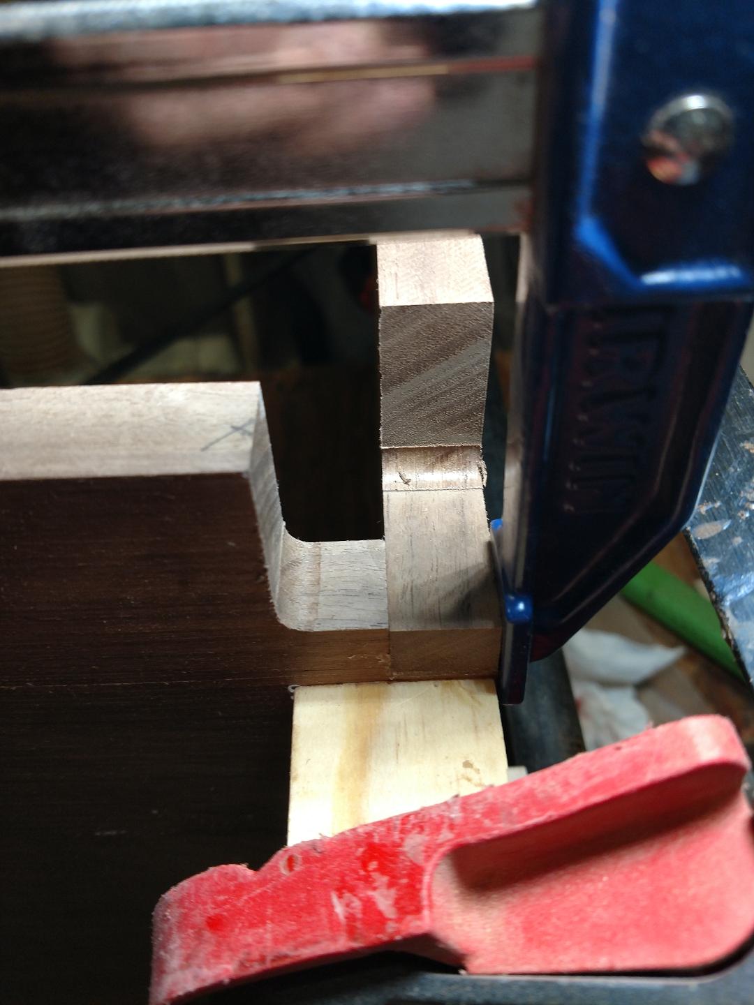

Lights are a critical aid to ensure the grill cloth is straight - or at least what you can live with. The Bluesbreaker cloth's weave I have isn't 90° - horizonal gray stripes to the much smaller vertical black threads. Nor are the gray stripes perfectly straight. I spent some time positioning to best visual appearance.
Then I clamp down the loose end and start stapling on that edge then apply the size 12 tensioning device after checking, double checking, triple checking that the offside edges are still aligned. Don't be parsimonious with the staples either. I use 1/4" on BB ply as the 3/8" tend to stand too tall.

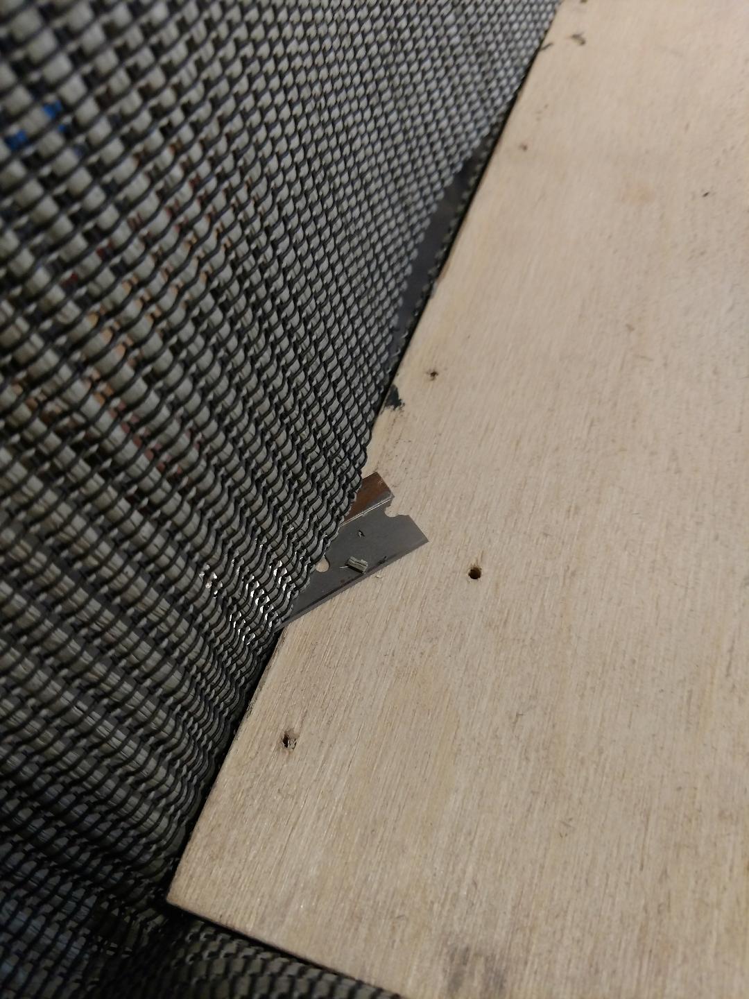

I use a razor to trim the excess off. Then 'seat' the staples with a hammer.

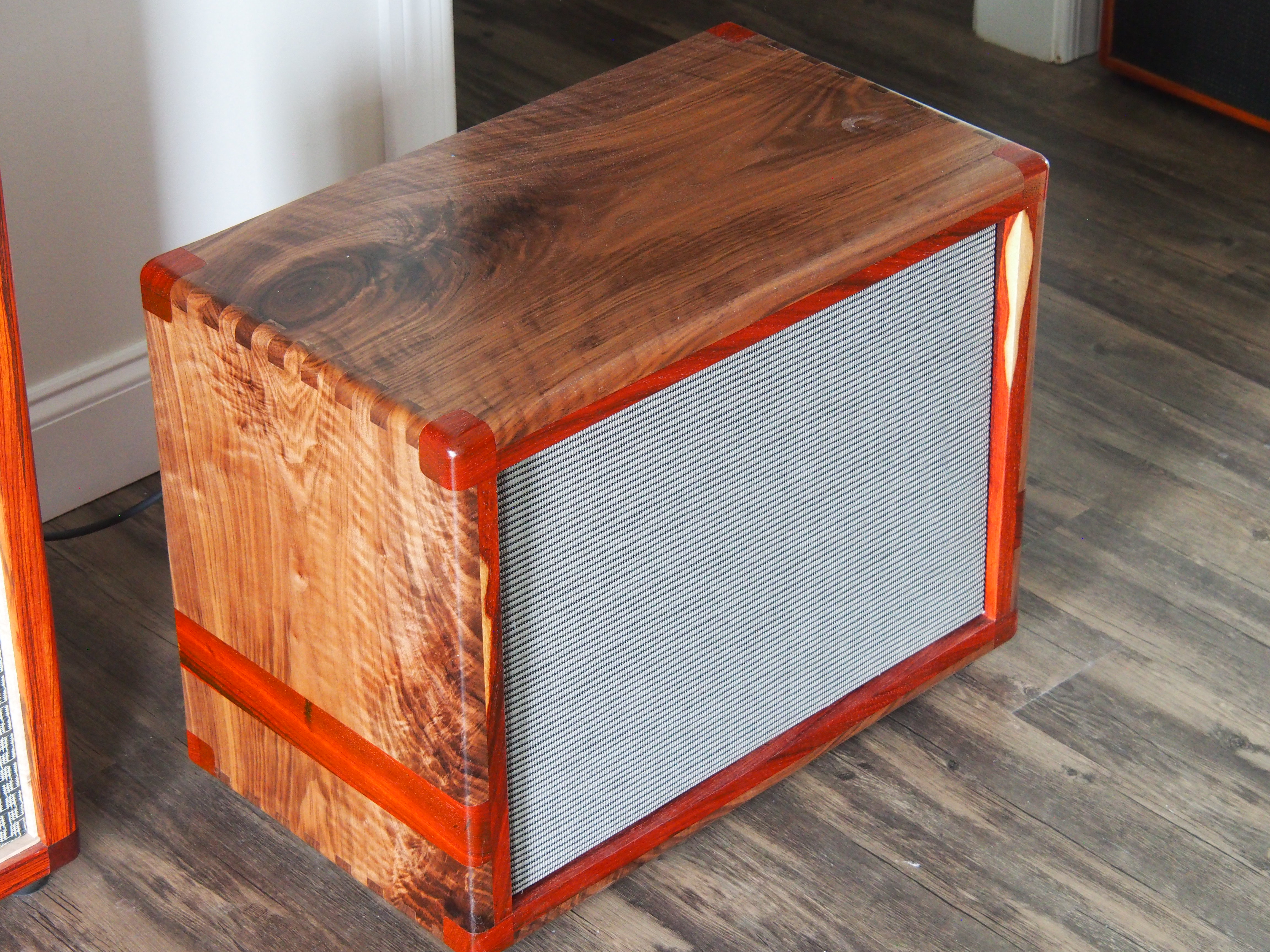

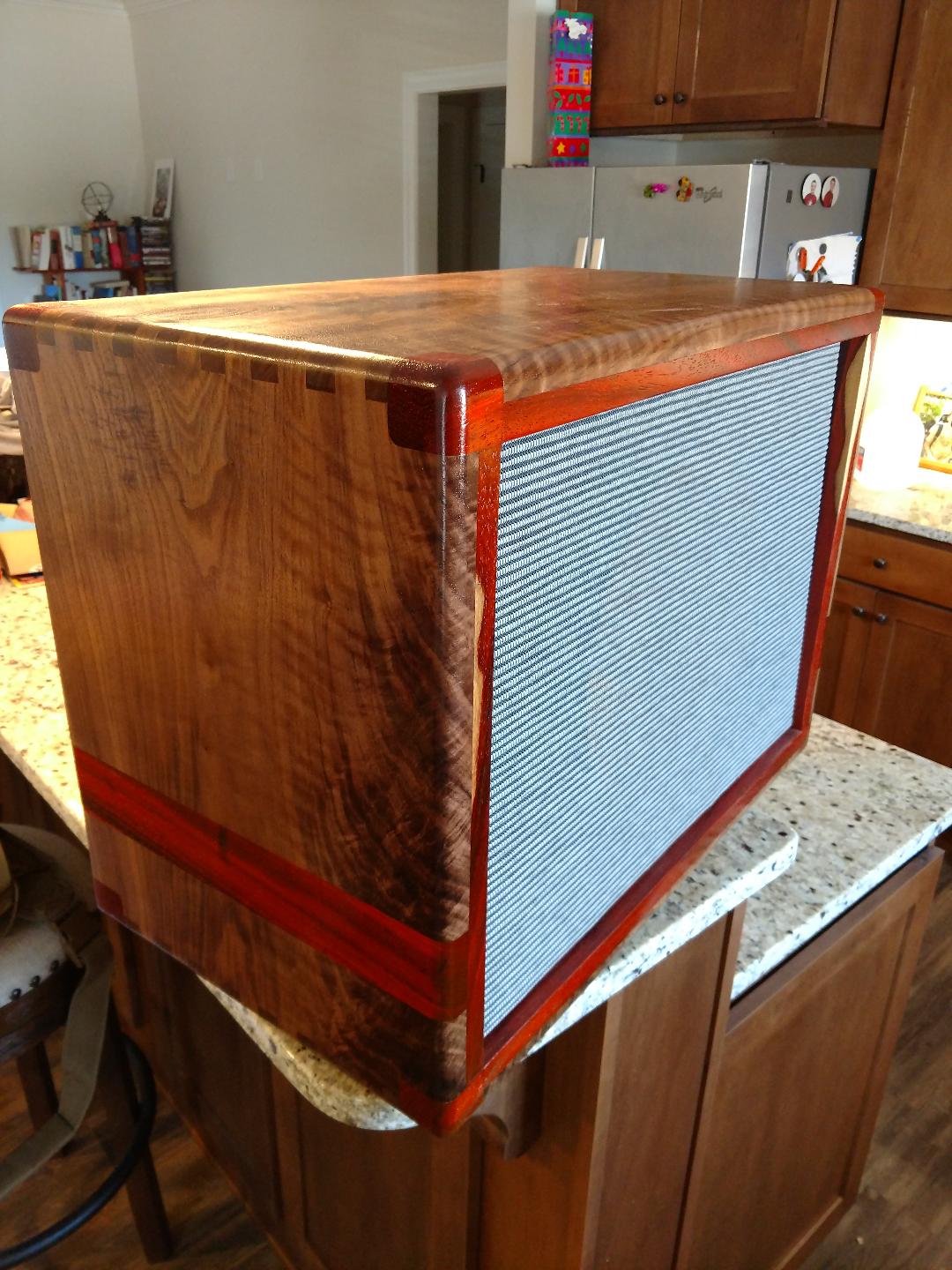

Fattbaby is done - save for the handle.

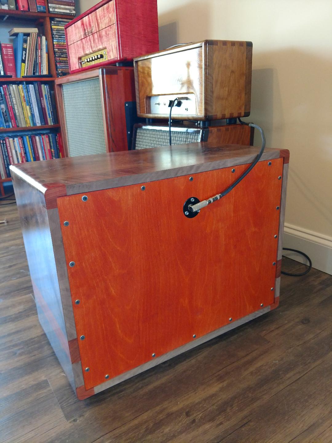

Here is the back dyed orange.

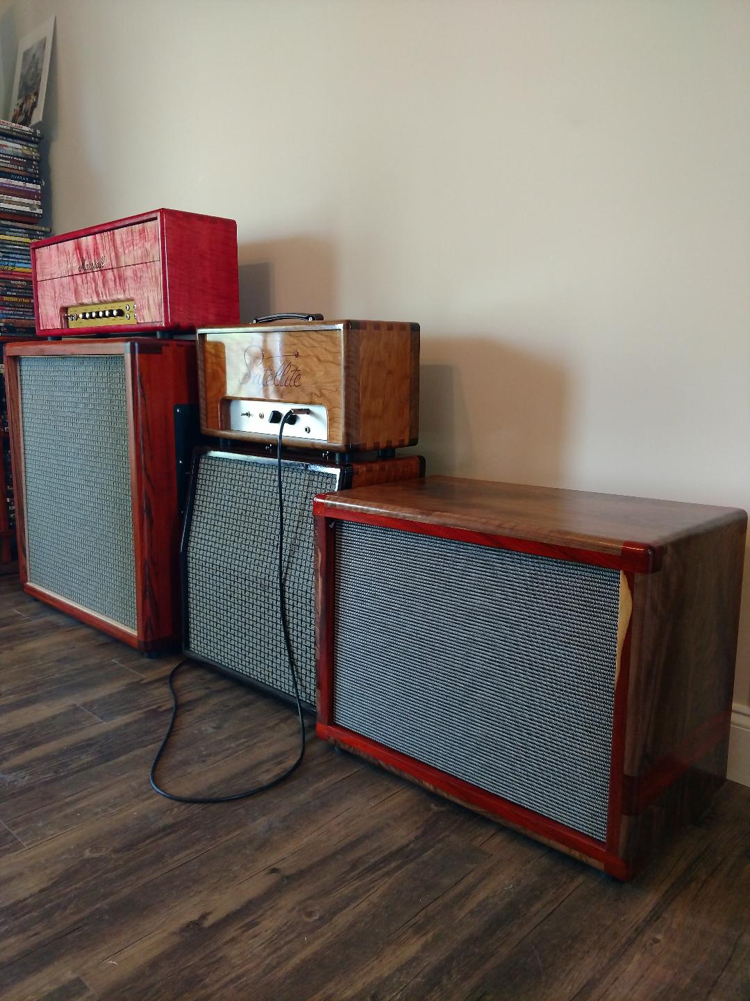

After building several TL806 cabs that the EVM12L just dominates I smile when I see this pic of much less domination.
I'm looking for a location to do some volume testing in central Tennessee. I certainly miss the 18K sqft facility I had in Dallas.

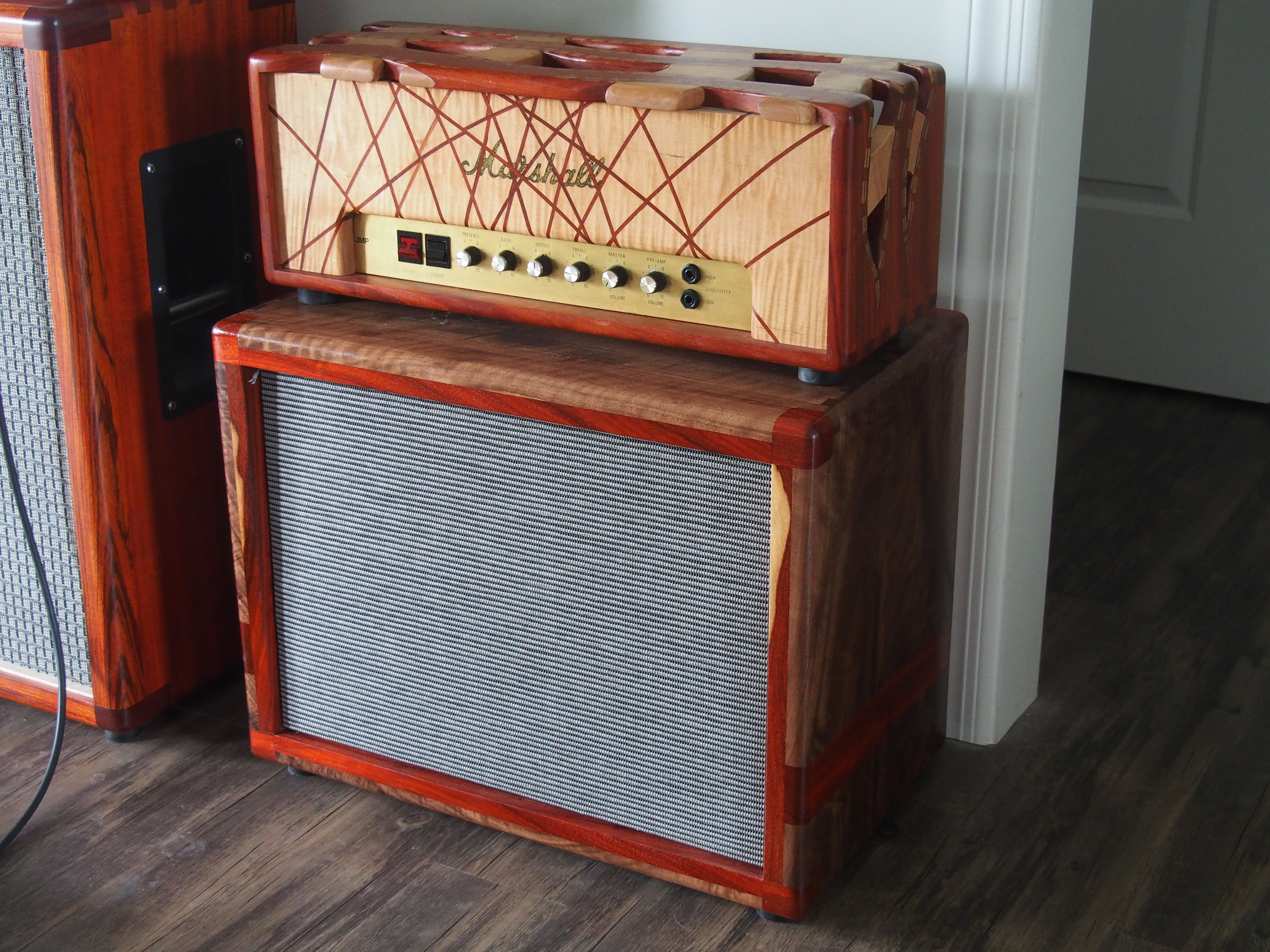

New camera day.
One of the reasons I chose this sized cab was to fit small box [Marshall, that is...] cabs since I have one and some smaller.
