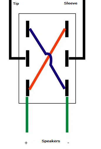

Colossal wrote: Fri Jan 17, 2020 4:17 pm I use a phase reversal switch on my cabs and/or amps
Like this? Where do you usually install the switch? on the back of the cab next to the input jack?

Bombacaototal wrote: Fri Jan 17, 2020 4:35 pm
Hi Raphael,
Yes, that is how I wire the switch. On cabinets, yes, I install the switch next to the input jack. It works great and if you get the phase match wrong, just click the switch. The sonic difference between an amp that is in and out of phase with its speaker is VERY obvious.
Paul and Pete, I am referring to the relationship between an amp and the cabinet it is attached to. If you miswire a multi-speaker cab, that is a separate problem.
FWIW, note that Matchless includes(ed) a phase reversal switch on their amps. I've been doing this for years.
Best,
Dave
