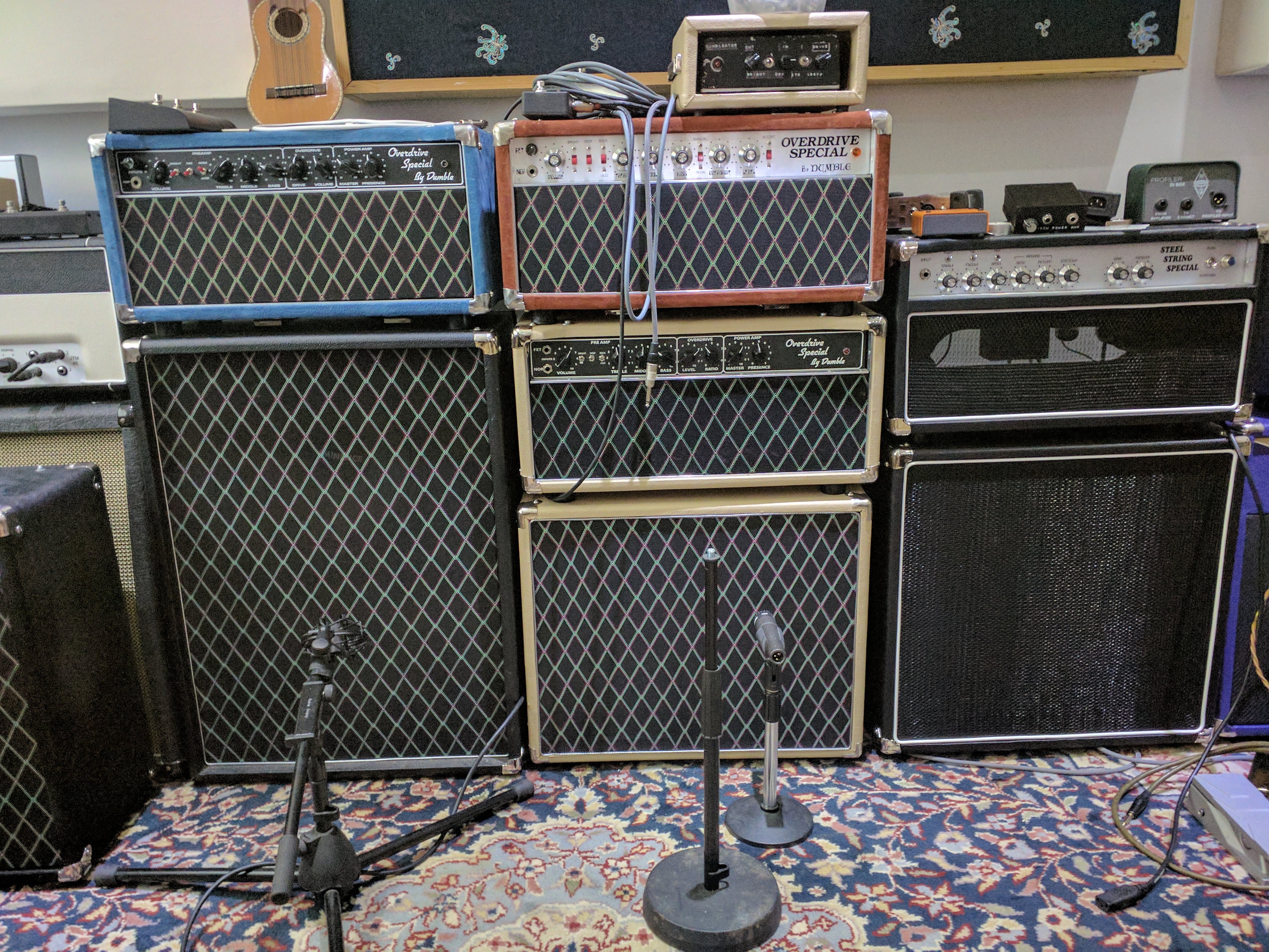

All three of these cabs and all 4 amps are 530mm wide within a few mm.

This is starting to clear a lot of it up, and is very informative! I think the stack in the middle of the image is close to what I'm after in terms of design. It definitely looks more "correct" to me when the dimensions match like that.
It looks like the hand-drawn cab plans mentioned earlier in the thread may not have much bearing on what I'm trying to do, but that doesn't diminish their historical value and significance! If I followed those plans I think the cab would actually be a touch smaller than the head.

the 1x12 in the middle is a sealed ported 'Larry Carlton' cab with an EVM12. here's the build thread https://ampgarage.com/forum/viewtopic.php?t=30229
The cab next to it is a 1x12 Celestion oval backed cab based on the 1x12 Dumble cab dimensions.
the first cab is the classic Robben ford Dumble oval back 2x12 with a pair of vintage Celestion G12-65's
