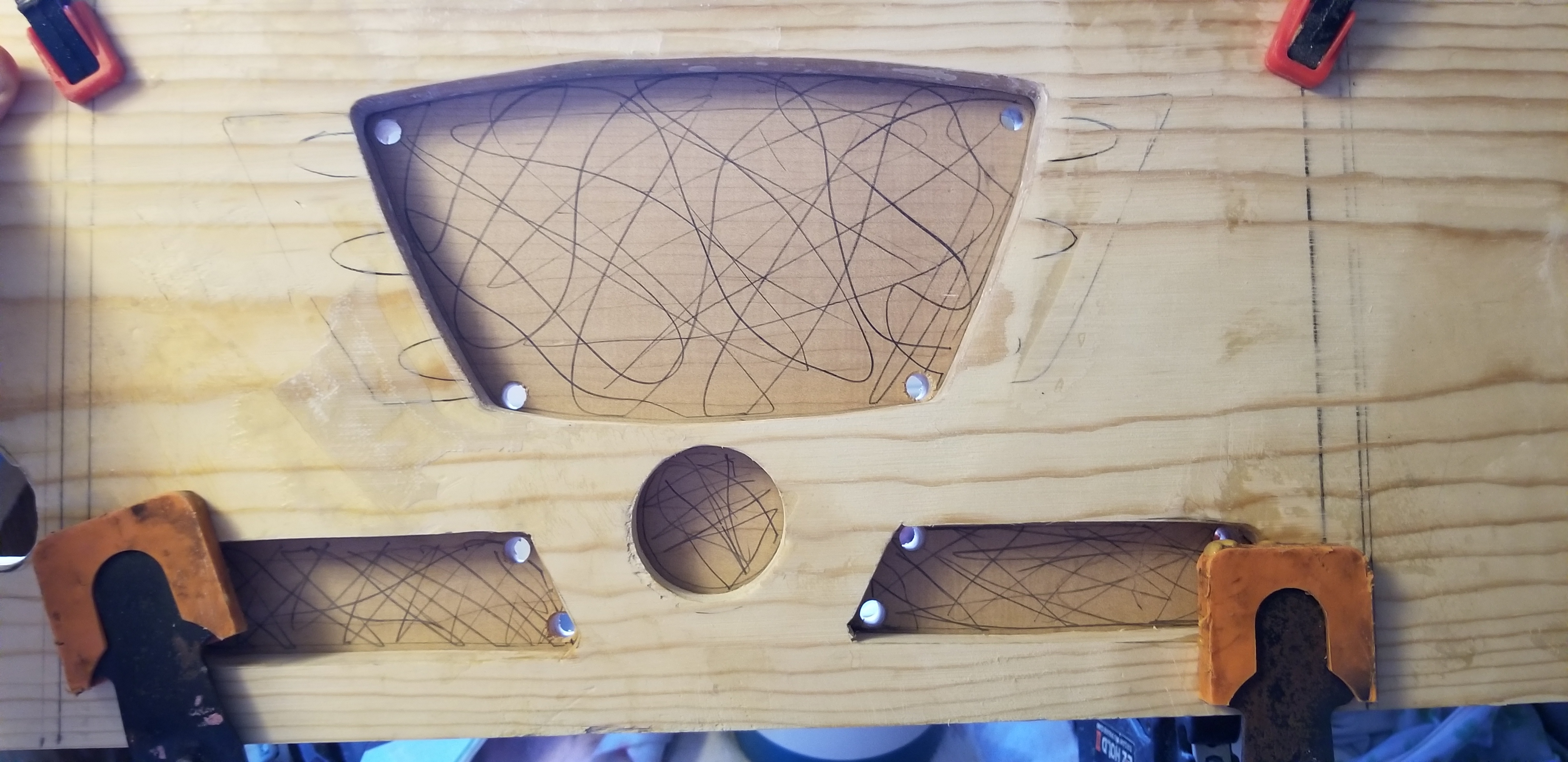

I am routing a figured maple plate for the face of an amp. The maple is 1" thick. I need to rout several holes and heard maple is trouble. Chipping and tearout can be mitigated with a spiral bit. The up spiral and down spiral bits can be hard to control (hand held, no table) so i thought the compression bit might be safer and cut cleaner. I'll practice on junk wood, and do multiple passes as it's so thick.
Here is the template on the maple.

If you're using a hand held router you can carefully climb cut the pattern using a conventional bit. Make shallow passes. The more figured the wood, the more shallow the cuts need to be. You might take one glancing pass in the normal direction for cleanup, but there's still risk of tearout with highly figured maple even if it seems like you're just removing some hair, so you might want to climb cut as close as you can and finish with sandpaper.
That almost always works for me.

Almost. I hear ya. Conservative approach all around seems to be the best course, shallow passes included, unless i find the new bit works laser like on scrap from the same board. Thanx

if you aren't already. I would start with a fostener bit in a drill press and remove as much material as i could then switch over to a router and clean it up in one pass.

Great idea Cbass, that will help i'm sure. If the scrap tests don't go well i might abandon the router and proceed with chisels, files and abrasives after the forstner bits, thanks.

Don't intend to. After cutting the waste board end, i'll either route it in one pass, or more likely forstner bit-file-sand.
