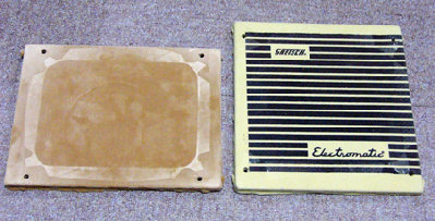

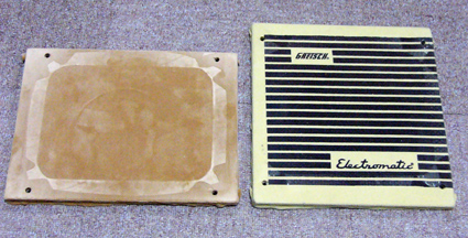

I found a picture which shows the different baffle board sizes. Just out of interest did you use the 8" speaker because you had one or did you decide against using another 6" speaker?
