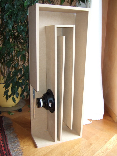

The BW Nautilus is not a transmission line, rather a socalled terminated line, where the back energy is terminated acoustically resistive,- converted to heat, not reflected or put out in the open as in a TL.

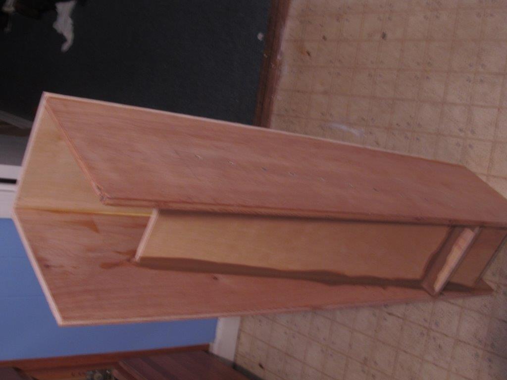

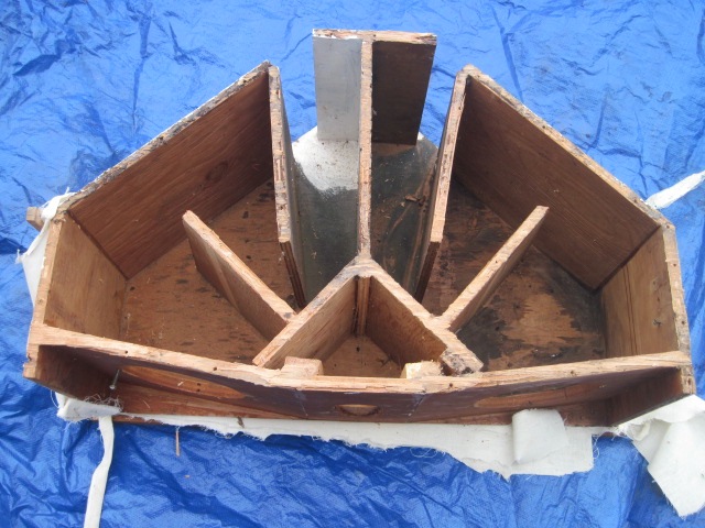

Back in the day, I had a friend who was playing with transmission line designs, and I got the idea to build one for my truck. I've forgotten the actual lengths I used of 4" PVC filled with dampening material, (my friend was in on the design). I used some decent quality 6 x 9 3 way speakers in a box that was sealed to the PVC array that filled the space behind the seat. (Had to be at least 8' of pipe for each driver).
Really a wild looking system, and had fairly decent bass response for the drivers I used!

Ah! Wondered what happened at the end of the giant cochlea and those stacked vuvuzelas.Aurora wrote:The BW Nautilus is not a transmission line, rather a socalled terminated line, where the back energy is terminated acoustically resistive,- converted to heat, not reflected or put out in the open as in a TL.

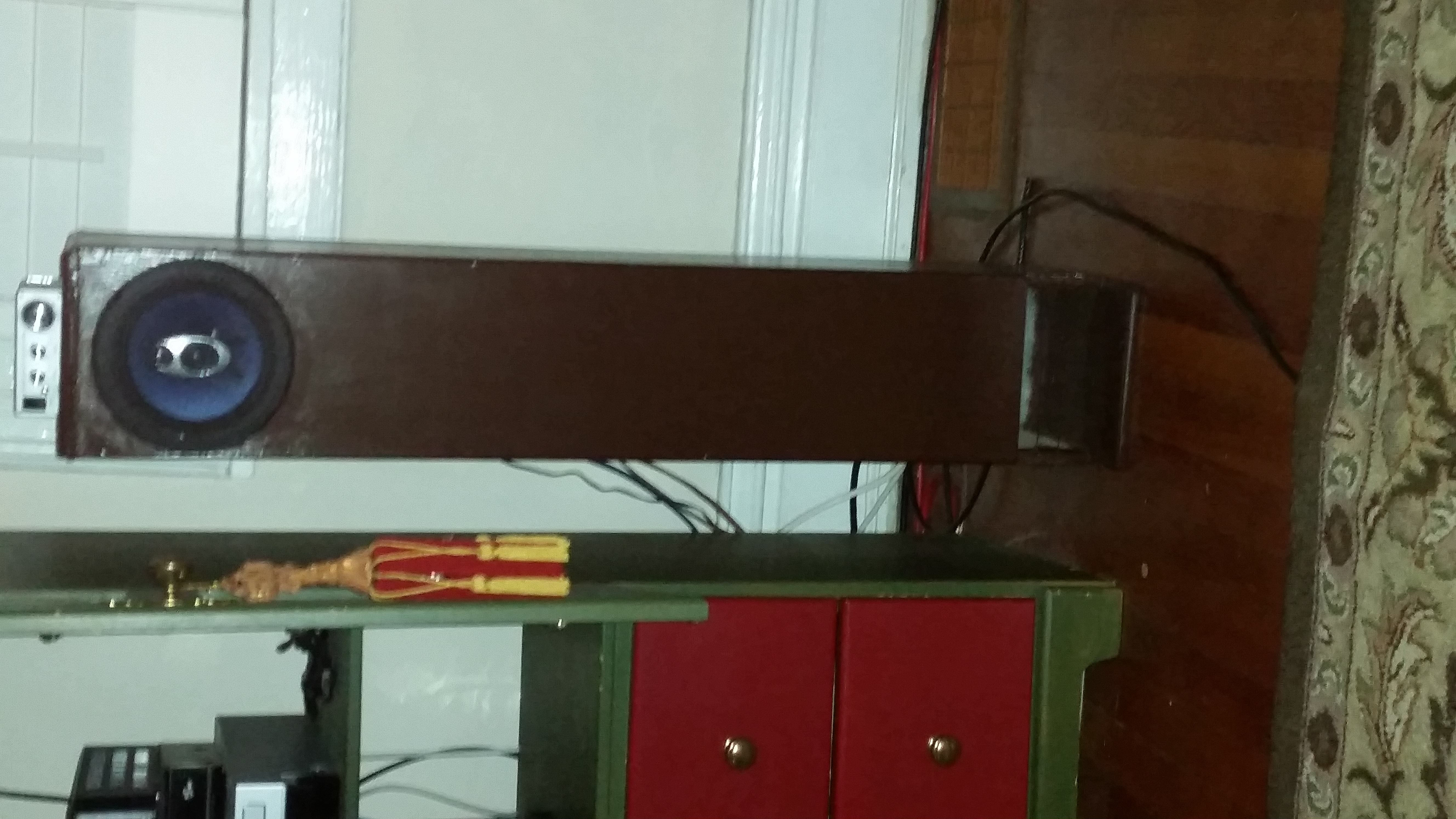

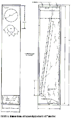

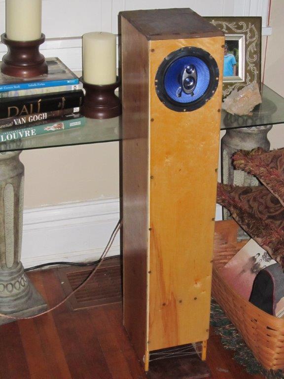

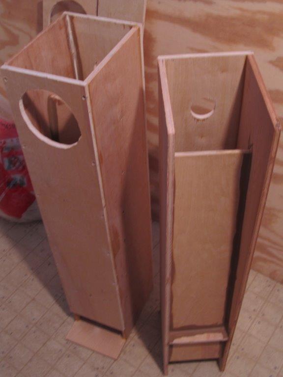

I built a pair for my fiance last Christmas. They are a simple design using cheap 5 1/4" pyle car speakers, driven with a $20 class T amplifier. Originally it was to replace the crappy 1" speakers in her TV. She has a hard time hearing, and I thought it would be more intelligible with a wider freq range. That way she wouldn't have to have the volume so high. As it turned out, the sound was phenomenal! Listening to concerts on cable was stunning. I plugged in my Ipod and was blown away. Dynamic, full rich lows rivaled my expensive stereo system. 20 bucks in speakers, a sheet of plywood, glue, screws, some dacron and magic.
