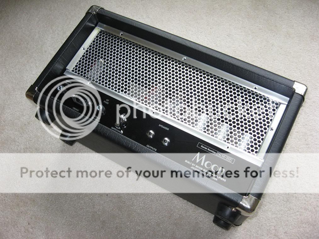

I haven't had any shrinkage or pull-back, and I've been doing it the same way for more than 10 years. I tried making a Marshall head, with the neatly cut corners and such, and realized I'd better find something simpler

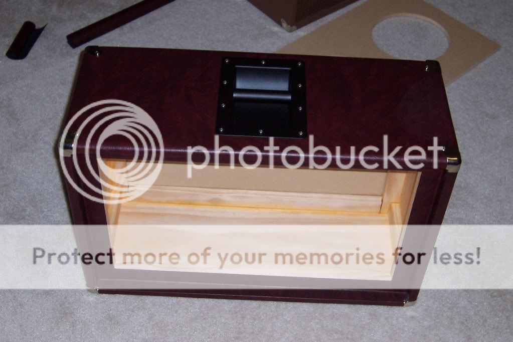

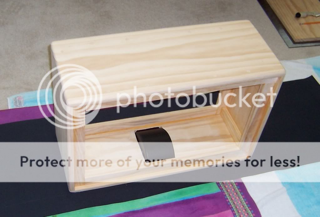

I wish I had better pics, but I use one long piece of tolex that covers 3 sides plus 1-1/2" on each side of the bottom.
[img
694]http://i514.photobucket.com/albums/t346 ... tPine2.jpg[/img]
I glue that on just the flat parts and let it dry for a day. The next day I cut and glue the little flaps that wrap around the sides, ending at the 1x2 cleats. (this pic includes the bottom piece of tolex, but it shows how far I like to wrap it around.

The second piece of tolex is just a straight piece cut to the width betwwen the inside edges of the cab. This will result in a 3/4"overlap, 3/4 of an inch from each edge.
The corners hide any imperfections, and the feet are bolted through both layers of tolex, also helping to hold it in place.
