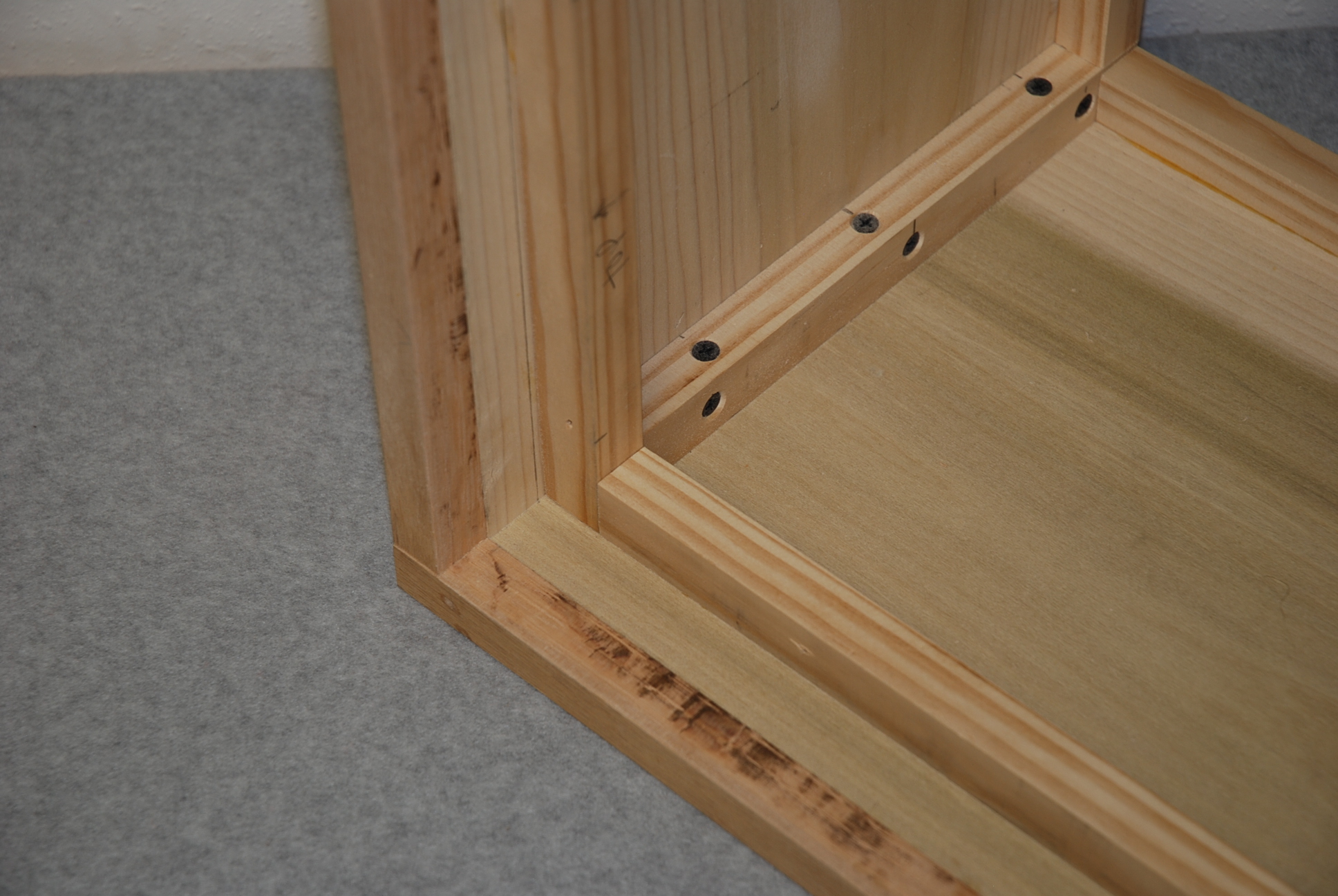

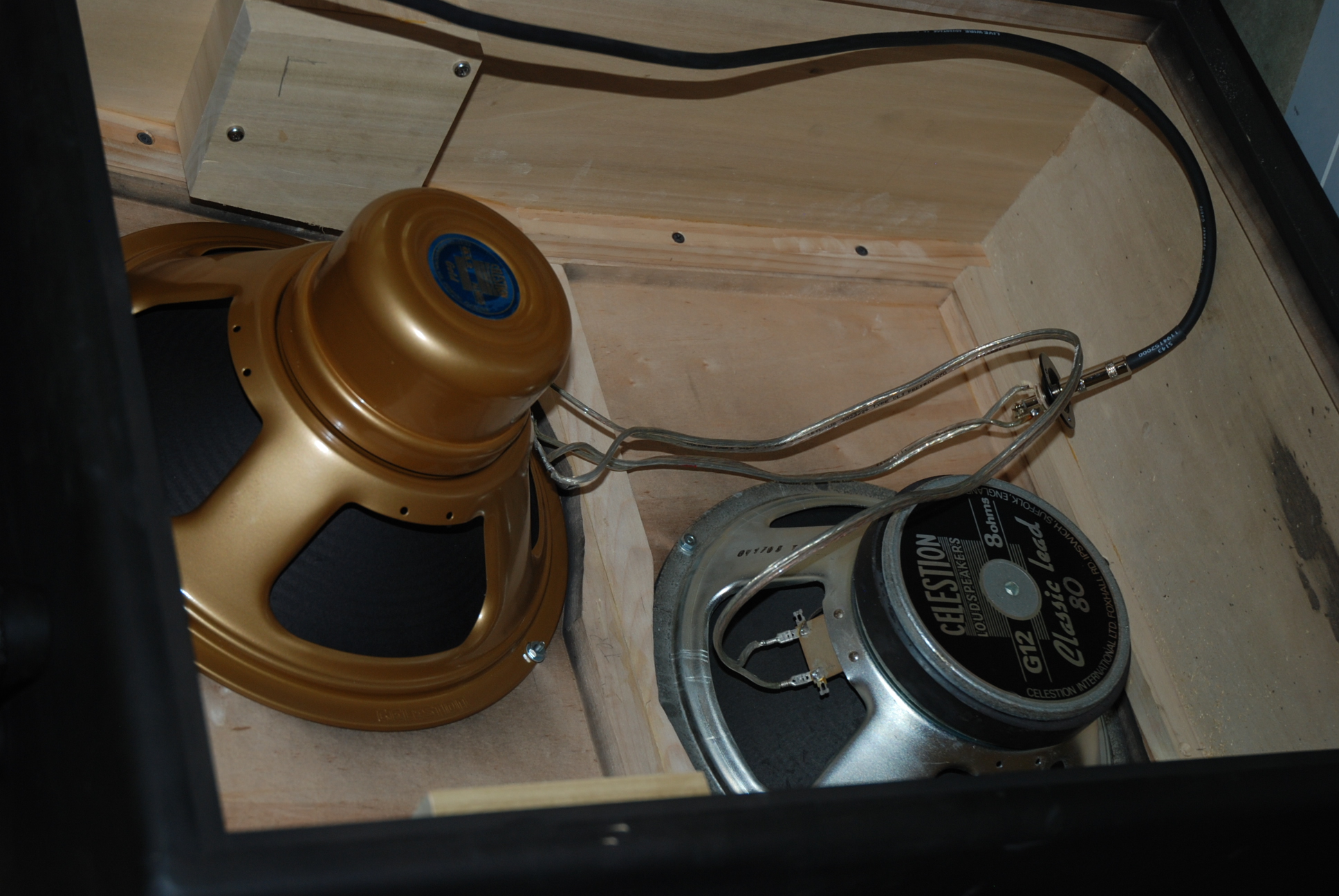

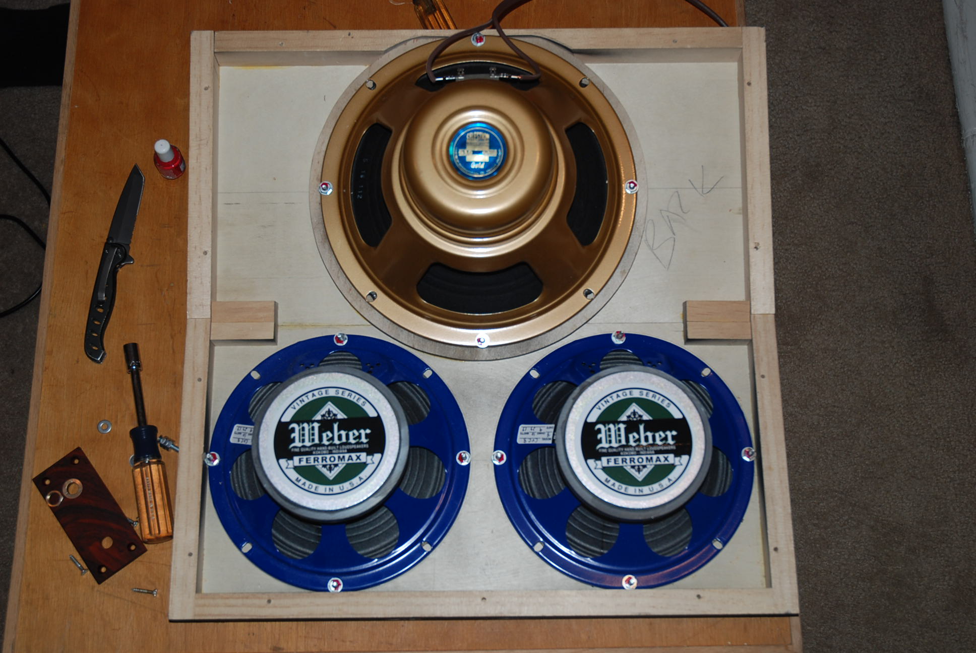

Re: Construction pics of speaker cabs
Here are some pics of various cabs. I generally build the box, add trim pieces to the front and back edges and then put in the bracing for the baffle and back panel. I did screws to attach the bracing to the box at first but don't bother now as glue 'gets it done'.
I build baffles from 1/2" ply and add 3/4" bracing to support it when I build slant cabs. The internal bracing is 3/4" as well.
I haven't had any issues with rattle to date - I use 9-12 screws to attach the baffle and back.

Thanks for the pics guys. I like the bracing idea.
