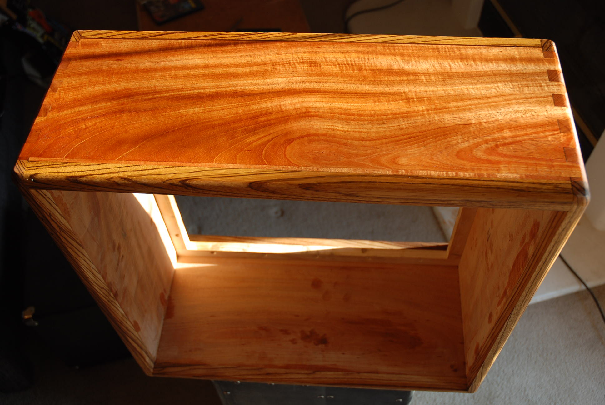

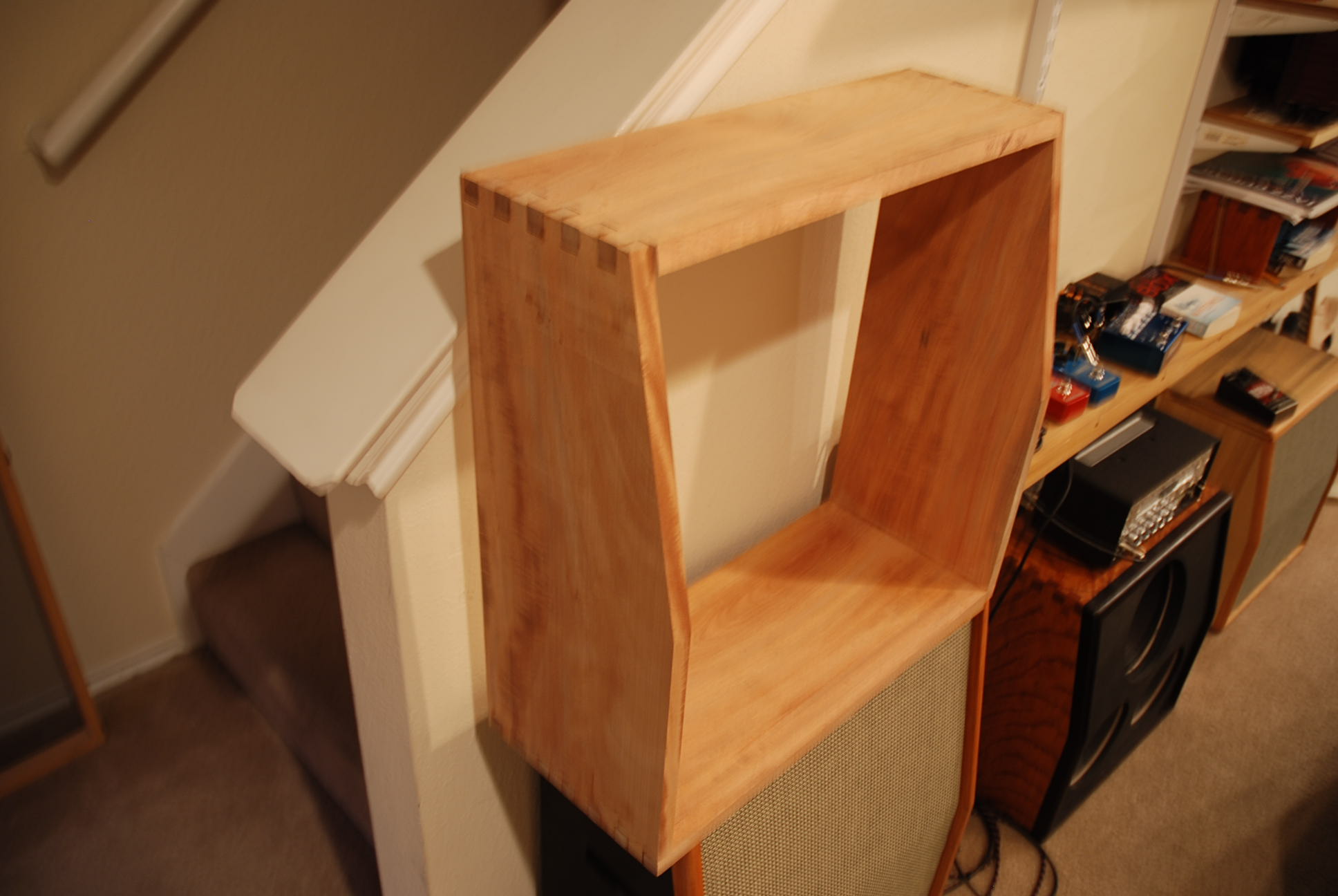

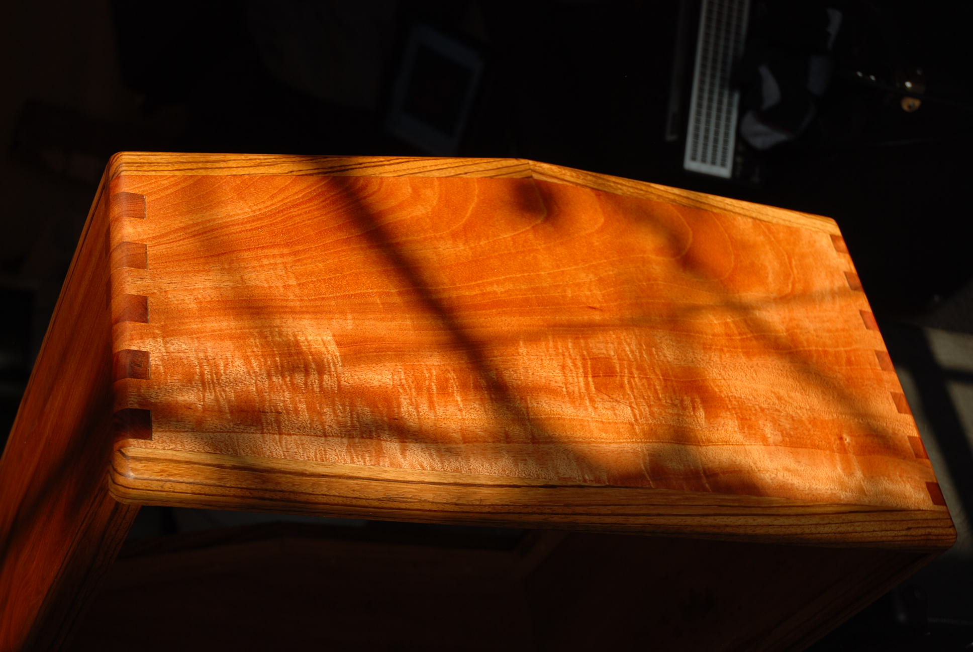

Latest project 4x10 with African mahogany and zebra wood trim. So far finish sanded to 220, slurry sanded [320 & 400] and two coats of oil. It will have two 10" golds and 2 10" greens. Both of these woods were PITA to work with. Both wanted to squirm around but finished very nicely. I have already picked up some spalted mahogany and some walnut that would not let me walk away for the next unknown project.

How is the trim held on? Just glued edge to edge, or is it half lapped, dowels, biscuits?

Glued using Titebond II. This is the fifth cab I've only glued the trim on - no issues.
I goofed on the baffle supports [pine to the mahogany] and tried to whack them out with a mallet. No go - I have done this before and found I broke the wood and not the joint. On a high stress joint I would use biscuits but that is probably overkill as well.

Is the oil a "final" finish or do you plan to lacquer or coat with something else in the end?
That is beautiful. I'm about to route a pine 2x10 before I decide on a finish.
Re: Mahogany & Zebra wood 4x10
I have done several experiments with finishes on wood - guitars and gun stocks mostly. I keep coming back to oil [boiled linseed/mineral spirits] because I manage to ding the surface and oil allows for easier fixes rather than total refinish.
