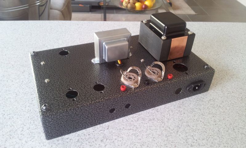

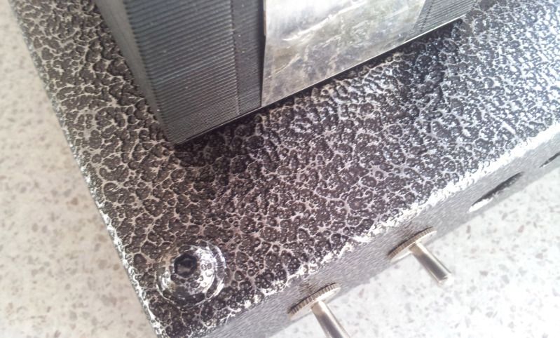

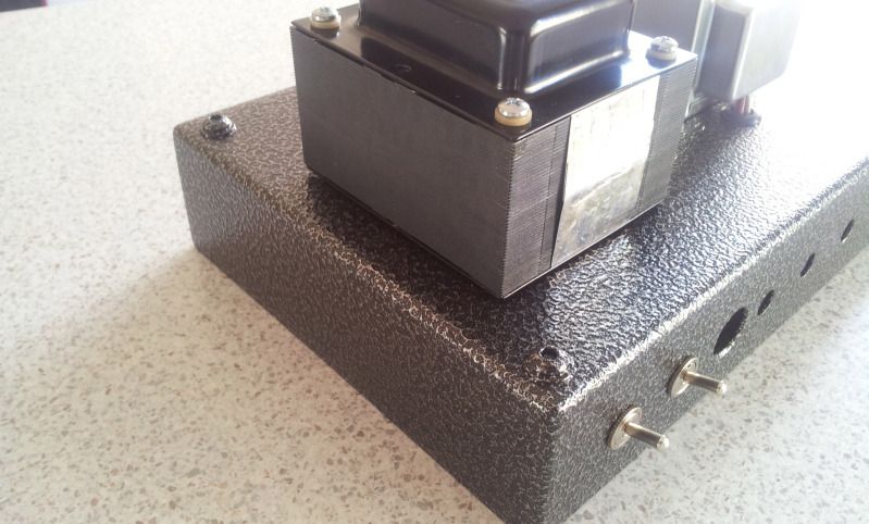

Chassis after powdercoat....
[IMG:799:482]http://img.photobucket.com/albums/v87/x ... 164817.jpg[/img]
[IMG:799:482]http://img.photobucket.com/albums/v87/x ... 164839.jpg[/img]
[IMG:799:482]http://img.photobucket.com/albums/v87/x ... 164847.jpg[/img]

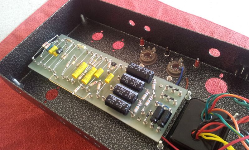

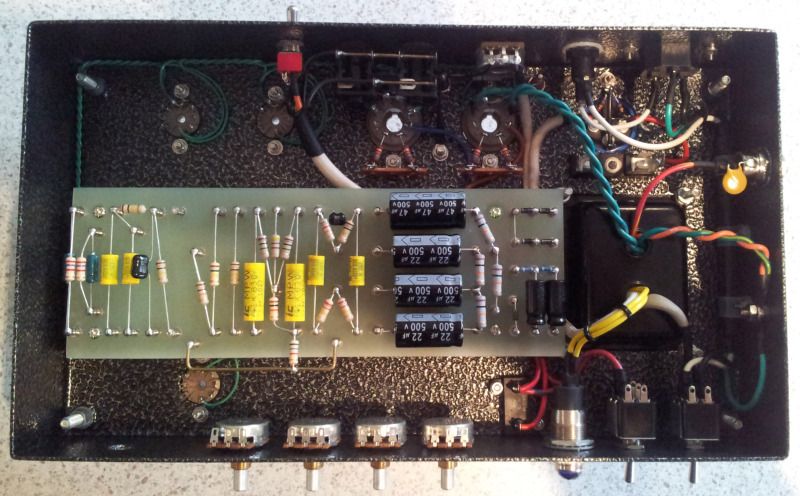

Board staked, turreted and loaded....
[IMG:799:482]http://img.photobucket.com/albums/v87/x ... 165120.jpg[/img]

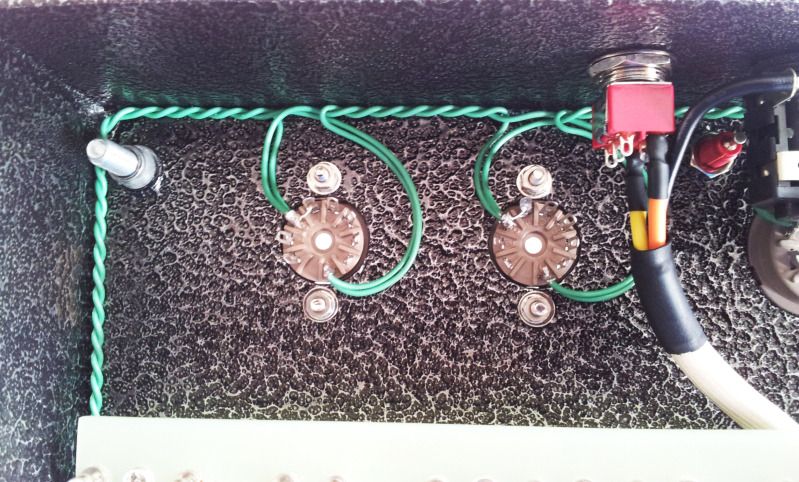

Heater wiring done....wrong but fixed now. Too many hours building and not enough sleep. haha.
[IMG:799:482]http://img.photobucket.com/albums/v87/x ... 121924.jpg[/img]
Chassis wired, ready for the board wiring...
[IMG:800:496]http://img.photobucket.com/albums/v87/x ... 190932.jpg[/img]

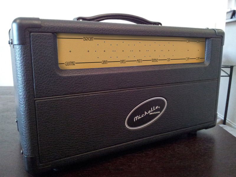

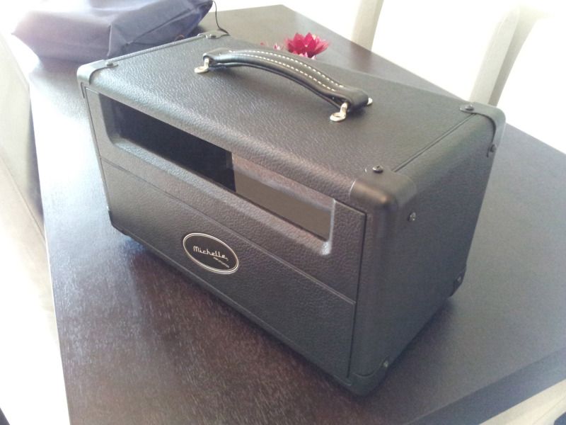

Headcab covered ready for the chassis....
[IMG:800:600]http://img.photobucket.com/albums/v87/x ... 151630.jpg[/img]

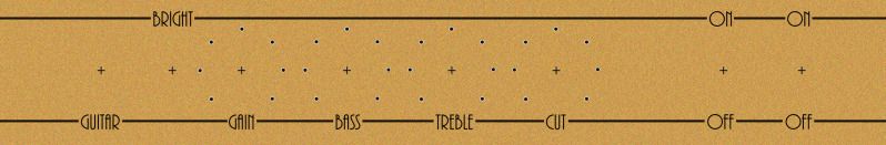

Still waiting on a couple of minor things for the board before I can get it installed and I also need to get cracking on the faceplates. This is what I had in mind....
[IMG:798:131]http://img.photobucket.com/albums/v87/x ... mockup.jpg[/img]
[IMG:800:600]http://img.photobucket.com/albums/v87/x ... mockup.jpg[/img]

Super clean wire job. Meticulous turret board too.
Until you try yourself to get results like this, no one understands how much extra time this really takes to achieve.

Great looking amp inside and out! Recycled chassis? Can't tell now.

This is the third time its been rebuilt. Dont think there will be a fourth!

Quick question. I see the heaters are tightly coiled until the last run to the tubes where the two wires go parallel. Do you get any hum? Just trying to understand the limits of coil vs no coil and at which point hum starts to creep in. Thanks for sharing.

Thanks. I always do my heaters this way and never get any hum, although I suppose I could twist the parallel wire too. As long as its not a performance issue I like the look of it done this way. Every build is different so you have to be willing to adapt if need be. Maybe ive just been lucky!!!

The amps up and running. Ive still got to fit the fast/gradual switch, but she sounds amazing. One thing that surprises me is the lack of noise. I think having the first triode directly under the input jack has great benefits. Its hooked to the input with a 33k resistor......no sheilded wire. The only piece of sheilded wire runs from the gain pot to the rear of the chassis. Ill get more pice up soon.
