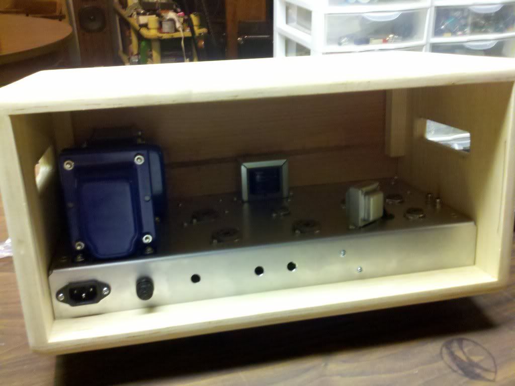

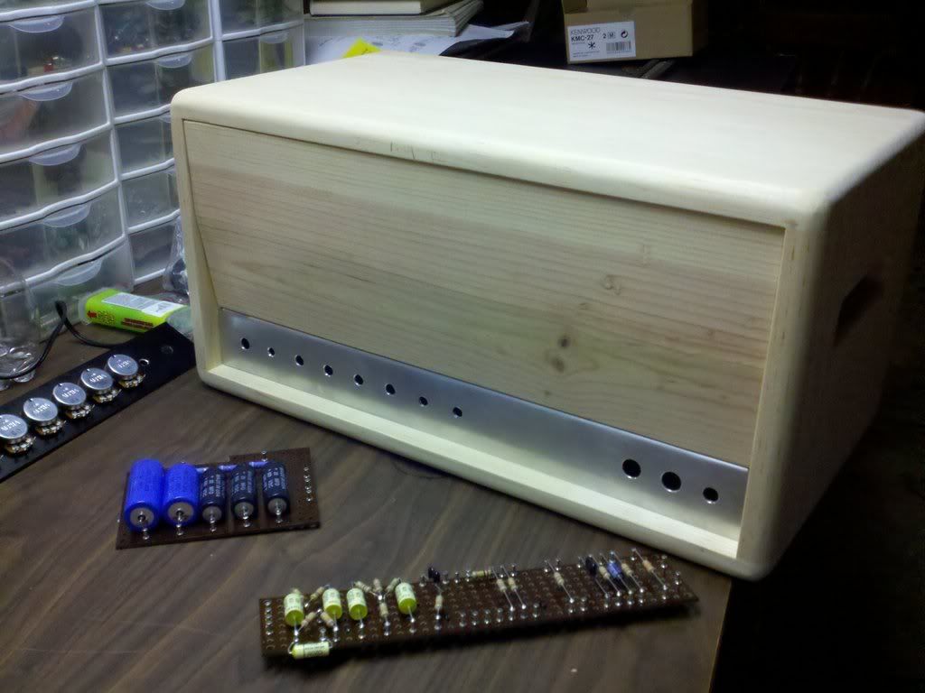

I exchanged a couple of emails with rj. I'm pretty solid on the layout... Looks like I will have some time to spend on this project. Just wanted to post a couple of pics...
This is the way it came out of the box. I didn't realize that rj would put this much prep work into it. He does suggest pulling all of the screws and bolts for Loc-tite. I will do a headphone check too... I accidentally left the reverb tank out.
[IMG:768:1024]http://i946.photobucket.com/albums/ad30 ... _6292_.jpg[/img]
This was just for a test fit before I get to work...
[IMG:1024:768]http://i946.photobucket.com/albums/ad30 ... _6294_.jpg[/img]
And here is a shot of the back...
[IMG:1024:768]http://i946.photobucket.com/albums/ad30 ... _6295_.jpg[/img]
I'm not 100% sure on the component placement... I know there are a couple of components to place yet. Gotta look at the layout again.
That's it for now...
Tony

Wow!!Nice looking job,You in good hands with rj.Your going to have a very cool amp.Keep posting your progress,Lookin good,Mikey
