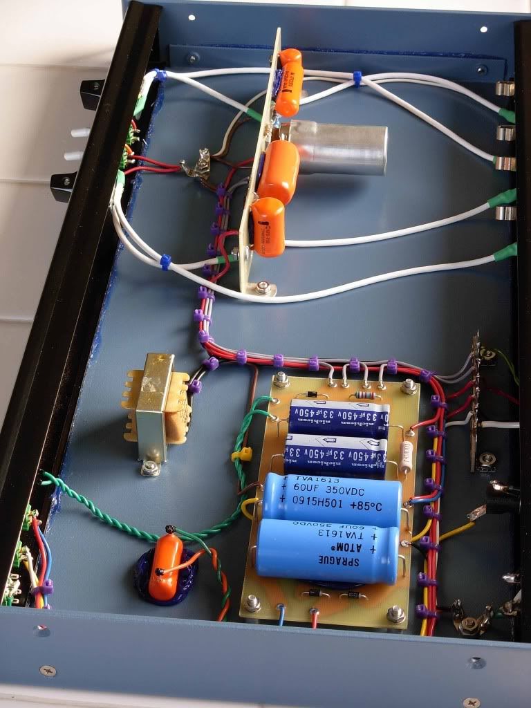

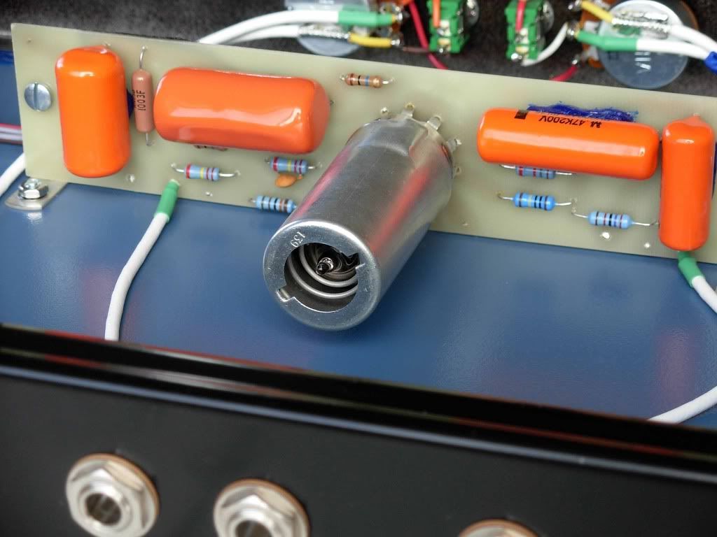

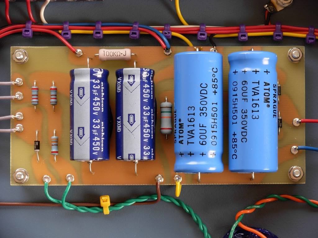

Here are some pics of my latest mono Dumblelator build. It is slightly different from the first one I build in that it uses values reported by drz400 here: https://tubeamparchive.com/viewtopic.ph ... c&start=30
It works great! The bright cap on the send pot is very subtle, which is something I might change. Tube is a Chinese 12AX7A.
Also, being a Dumble nut, I was quite happy to have found the original chassis used in the real Dumblelators. I like this one much more than the Hammond alternative because it doesn’t use those annoying corner brackets and the top lid is much less fidgety getting on and off. A big word of advice when using a rack chassis like this: glue it! If you don’t those panels will rattle like crazy if your amp is situated anywhere near it.

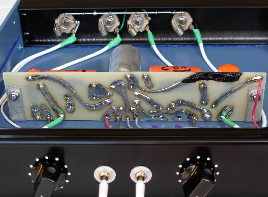

The black RTV is there as a "fail-safe" to insulate the trace for the plate of the recovery stage (pin 6) in order for it not to make contact with the unpainted top panel of the chassis when fully assembled. I had a slight bit of leeway with the trace but you can never be to sure! 215V=ouchie
