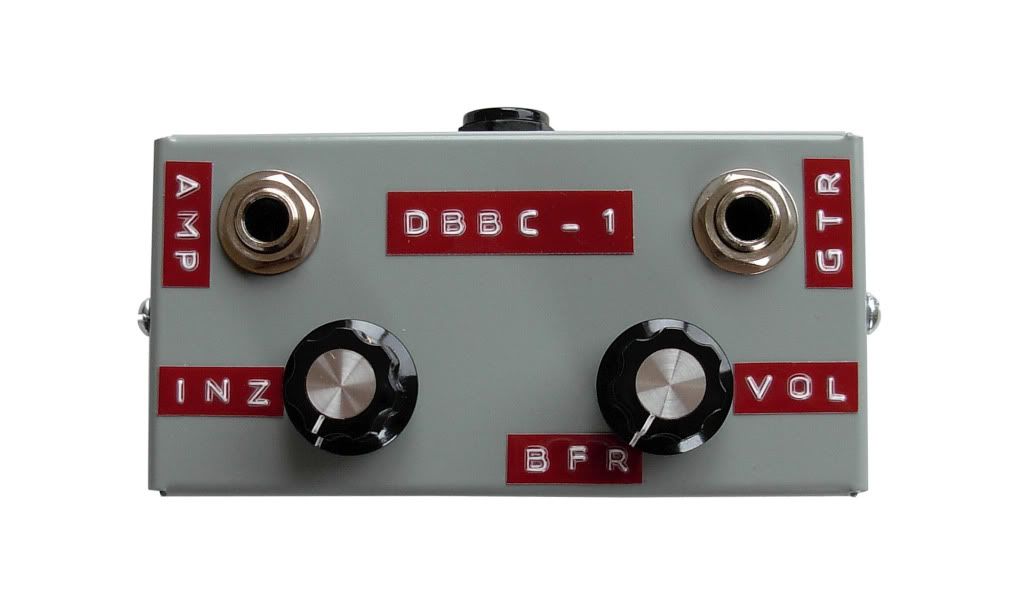

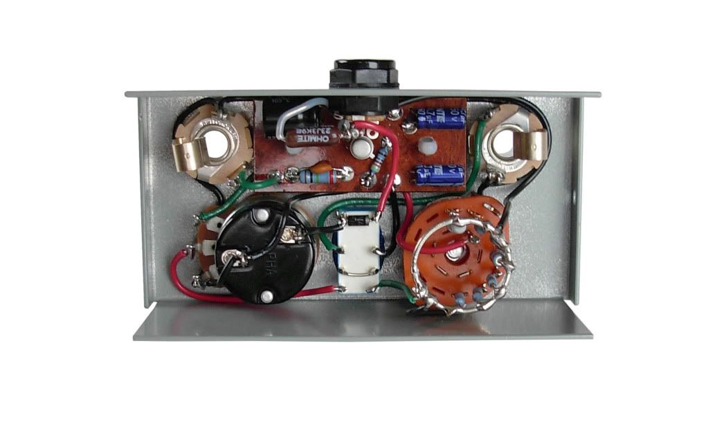

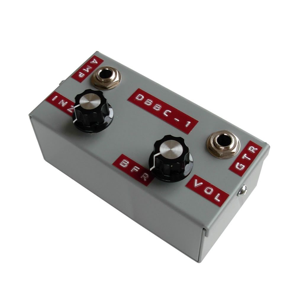

Below is the schematic with Voltages and some pictures of my build which has been built to resemble the Dumble BBC-1 (https://tubeamparchive.com/viewtopic.ph ... light=bbc1). Note: Voltages shown are with a NTE452 FET and I've left off the bypass and rotary switch wiring. On it’s own this FET circuit gives a great clean boost and it can prove to be a useful front end for amps other than the ODS as well.
