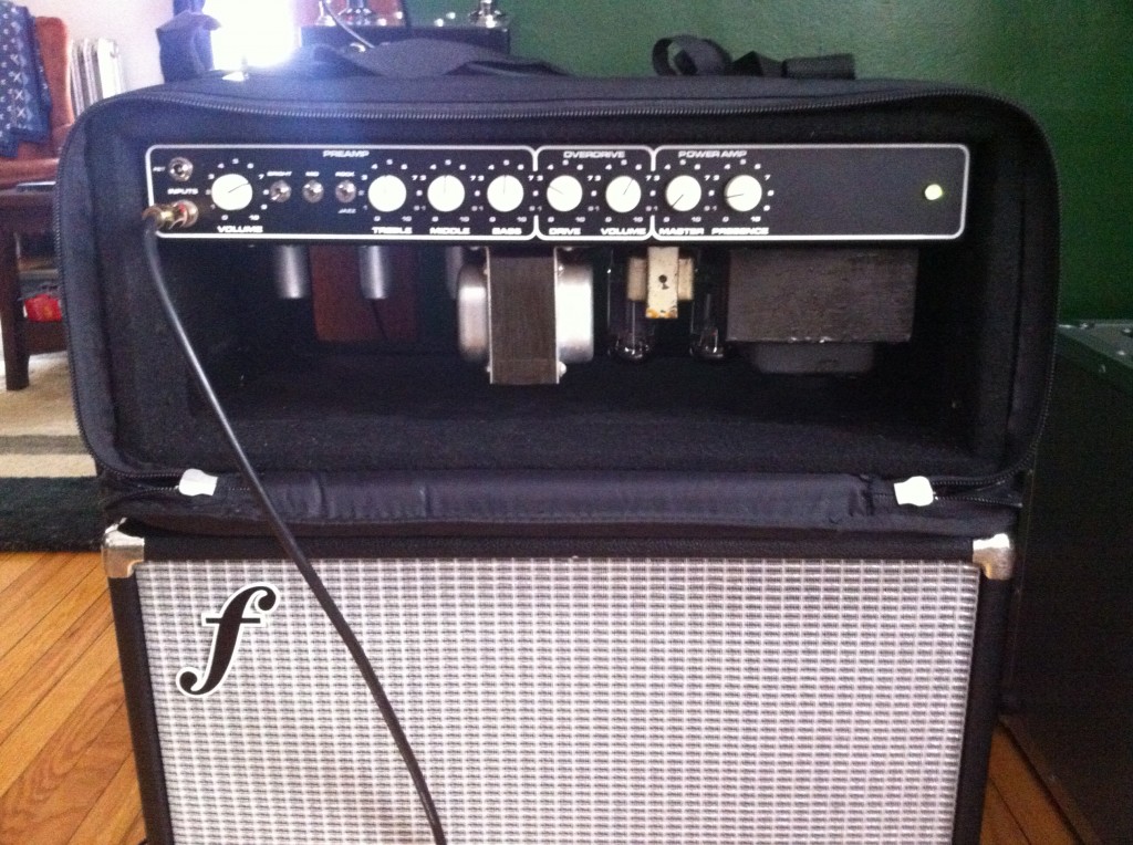

Thanks! I forgot about that. I just boxed it up too! The good news is that the FET input sounds pretty good anyway. It looks pretty funny in the rack case. I'm going to have to buy a nice head shell for it once I get the money together.martin manning wrote:Sounds good! Do check the FET voltage and bias now that you've raised the voltage feeding it... At 24V it was a little high when you started.

Here it is all boxed up. It looks a little funky in the rack bag, but it seems to fit just fine.

Re: YAOB (yet another one-zero-two build)
It's OK Brother... whatever works until you get a head box.
Play it a bunch. As the components settle in, it will sound better as it goes.
Nice job.
Thanks! It already sounds pretty amazing I think. This is my first time playing through one of these types of amps, and it's a real eye-opener. The overdrive kind of reminds me a bit of the old tweed Fenders, but much bigger and more refined. The amp really makes you want to play and the range of expressiveness is wonderful.guitardude57 wrote:It's OK Brother... whatever works until you get a head box.
