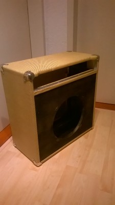

Today was woodfiller, sanding and routing the edges. Routing the edges was enjoyable, no mistakes and very good looking and smooth.
Then tolexing: I don't know if it was the temperature or the kind of glue but I had problems to get a good adhesive property.
Added to that I made a killer mistake when cutting the tolex on top.
I decided to repair that later, but I used all my glue, nothing left. So that will be a future repair.
What kind of glue do you guys use?

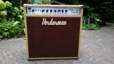

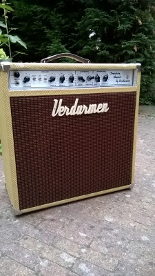

I re tolexed the upper part and used Pattex woodglue. Works like a charm! Much better for me than the servisol stuff.
The grillcloth is attached to the baffle.
For a first time cab build Im fairly happy with the outcome although I see room for improvement on different parts of the cab build.
Thanks all of you for your magnificent input, much of the advice was spot on.
