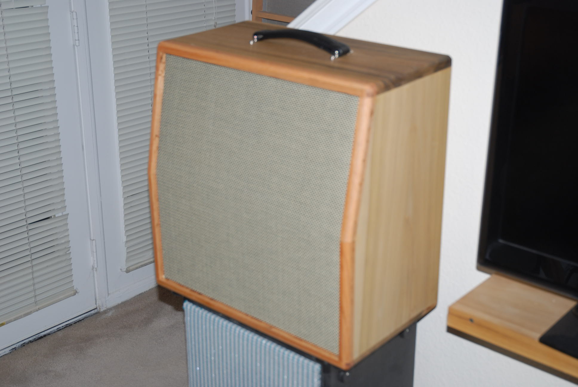

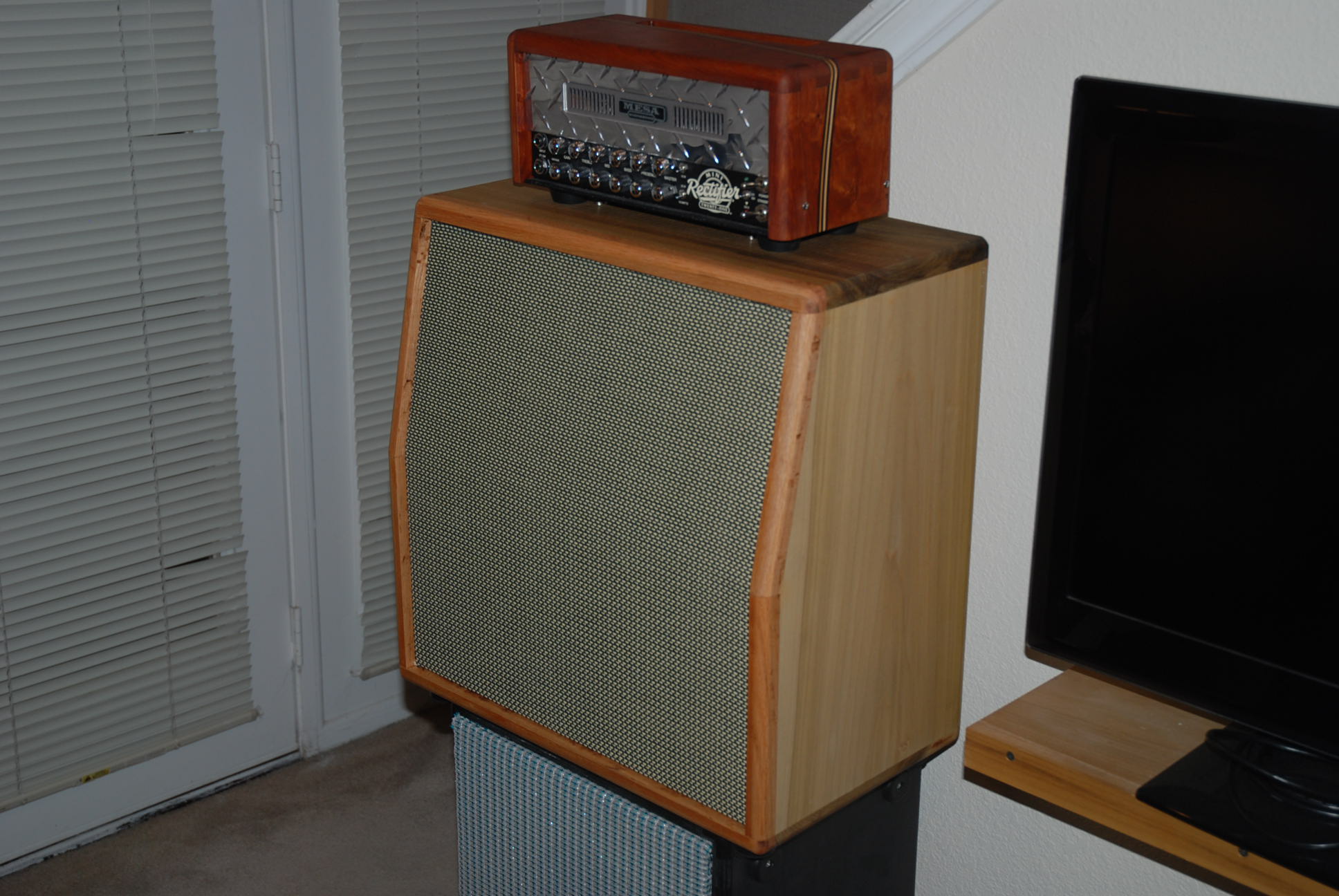

Grill cloth and handle installed. I guess the weight at about 16 pounds.
Waiting on two more speakers from Weber. On the hunt for a decent speaker mic. Contemplating a bottom cab for a 12" - a full stack - yes I am nuts.
