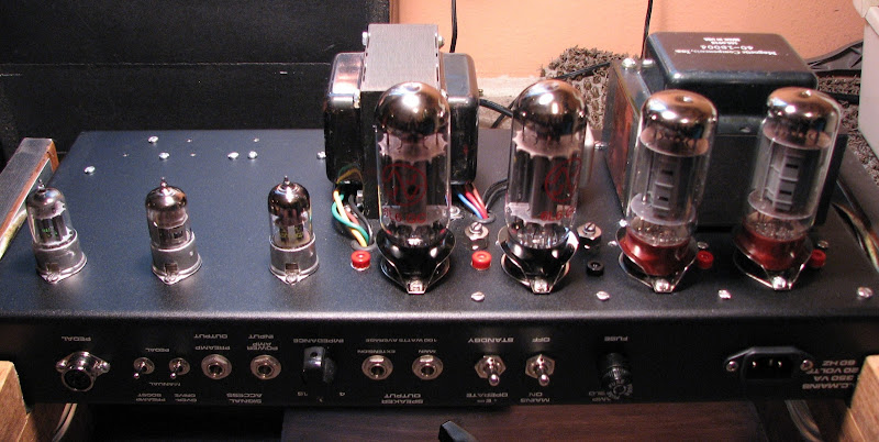

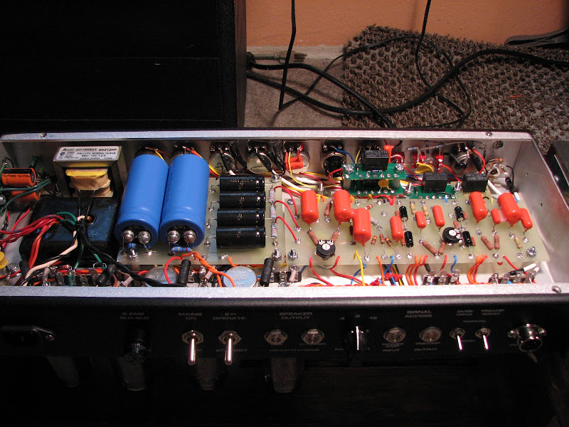

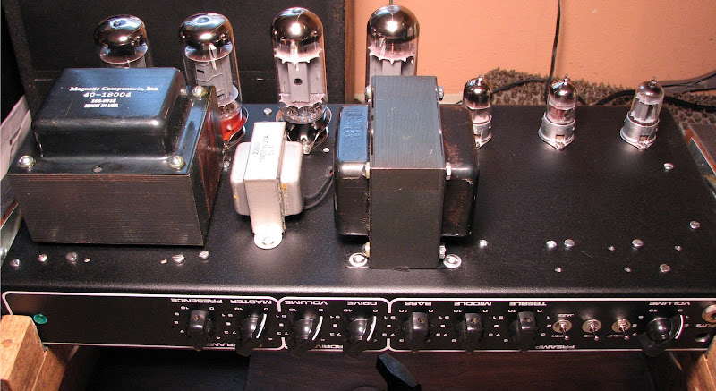

I fired the amp up yesterday. I first used a light bulb current limiter and everything checked out.
I had a couple mistakes with the relays and the front panel switches.
Late last night I was measuring voltages and with all volume controls at zero I was getting some very loud full volume noise, like huge crackle noises.
Might be a ground issue or something or even a bad power tube.
Not sure what that is about and I will try to figure it out today.
I looked over the solder joints and didn't see anything obvious.
My observation while building this amp is that it is quite an undertaking.
There is a lot going on in these amps and for somebody to sell one for $3K is pretty understandable when you figure in the man hours to build one.
I'm sure if I was to build a number of these one after another I would get faster as I wouldn't have to take the time to design the boards and what not.
A lot of wiring and a lot of components equals a lot of hours!

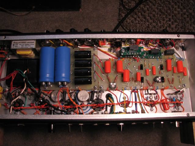

It's hard to tell in the pics, is that 4 relays? What's the what what on them?
