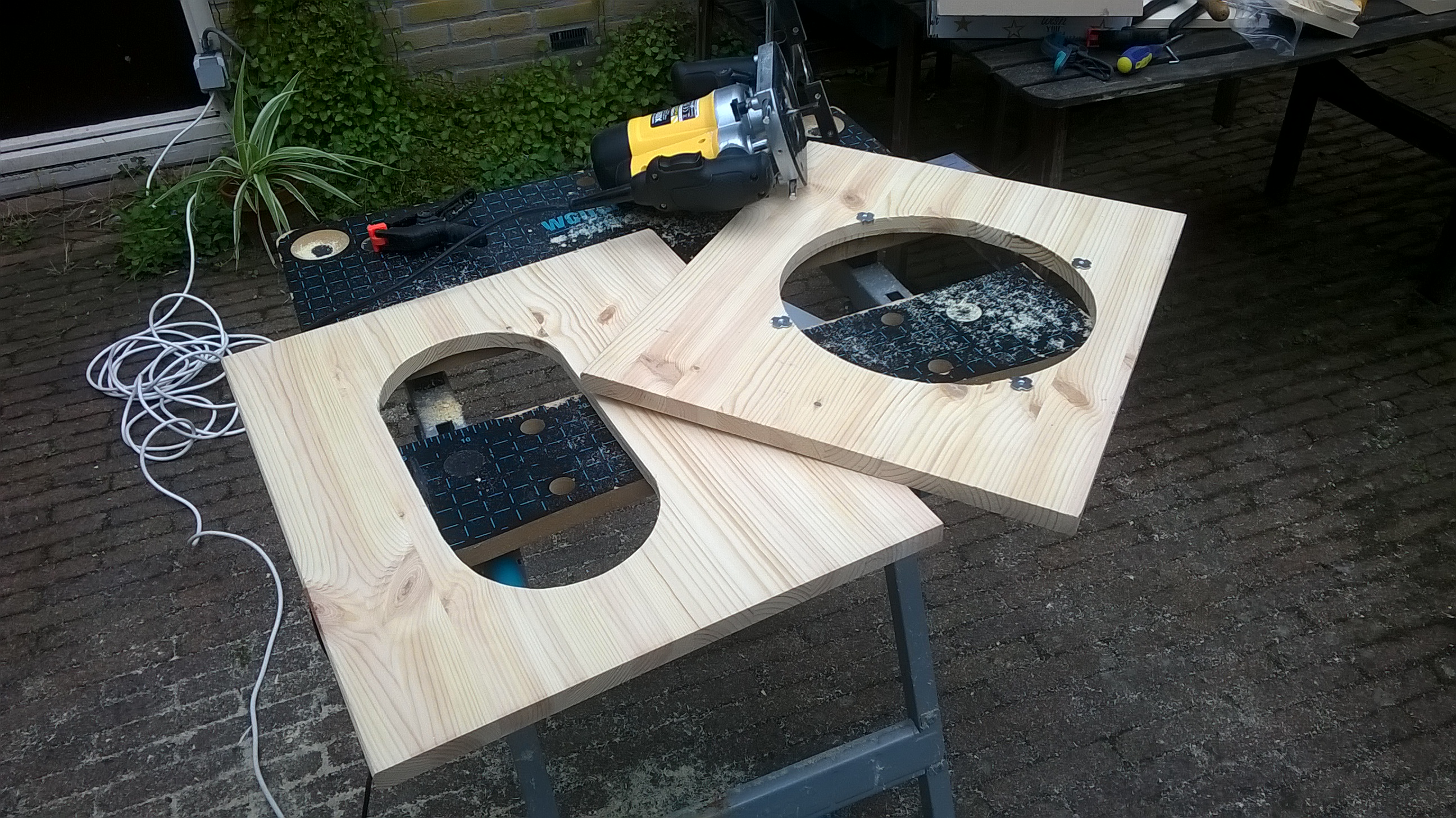

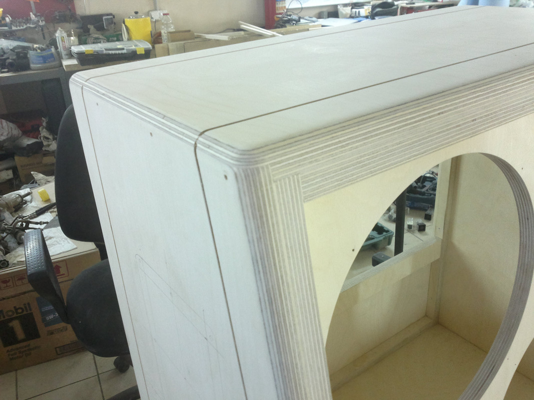

Hot weather is over and used the router. Did some testruns on scrapwood.
So far so good. When going for real I had some issues with a screw, replaced it by a bolt but the damage was done, not a perfect circle :x
Practice makes perfect I guess:
Next days more.

It doesn't need to be an exactly perfect circle as long as the speaker fits correctly. Grille cloth will cover that. :wink:

Makerdp: I did a speaker fit, it fits without leaving any holes.
Thats positive for sure.

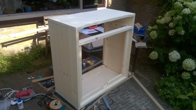

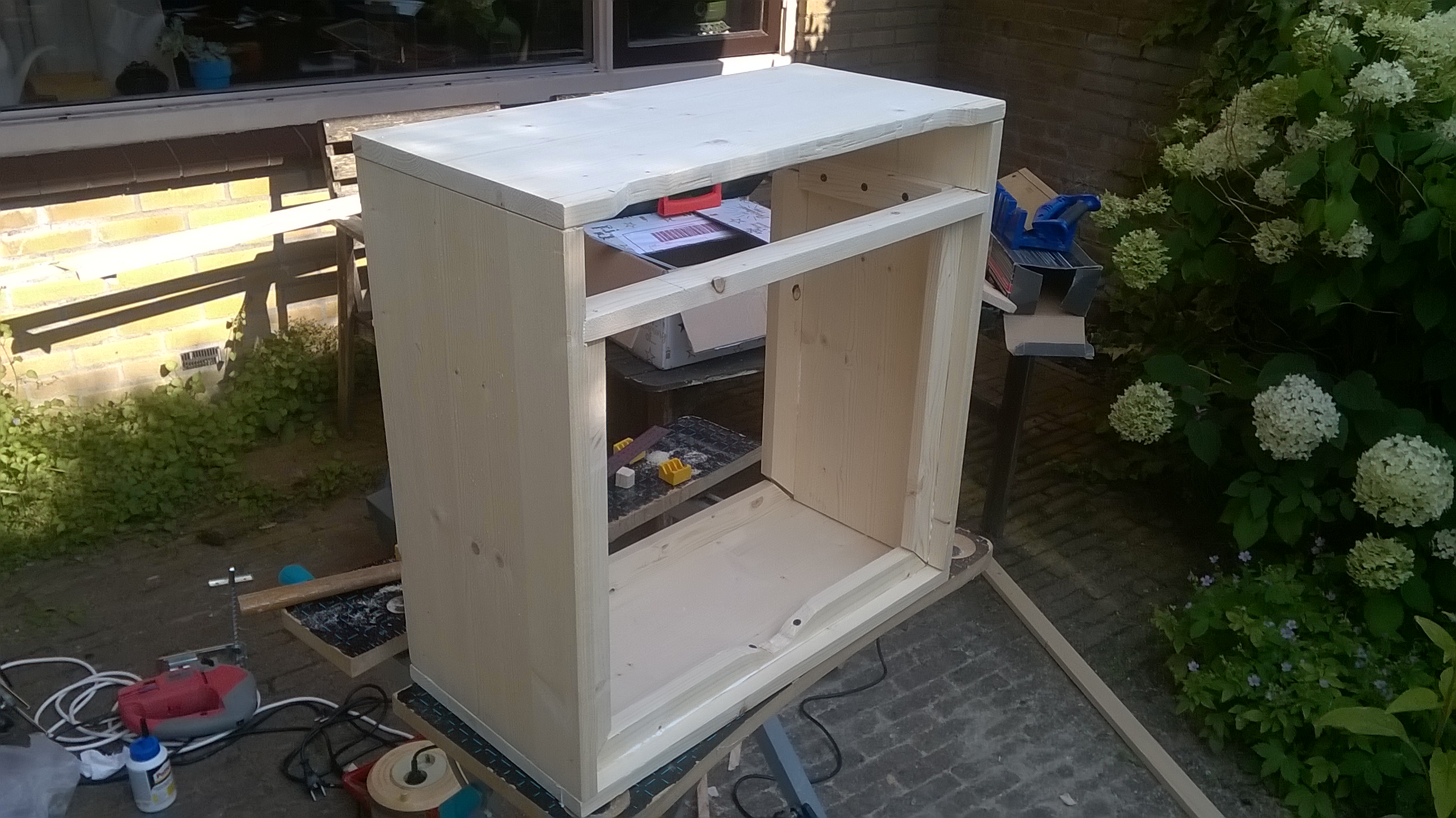

Almost done with woodwork. Tomorrow round the edges with a router and maybe some tolexing.
Im happy with the progress, also a bit lost with all little stupid mistakes which make the hours count.
This is way harder than doing the electronic part of the amp.

looking good Erwin, it will be fine one you've routed and sanded then tolexed :D
I agree , without proper tools and a workshop/garage it does take a long time to do this stuff.

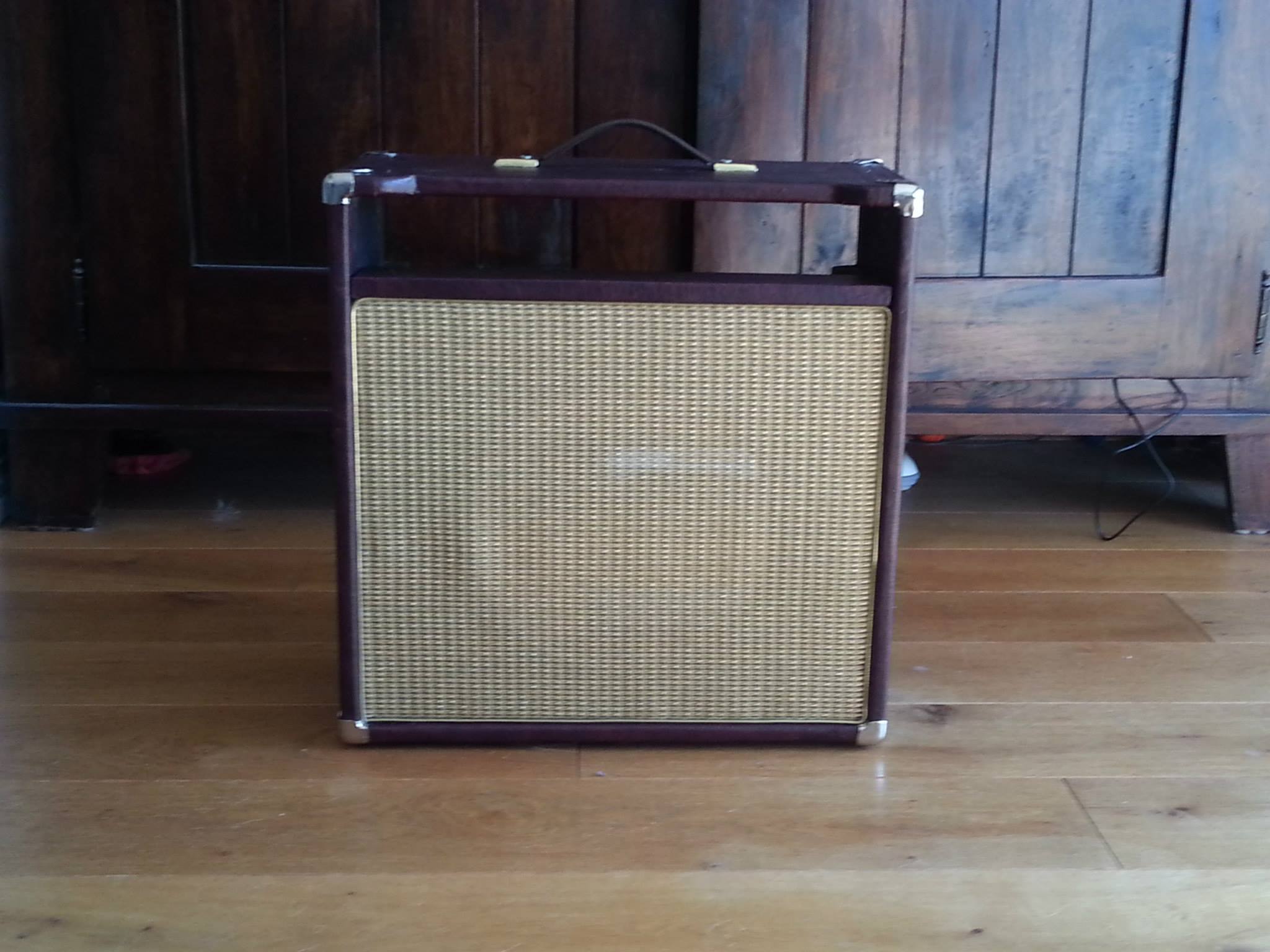

I have been where you are now. Indeed with a bit of routing, sanding and tolexing you will do just fine. I would pay special attention to the sanding. Take care of dents. Tolex can cover up a lot but not everything.

I see little waves on the grill. If it is a fender-style fabric you can try to use a hairdryer. This fabric shrinks slightly when heated and similar waves can be smoothed. But first you need a little practice on small pieces of the waste!
By the way, to fix the sagging of the paper grill (like Marshall), it is enough to wet it a little.
