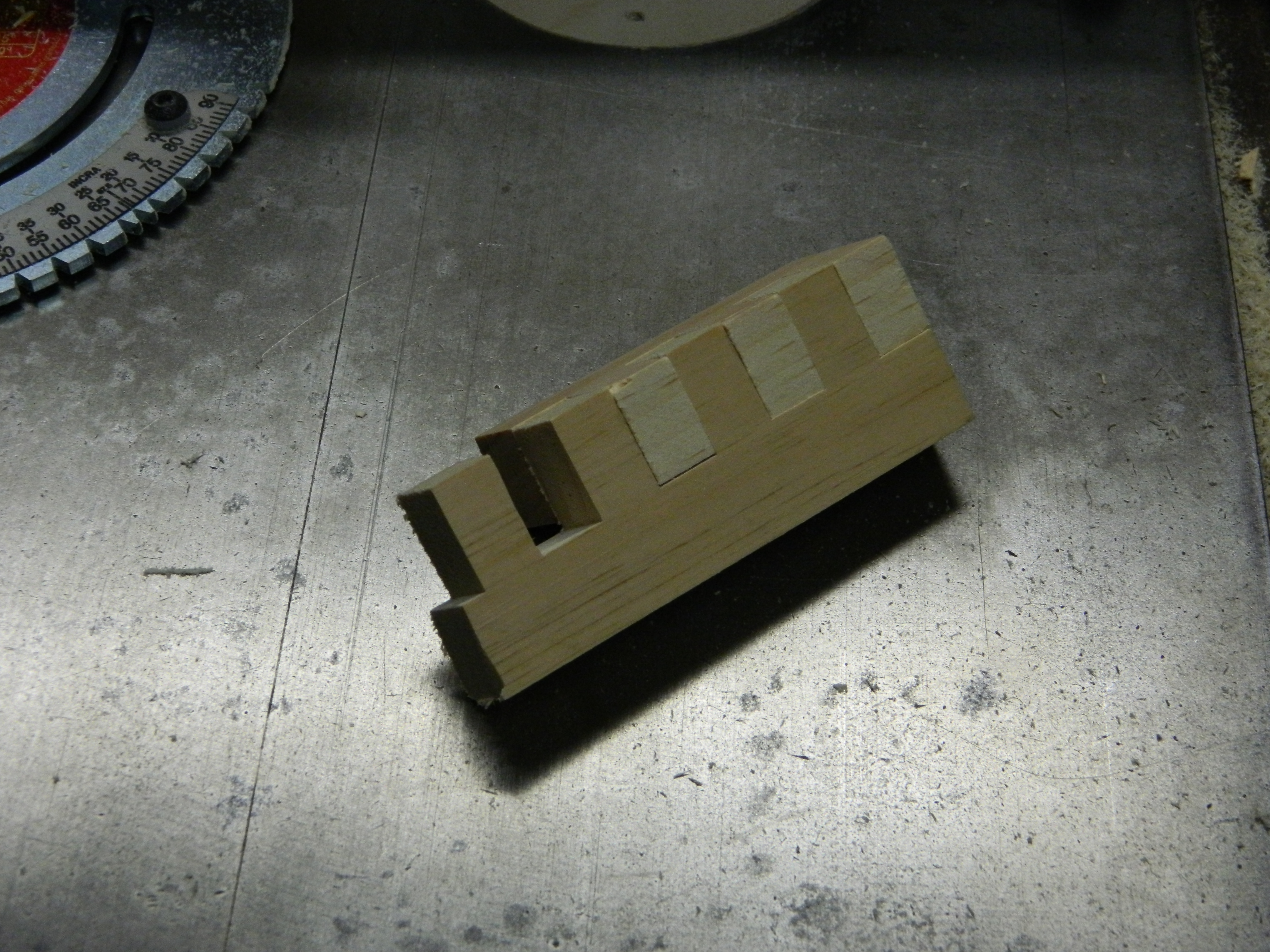

amplifiednation
Posts: 2091
Location: Boston
Re: Finger Joints
Post by amplifiednation »
I haven't had problems with swelling either, but I have had problems with spacing and having joints fit too tight. I'll usually cut a few 4x4 or so pieces of test wood and really work to get it perfect.
When I first started doing this it was a challenge to get the fingers to fit right...it's all about the test cuts.
If you don't have time to do test cuts then you definitely don't have time to redo your project!!
I think the router would probably be a good method but I haven't figured out a way to control dust from the router like I can with the table saw.
