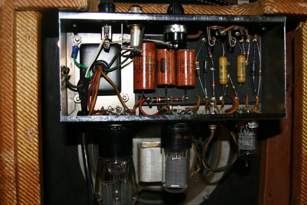

That's why I questioned my amp repair tech when we found
two 60 year old filter caps not working and that he chose to replace
all six original Astrons (including four good Astrons) with six new
Sprague Atoms. He told me it was all six or nothing ~ as he could not
do a "half-job". That the other four were ready to fail after sixty years of usage.
Well, the results are incredible. I like to compare to an older 1954 Cadillac car.
Gotta replace the spark plugs, get new tires, new seat covers,
new paint, change the oil, etc etc etc.
