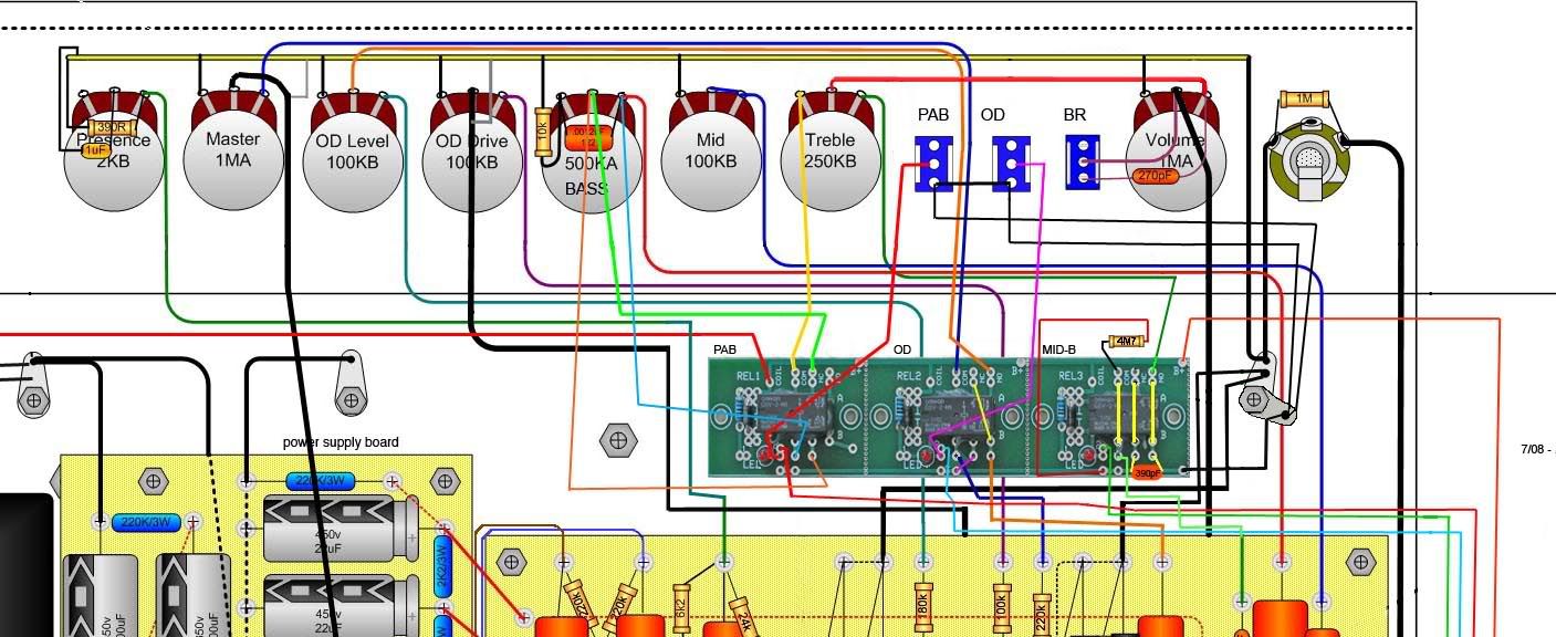

Re: footswitch problems
Relay wiring can be confusing.
This may be late to the game but when I built my amp and used J. Border's relay pcb's I made these drawings to go by.
The top picture in each is like the way Dumble did it, then below is how to wire it using the Border pcb.
Cool thanks so much Tom
this will help me check my work
I think I have some changes to make
no ground on the PAB?
dotted lines on OD relay are underboard jumpers?
Sorry, I drew these for my own use so the notation isn't real obvious.
The dotted lines on the OD relay show how it is to be connected, you can do it either way.
I put a short jumper on top of the pcb where the dotted blue line is.
The only ground on the PAB is the on the bottom of the relay coil which is where the wire to the rear panel switches and footswitches go.
Remember, we are turning on the relays by completing the circuit to ground.

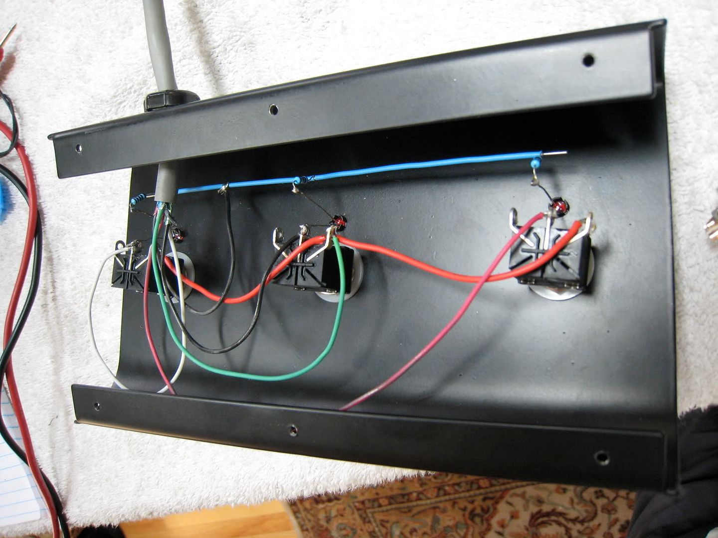

Here are some more pics of a foot-pedal that has OD, PAB Mid-boost
pink - PAB, White - mid, Black1 - OD, green - ground, Black 2 - B+
red jumpers daisy chained for ground. 1K dropping resistors on LEDS.
1152]http://i260.photobucket.com/albums/ii9/ ... G_1326.jpg[/img]
[IMG:640:480]http://i260.photobucket.com/albums/ii9/ ... G_1327.jpg[/img]
576]http://i260.photobucket.com/albums/ii9/ ... -deric.jpg[/img]
Thanks angelodp for the
nice detailed pics
nice detailed pics
