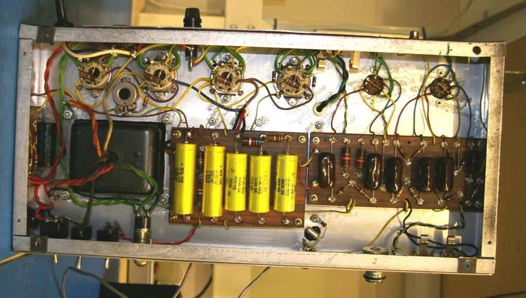

No I don't, this is the best I can do:thyx wrote:Hey UHOP...got a schem/drawing or layout of one of those odysseys?

From what I could find (based on all the old pics, blowing them up and studying them: It's basically a super-bassman or bassman-100 style driver with a cf driving the output tubes (cap coupled, not DC coupled like a bass amp).
Nothing special really. I think Dumble could have crapped in a Bud box and people would fawn over it today like the hope diamond (even if it stunk).

Are you speaking about the Dumbleland or the Odyssey? Because the Odyssey, so far, looks to me as if the power tubes are not CF driven.FUCHSAUDIO wrote:From what I could find (based on all the old pics, blowing them up and studying them: It's basically a super-bassman or bassman-100 style driver with a cf driving the output tubes (cap coupled, not DC coupled like a bass amp).

One model (Gary Johnson sent me some pics of it..) had a CF style driver and Dyna iron, a big bass amp. This one pictured has an input circuit and a driver, like a stripped down Fender...see what I mean ?
