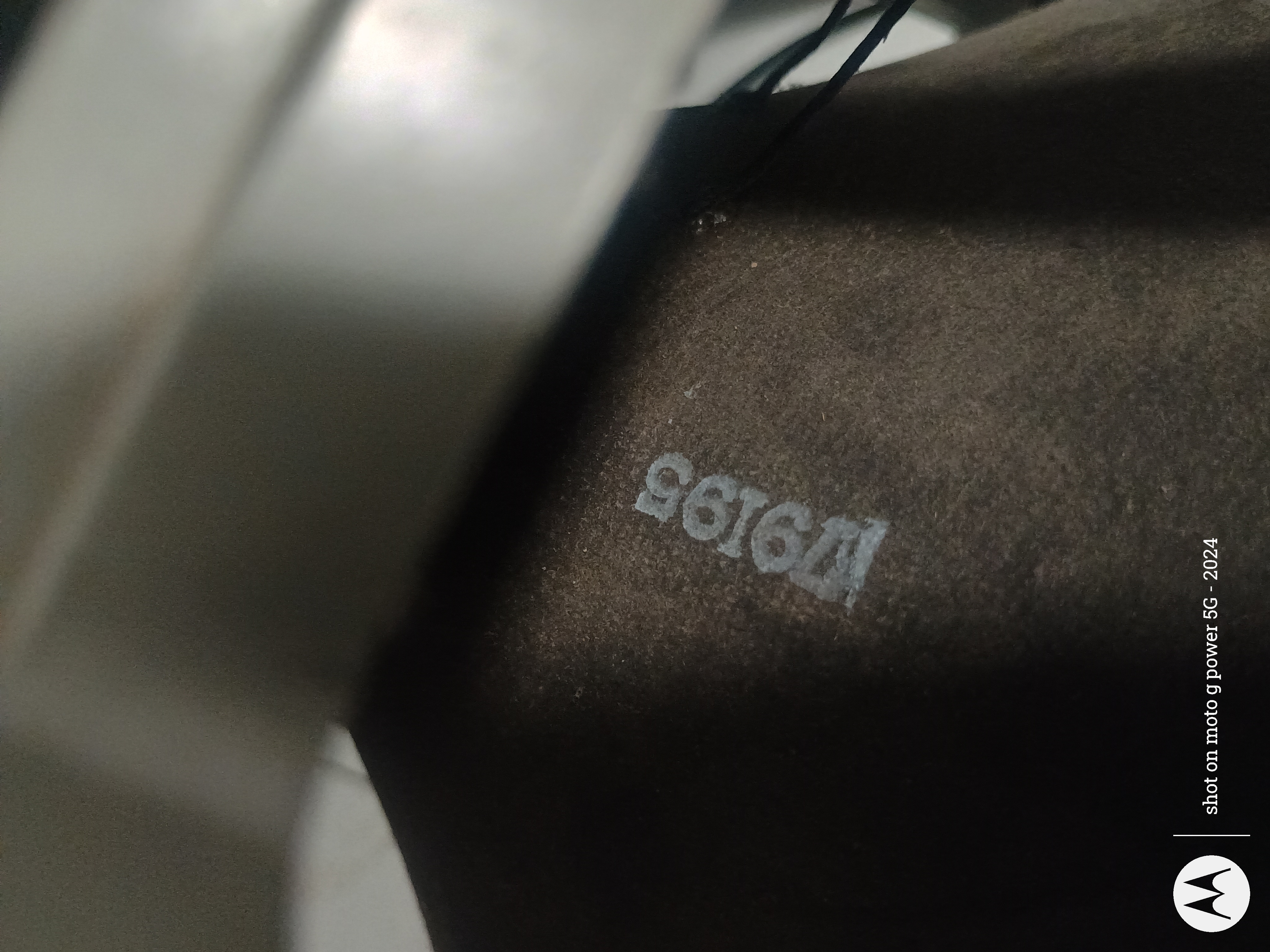

Who makes a decent recone kit for an EV 12l?
I have one with a busted up cone I got for free. I believe it came out of a Klipsch Heresy from the 70's.
I want to put it in a 50 watt D'lite combo.
I don't want to send it out. I want to try and do it myself. If I fail I'll send it out. Only the strong survive!
Any recommendations?
Excuse the mess. Cleanup day in the morning.

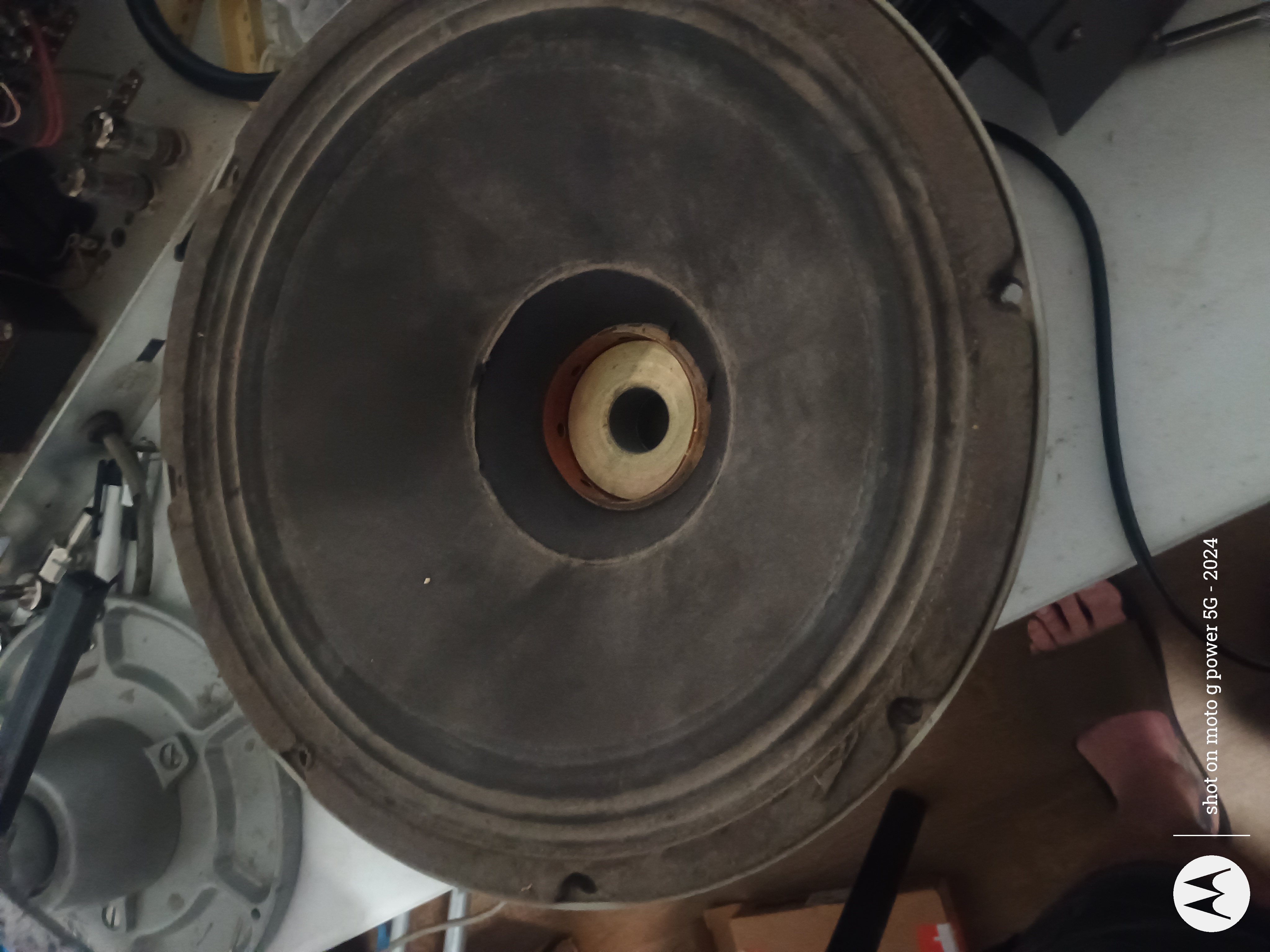

It looks like the cone is still good and it's just the dust cap missing. If the cone is not damaged, I would seriously leave as is. Replace the dust cap and you'll have a great speaker. I have never heard one with a re-cone that I liked over an original.

Agree with Ian all around. You can clean it up and cap it for the win.

Okay here's the truth on this post. I posted it thinking, for who knows what reason, the voice coil was damaged.
Upon further inspection I believe I'm going the suggested route.
Would this speaker have a white EV dust cap or just a blank black one? I know it's not a gold letter era speaker.

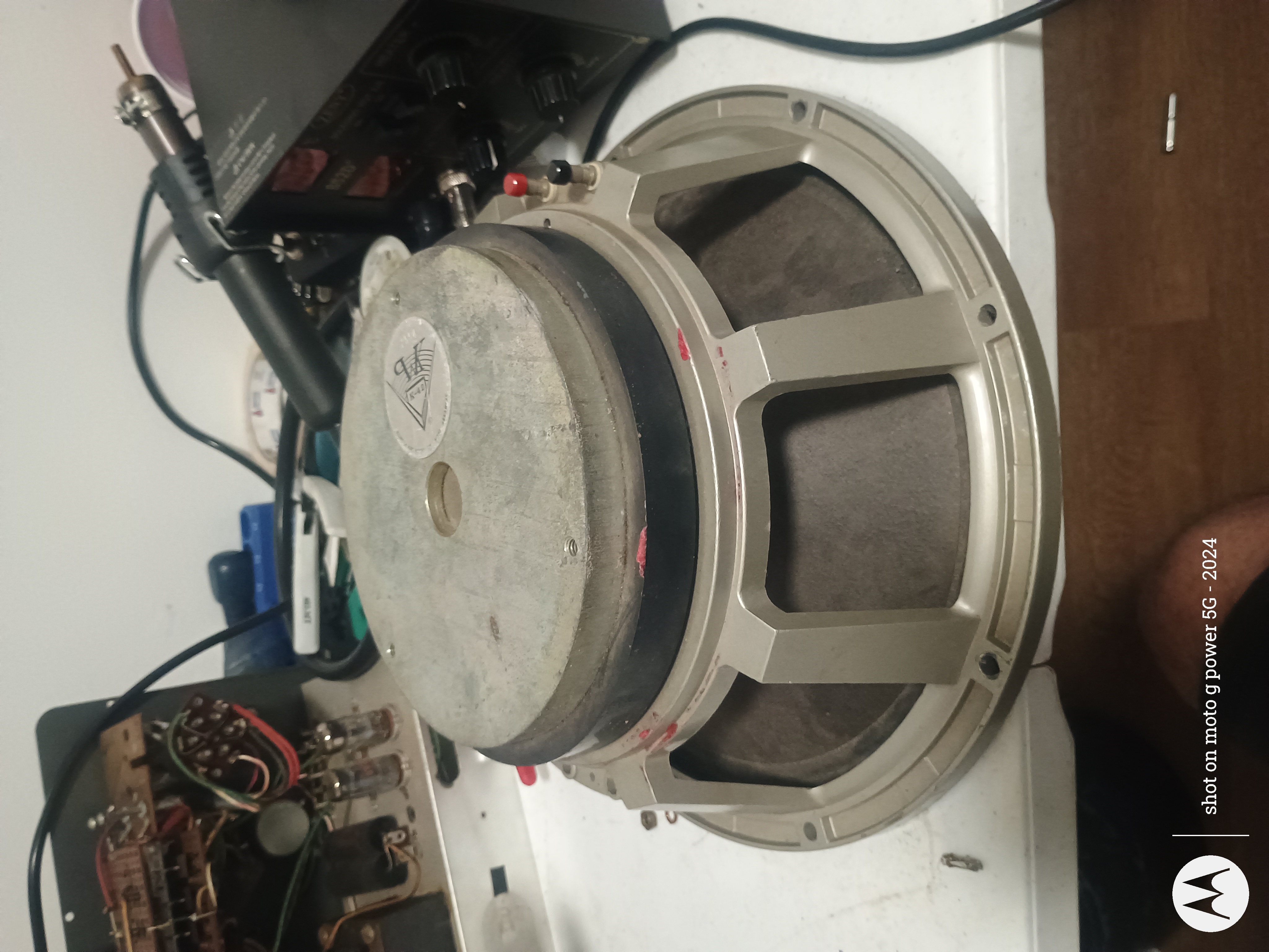

Does anybody know if my speaker in the pics above would have a white EV label or just a black without label dust cap?

In my mind I am thinking it is a logo speaker because it is more likely than not. It's the reason you buy the cabinet.dragonbat13 wrote: ↑Mon Jul 07, 2025 11:47 am Does anybody know if my speaker in the pics above would have a white EV label or just a black without label dust cap?
But in images, Klipsch never used branded speakers.
But you can use anything light that fits. Anything.
						Re: Evm12l recone kit?
Miles again on the mark. You could take a plain black and with a silver pen scribble "what, me worry?" on it.
Weber Speakers have a whole range of paper caps available in their parts catalog priced for less than the cost of shipping.

I'm going to use the blank one.  A d'lite with a Klipsch labeled speaker should throw em for a loop.
