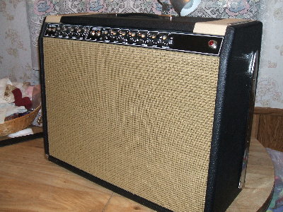

I installed some grill cloth on my speaker baffle last night.  It's not bad, but I'd like it to be better.
I'm going to do another baffle and have enough material left over to do it as opposed to redoing this one.  I can live with this one, so I'll just do another and see if I can get it better.

The corners turned out a bit rough, there's a slight wave to the texture, and it's not particularly smooth around the edge of baffle.

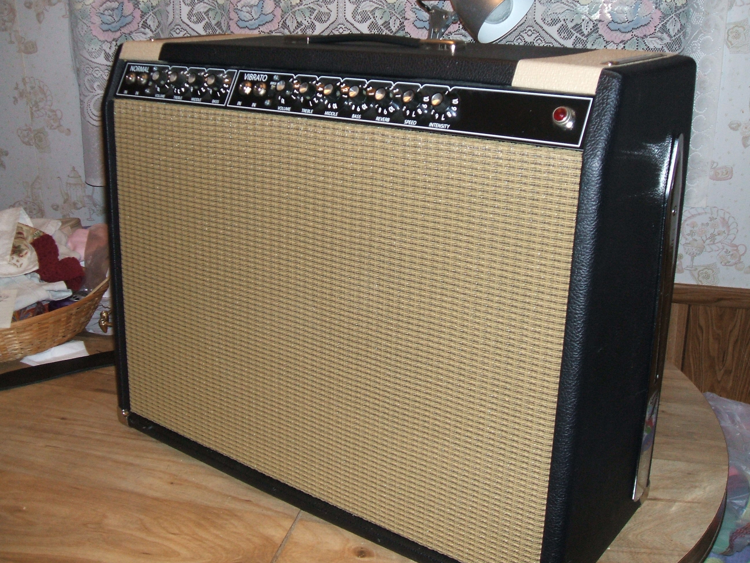

I have trouble getting the lines straight!
I have the best luck tacking the bottom, paying attention to the line. I then tack, (staple), a 1x2 to the top, and use that to tension the cloth. I then staple the cloth to the top of the baffle, attempting to keep the line straight at the top. After pulling the sides around, (and aligning), I staple the top, and bottom to the back of the baffle, (and trim as necessary). I've not mastered the art yet! (Notice the bobble starting around the reverb control!)

I guess you could tension from either, I go to the top so I can try to get it straight. The baffle is stightly rounded where the bobble is, and I never saw the problem with this amp until I had installed it! The next one, I did the same procedure, but used a straight piece of wood to lay against the baffle, and periodically check my self, (I pulled and restapled a few times to get it right.)
