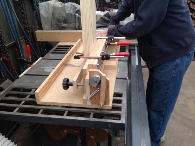

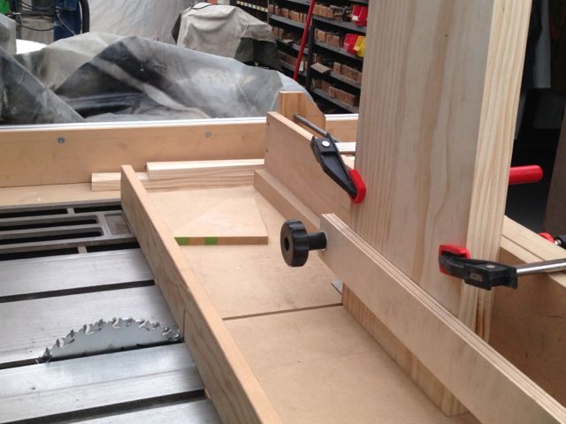

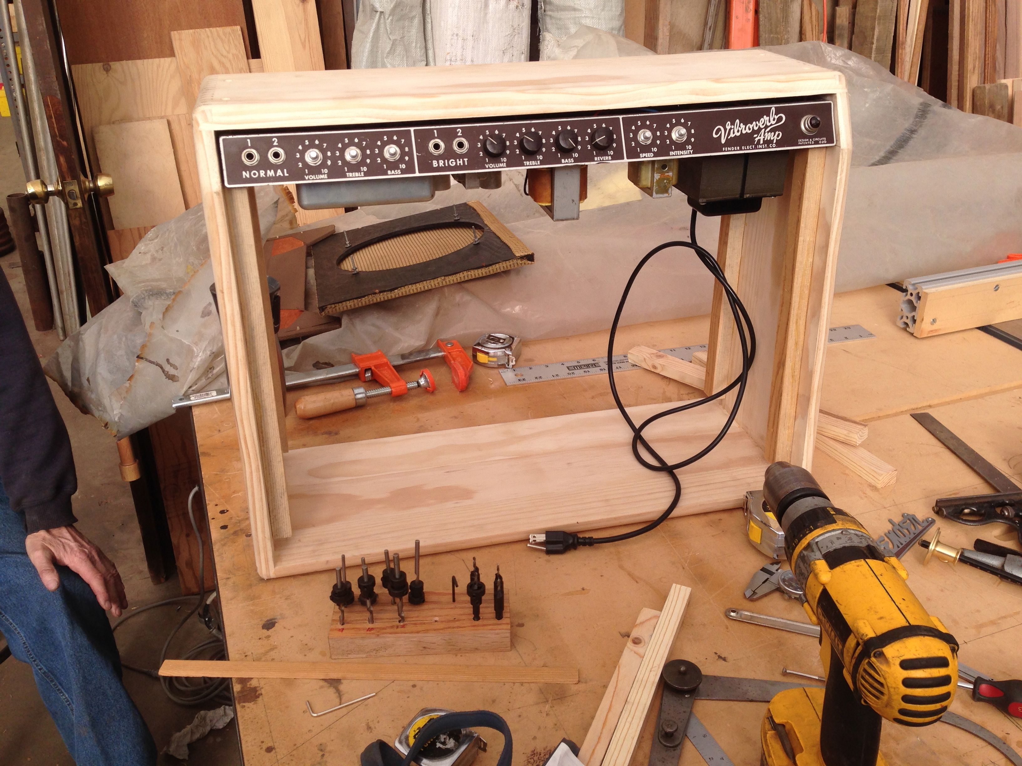

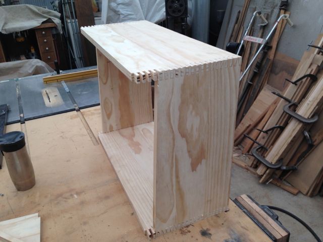

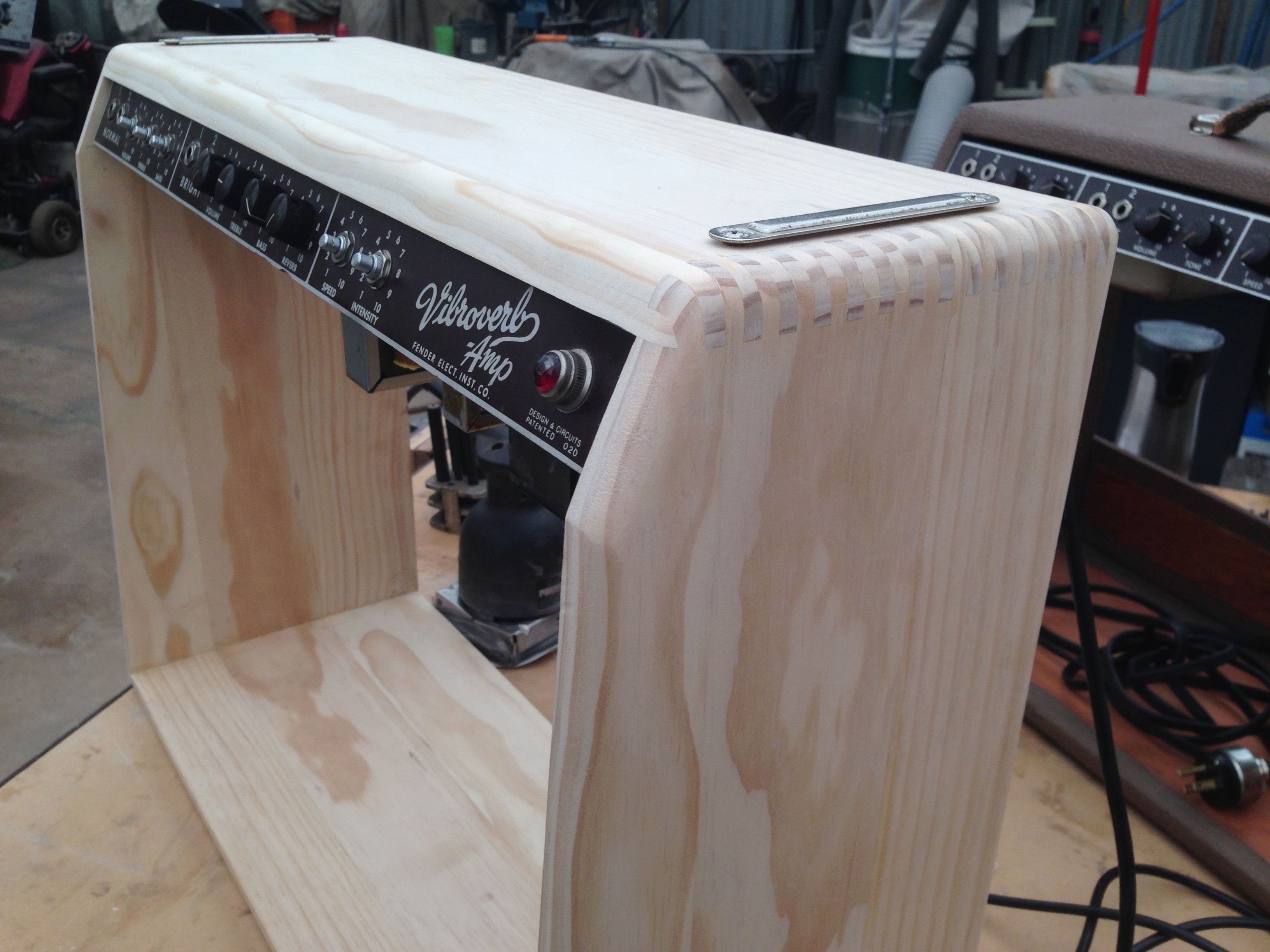

I'm building a cabinet for a 63 vibroverb.  I talked to my brother about doing it out of pine with finger joints.   He is very good with tools and researched the internet and came up with this jig for a table saw using 3/8 x 1/16 all thread.
It's so cool you clamp the boards in it and run thru the 1/4" dato blade and then turn the all thread handle 8 click/rotations and you cut 1/2" down the edge till you have completed the 1/4" finger joints. I'm so lucky to have him for a brother. He's also a drummer. We jam on sundays.
Ed Stiles is where the design of the Jig came from if anyone is interested. https://www.youtube.com/watch?v=JYxDXHGRRrk

Nice jig! Adjustable Lots fancier than mine.

This is really very cool and I like it. I'd like it even better if I had a table saw and a place to put a table saw. You can do all sorts of things with a nice table saw like that.  I know that DIY success feeling just can't be beat.
Not meaning to be critical here, but just wondering is why you'd choose to do that with the table saw. That's a seemingly huge jig for a relatively small piece. Sure, there is always more than one way to do things. My first instinct is to cut a box joint with a router. You can buy a really nice jig for about $80, maybe less. Maybe that's because I don't have a saw, and I can take my router outside to do this. And maybe you don't have a router? I'm thinking anyone with a saw like that should also have a router!

Re: Finger Joint Jig
Jerome is a machinist.  There is a router table behind another saw in the back.  On this jig, you can clamp 4 boards in place and do all sides at once if you offset 2 sides.  The size of it forces it to lock into both channels of the table saw and keeps it true.    If you have the gear why not.   He has metal lathes milling machines, drill presses, grinders planers and is a great welder.   Anyway its his thing.  He was just helping me out.   He loves building things.

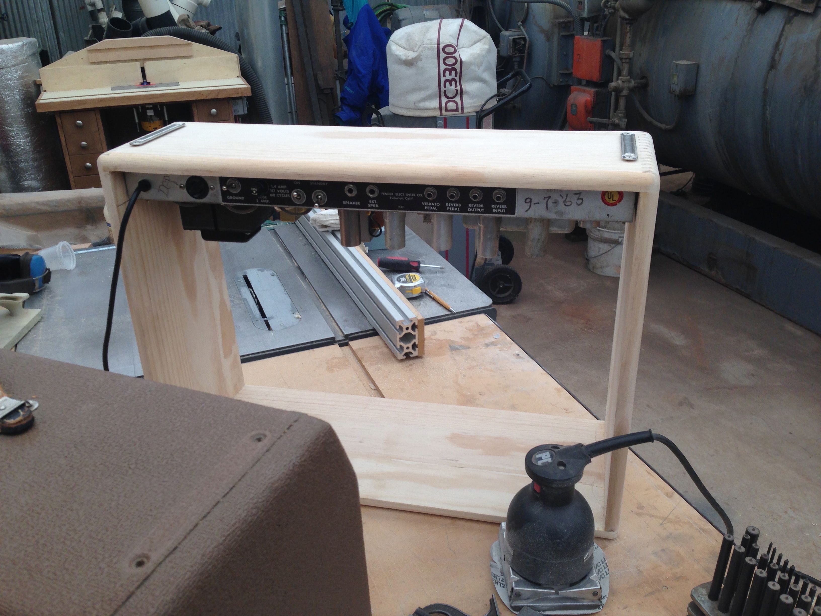

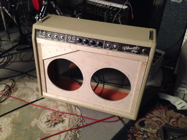

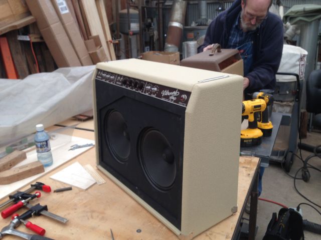

I have 2 old fender amps chassis I found in pieces. I put into head cab years ago and use with external speakers. We just decided to build pine combo cabinet for them finally. They are both vibroverbs. 1 black 1 brown.

Nice sled!

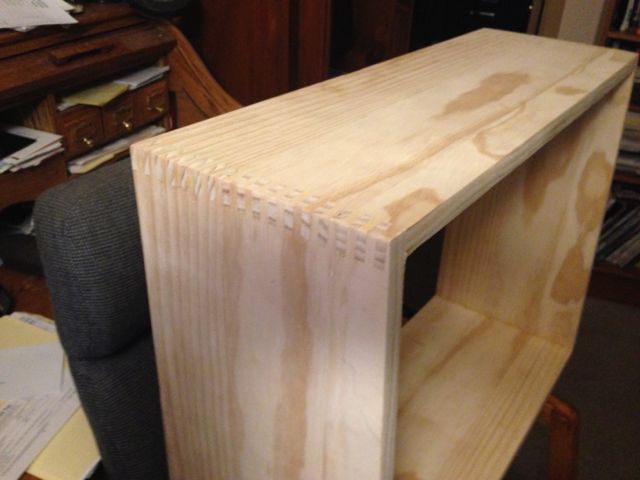

The great thing about this design is that there us no cumulative leapfrog error that can mess you up on a long joint.
On pine you have to go a little sloppy because it swells so much when you apply glue.
I hadn't realized you could do all 4 board in one pass. That makes it almost magic. I see the light!
Even the good half blind dovetail jigs only do 2 boards at a time.
Looks like a variant of "Lynn's Jig".
That's the first place I saw a threaded rod used for indexing boards to cut finger joints in all-in-one.
This one has had some cleanup and refinement from the original Lynn's version.

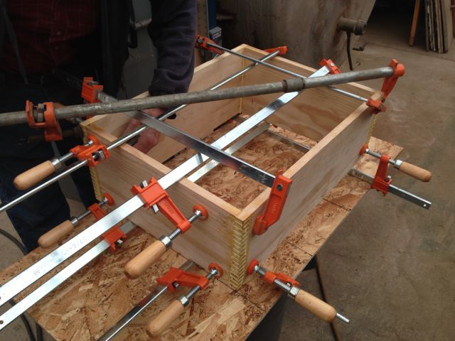

I remember reading about the joints swelling from the glue and getting tight on the TAG forum somewhere. My Brother and I each brushed the glue on an opposing edge and popped it together to keep the joints from swelling on us. It went together pretty fast and we did not have that to tight problem.PostPosted: Sun Jan 11, 2015 12:31 am Post subject:

That's a slick looking jig.  I just got the finger joint template for my router and it works great - makes perfect joints every time (after the learning curve).  I've done it with the index pin on the table saw, and I think the router is much easier and you don't get the cumulative error if you mess one up.
As someone mentioned, gluing up is the hardest part. I have tried applying glue with an old toothbrush, foam paint brush, my finger, etc., and still not happy with how time consuming it is to apply glue. It's always a race against the clock.

Naw table saw is way easier and faster once you get the  jig setup . you gots to have a decent dado blade . once your jig is made the only setup is putting on a dado and  adjusting the height.
That said I'll never build a cab with finger joints again anyway glue lock bits are the way to go. Dont have to worry about tearout and strong as fuck.Hell glue and pocket screws makes a really strong joint with minimal tools

I used a spline across 45 joints with a dato baffle in other spk cabs I have.  I used these cabs for 30 years and never had one come apart.   I just had these 2 old fenders and my mission was to build period correct pine cabs for these 2 amps.   The Jig makes it very easy to make these joints.   If my brother was not involved with his tools and skills, I'm not sure I would try buiding the box joints.
