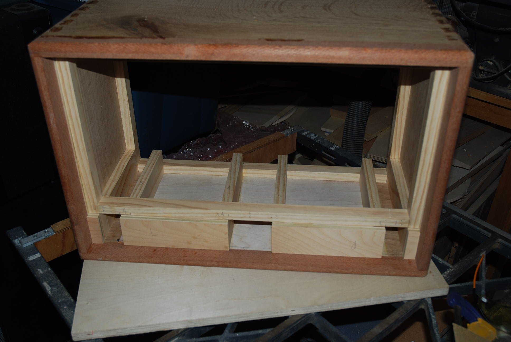

Popular or not, I built a thiele cabinet that I have used with delta pro 12A and red,white and blues drivers with various amps having results that pleases my earRCGPNY1 wrote:Also keep in mind that with few exceptions,ported enclosures have not been popular with guitarists....open back and sealed enclosures are much more common.
mat

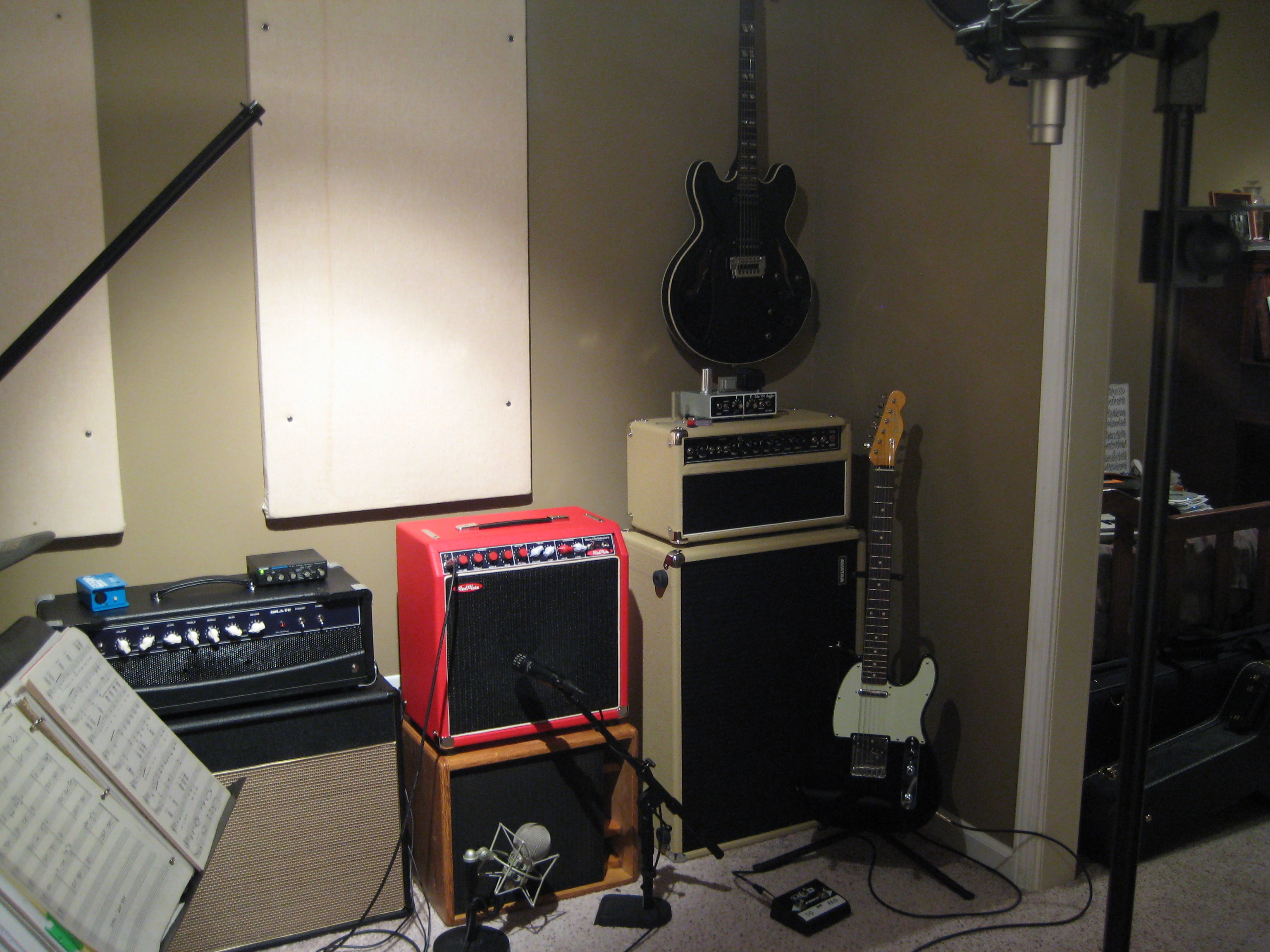

 I use my 806 with a Swamp Thang all the time, I absolutely love it!
As usual, I will be in Helsinki this summer, probably end of July/start of August, it would be great to meet up
