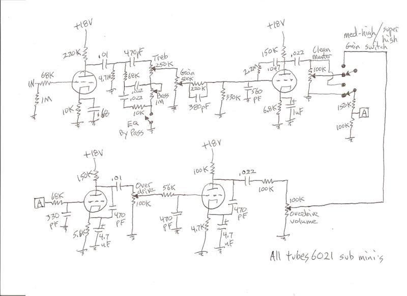

Thanks for the response.  I got the power supply issue fixed, but I have a new problem.  A schematic for reference is below (some values are slightly different).  My new problem is that the first stage works great, I send it through the caps and resistors to the grid of the next stage, but I get nothing on the plate, even if I pull out the resistor/capacitor series coupling the grid and plate.  I am not intimately familiar with the inner workings of these tubes, but I don't have any crossing leads or shorts that I can see.  Any ideas?

Not sure what I did, but I got it going.  The clean section sounds really good, I am still working on the distorted section and then tweaking is going to take me a good while.
