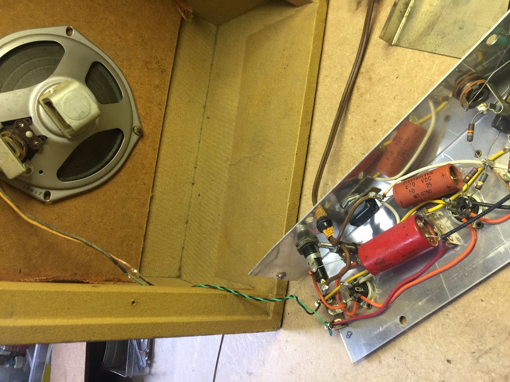

Hi, for this sort of arrangement, with an OT on the speaker directly, can I simply run wires from the tabs on the speaker to a jack (mounted on a rear panel) and use that for a larger speaker of the same impedance.
Re: Extension jack for Transformer mounted on speaker
If you run a second speaker in parallel, you will be lowering the impedance seen by the OT. You could simply disconnect the OT secondary wires from the existing speaker and connect them to a jack. Then plug whatever speaker you want into the jack.

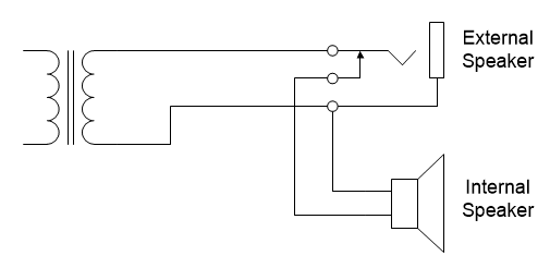

sluckey
Posts: 3528
Location: Mobile, AL
Post by sluckey »
I would use a switching jack and wire it such that with nothing plugged in the OT will be connected to the internal speaker. But as soon as you insert a plug the internal speaker is disconnected and whatever speaker is on the other end of that plug/cable will be connected to the OT.

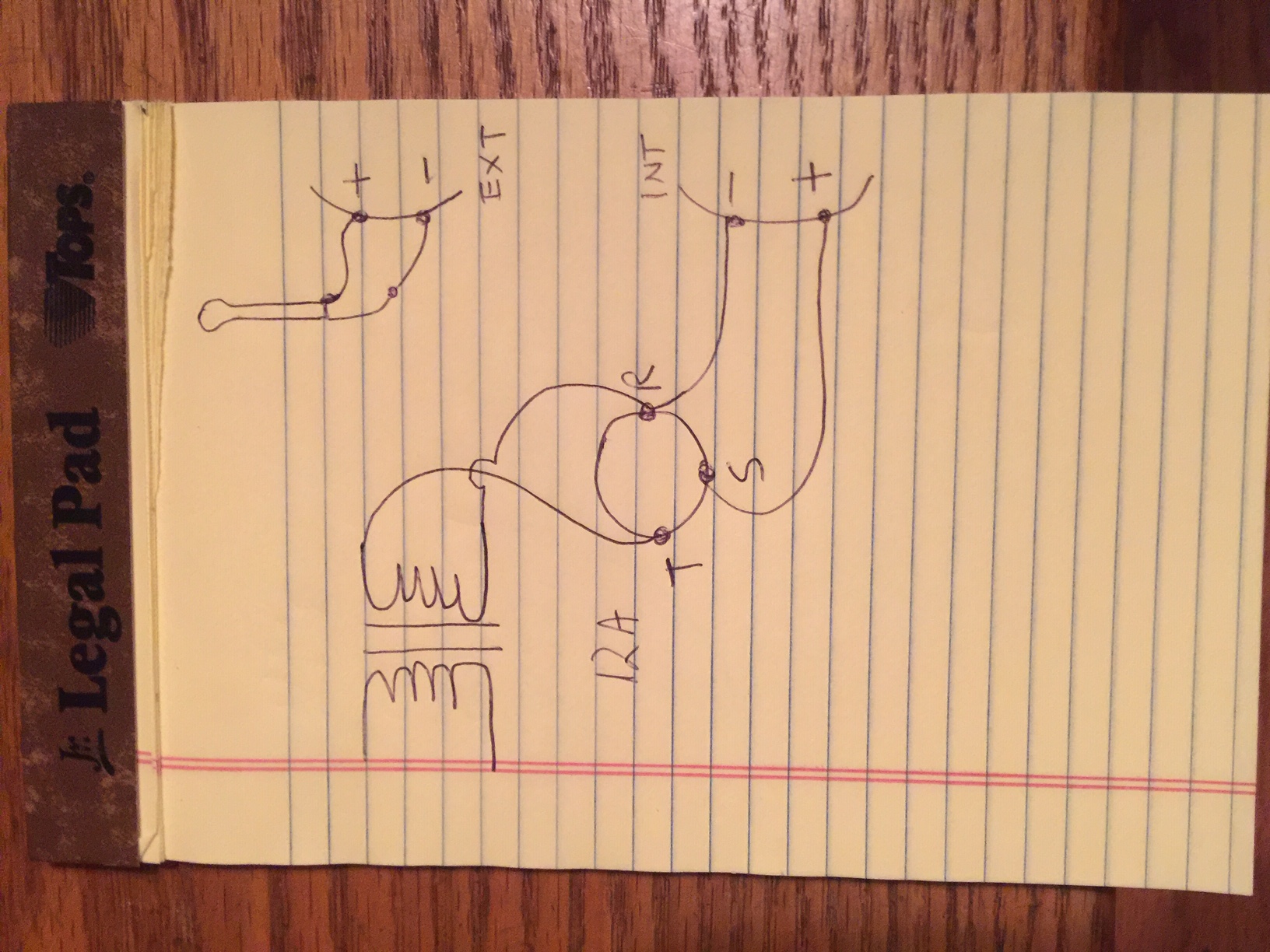

angelodp
Posts: 2157
Location: L.A.
Post by angelodp »
Steve, might you supply a quick schematic? This is for a speaker mounted transformer.
sluckey
Posts: 3528
Post by sluckey »
Makes no difference where the OT is physically mounted...
angelodp
Posts: 2157
Location: L.A.
Post by angelodp »
Re-working
sluckey
Posts: 3528
Post by sluckey »
no

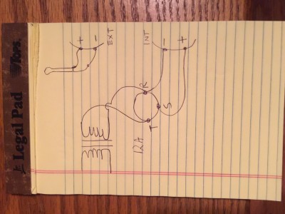

angelodp
Posts: 2157
Location: L.A.
Post by angelodp »
This? Corrected for the 12A tabs

sluckey
Posts: 3528
Post by sluckey »
Do you find your drawing easier to understand than my drawing?
Have you installed the iso transformer?
angelodp
Posts: 2157
Location: L.A.
Post by angelodp »
Your schematic is quite clear, just trying to translate to a layout.... not good? Iso Transformer is on the way.

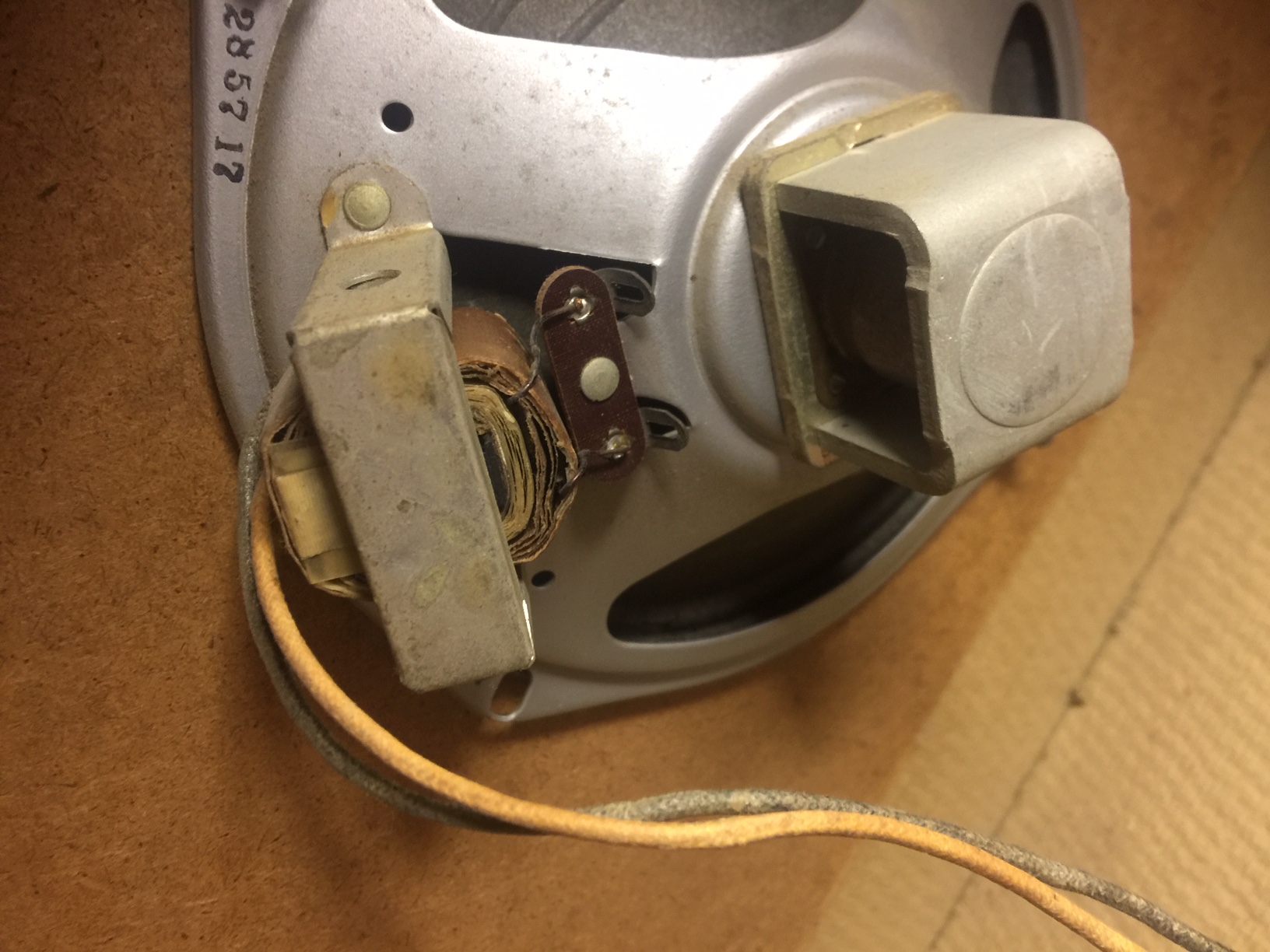

angelodp
Posts: 2157
Location: L.A.
Post by angelodp »
I am looking to confirm the impedance of this speaker and when I read the terminals I consistently get .5 ohms? Schematic calls for 8 ohm so I should be seeing about 6ohms on the meter. With the transformer mounted on the speaker, is that affecting my reading?
martin manning
Posts: 14308
Location: 39°06' N 84°30' W
Post by martin manning »
Definitely.
pdf64
Posts: 2932
Location: Staffordshire, UK
Post by pdf64 »
OT secondary is a short length of thick wire.
