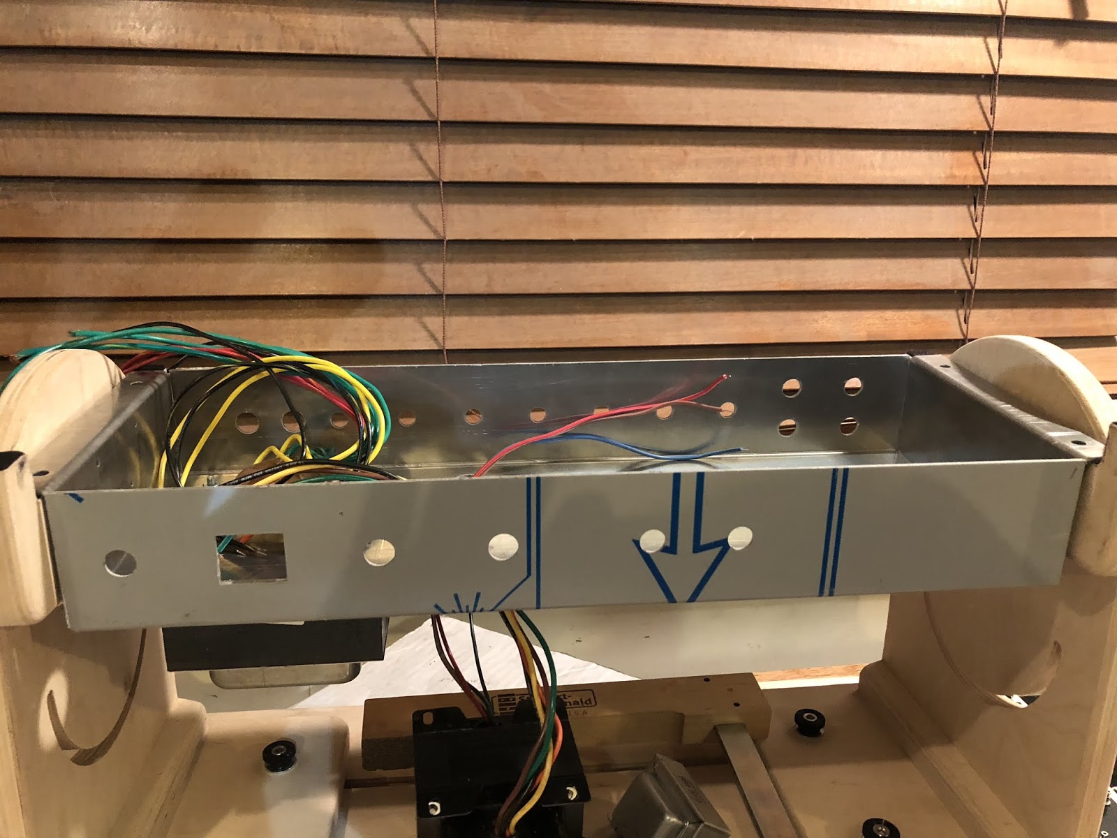

I just am loading my jtm chassis onto the bench and it is covered with a thin, outer poly laminate that has a “low noise technology “ graphic on it. I’m feeling like I should leave it unless it’s the kind of thing that tends to smell bad when the amp heats up. What say you? Keep it or tear it off?

R u talking about the thin protective film? The longer u leave it on, the more difficult it is to remove.

Remove it now for sure and spray the chassis down with a epoxy clear if you want added corrosion protection.

If I saw correctly, this chassis is made of aluminum. The "low noise" information refers to metal processing processes, but not to the noise of a device made of this material. This film must be removed. Aluminum does not rust, so there is no need for additional corrosion protection. Reliably paint the aluminum chassis is quite difficult. Aluminum has very poor adhesion with paints and necessary use active primers. The best paint option for aluminum is powder paint.

alkuz1961 wrote: Sun Jan 12, 2020 6:58 am If I saw correctly, this chassis is made of aluminum. The "low noise" information refers to metal processing processes, but not to the noise of a device made of this material. This film must be removed. Aluminum does not rust, so there is no need for additional corrosion protection. Reliably paint the aluminum chassis is quite difficult. Aluminum has very poor adhesion with paints and necessary use active primers. The best paint option for aluminum is powder paint.
statorvane wrote: Sun Jan 12, 2020 11:46 am Aluminum starts oxidizing immediately once exposed to air. There are self etching primers that will adhere very well to aluminum. Rustoleum makes one.
Thanks for the info! I took the cover off, and I think I'm going to stick with the front and back control plates for now. I must admit, though, I don't like them very much, except that they do look British.
