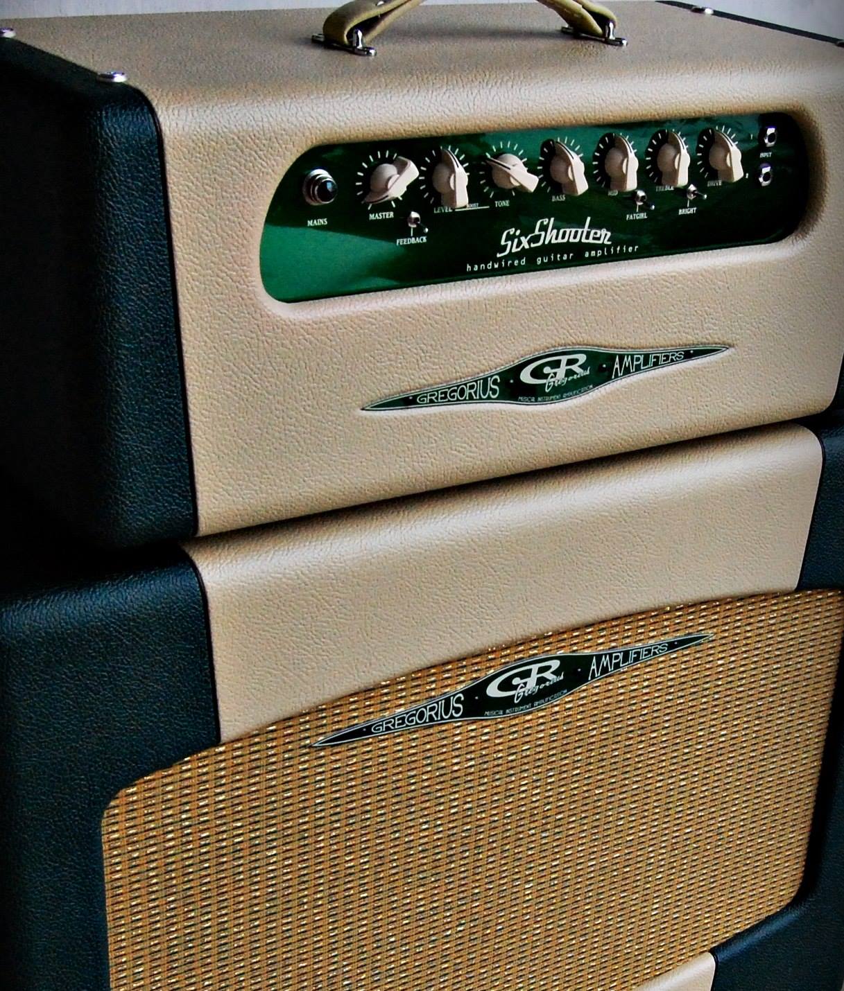

I'm looking at designs etc for my next build and came across this.
I think it's lovely and fancy having a go at something similar.
so question is: how are the corners done on these? obviously the tolex goes right across and there's no mitre or tuck in as the fronts are flush.

thanks, I've done plenty of rear panels like that, but it's the fact that the front of the speaker cab isn't covered separately it's one piece for the side and completely over the front, top and bottom. I can't see a cut/joint so I'm not sue how this has been done.
p.s. just spoke to the builder and he said a heat gun and a secret cut, it's the secret cut i cant work out :D he will send me a diag when he gets back to his home town as he's travelling at the moment.

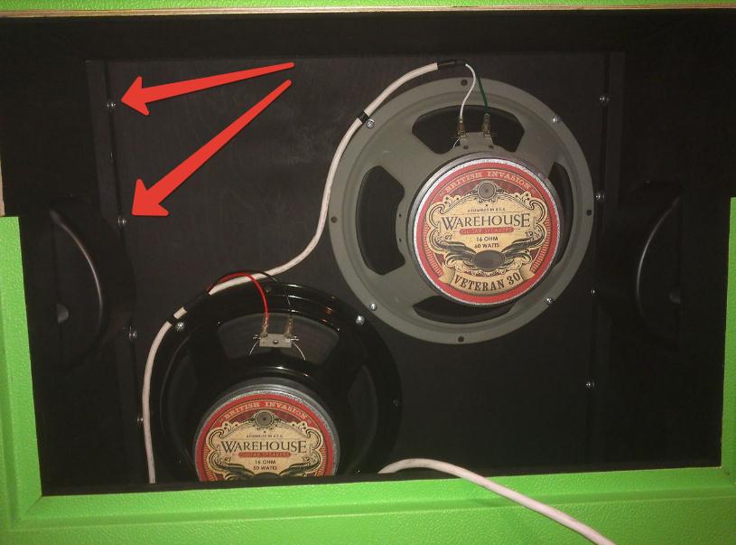

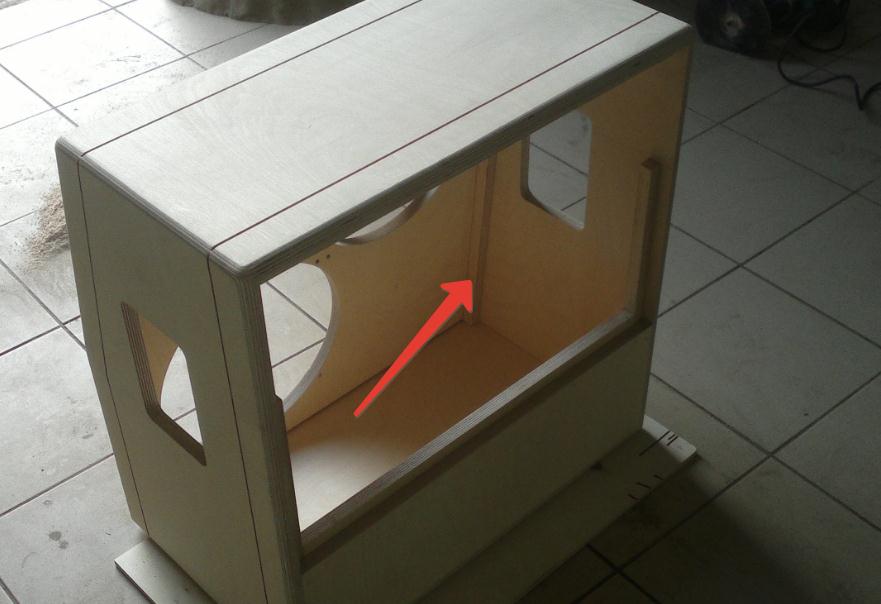

I think it's done as at the classic tweed cabinets - grill set directly on baffle. The front panel of this cabinet is thick enough, and the baffle can be fixed in it by screws or with T-nuts. Or you can use wooden bar on the sides for clamping baffle to the front panel, as was done in Marshall cabs.

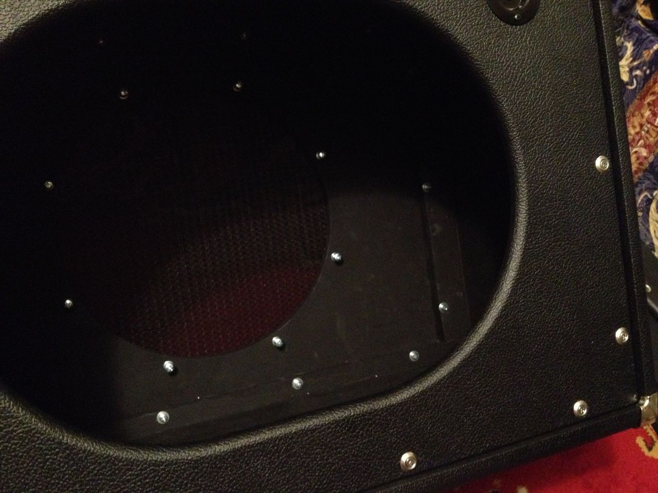

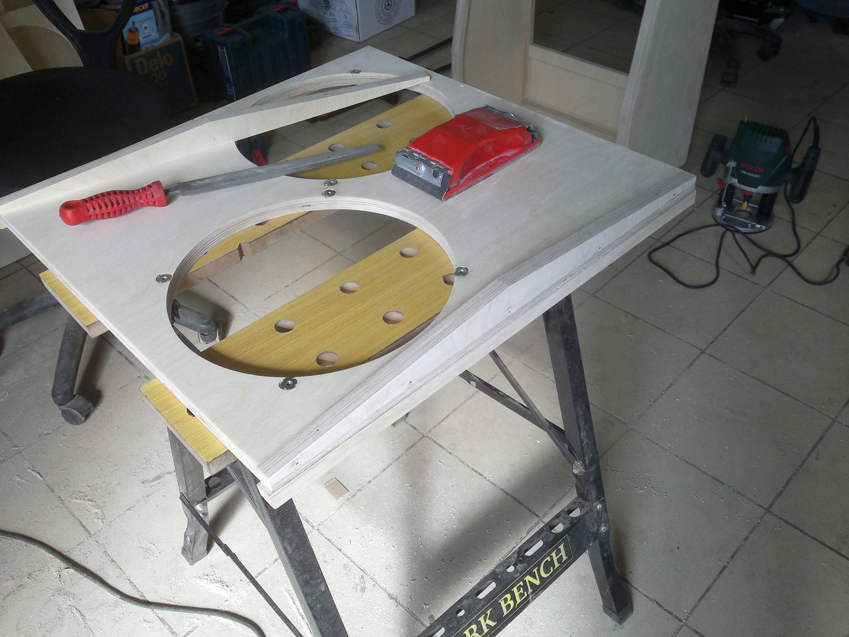

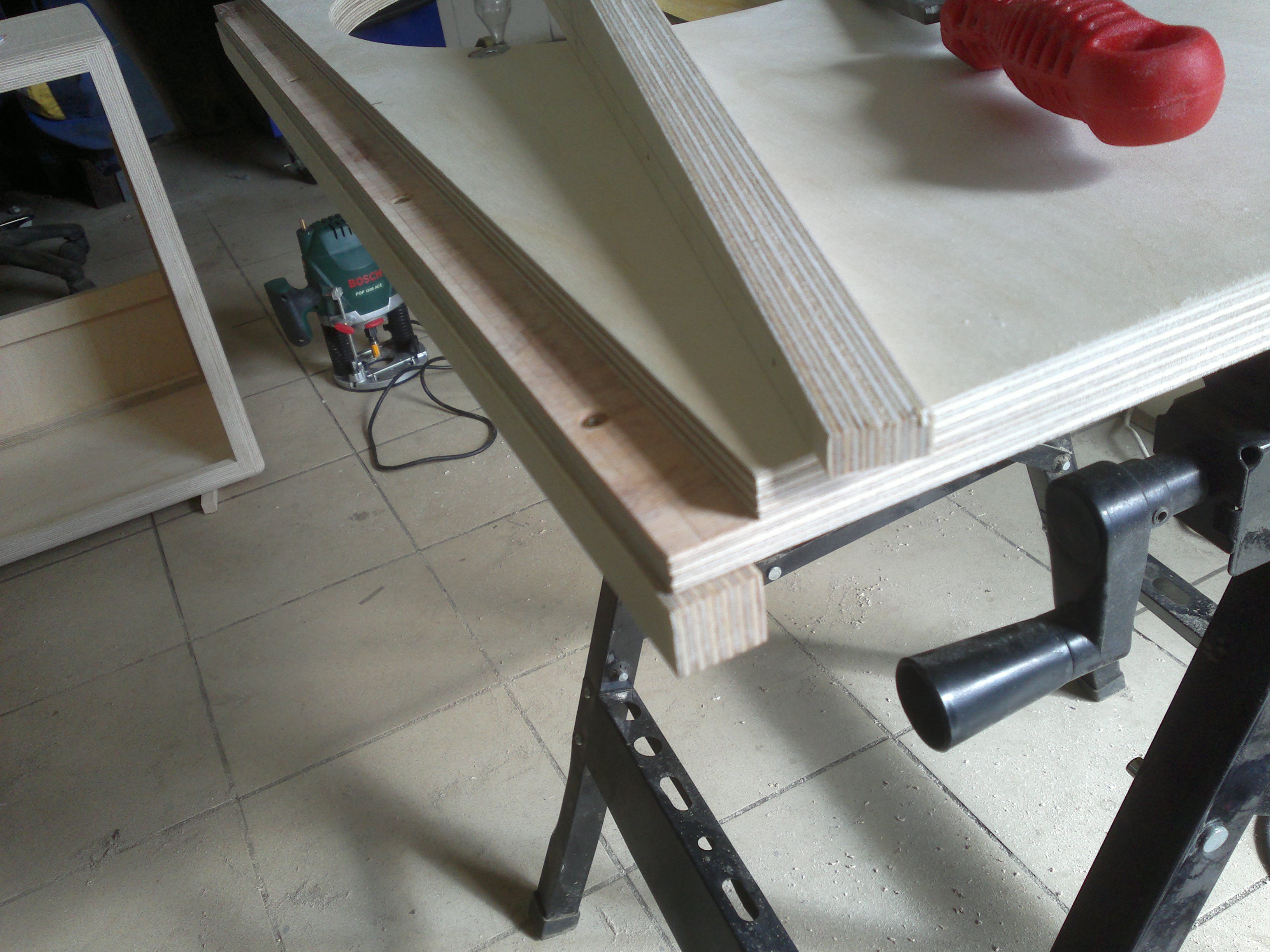

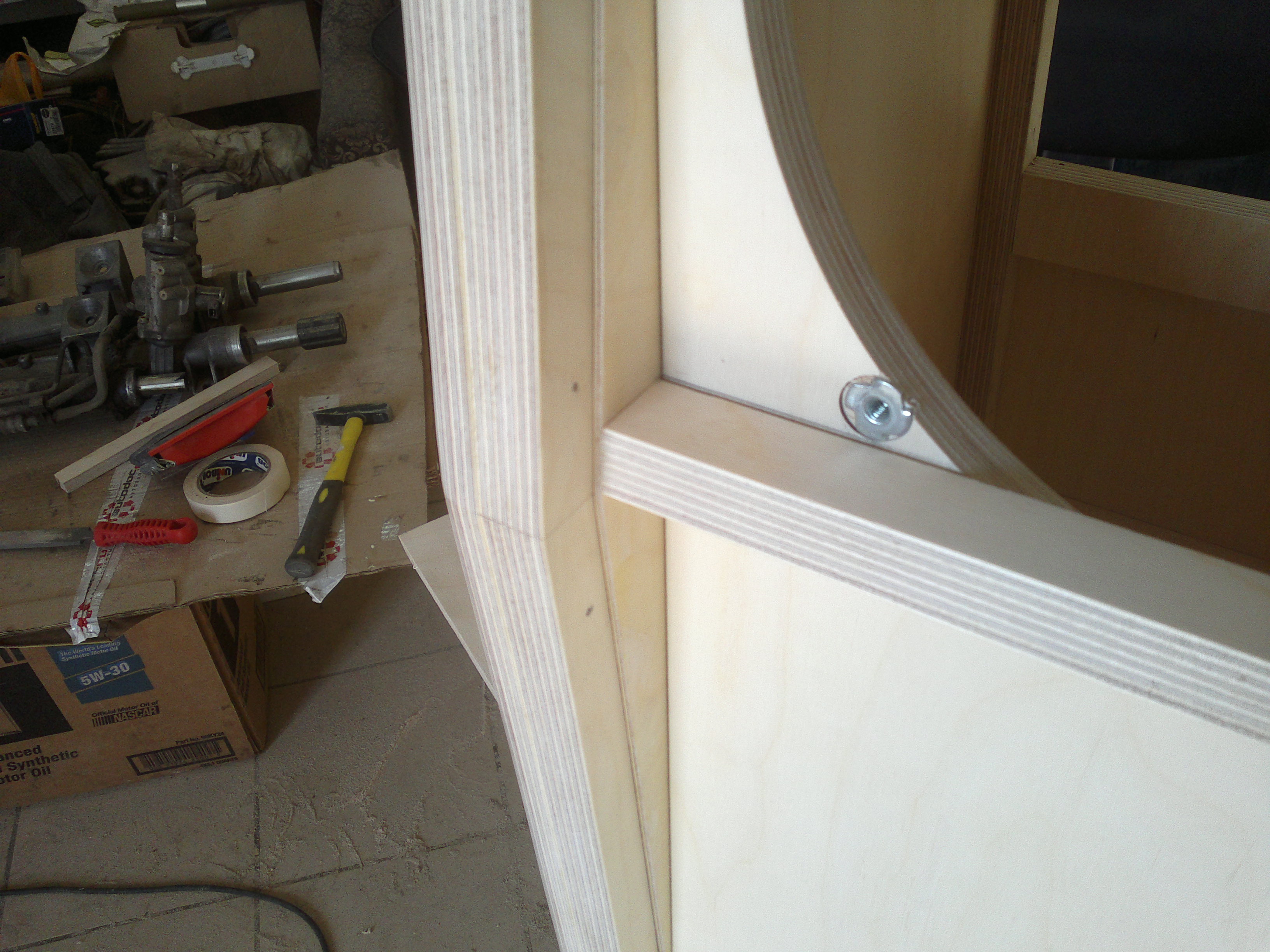

I first attached the wooden bar to the baffle with screws and glue. Then I attached bars of grille frame (if it is provided by the design, as in my pictures) and then installed the grill cloth. I must draw your attention to the fact that I fixing the grill only on the sides of the baffle. I do not bend and fix grille on the backside, therefore the sidebars do not interfere to me. I believe that this enough and many times tested this on practice. But necessary to consider in advance the width of the gap to the side walls, so that it was tight, but the grill did not prevent to put the buffle in the cabinet.
Next I just press the baffle to the front and tighten the screws to the side panels, as I showed in the photo in the previous post
I apologize for the not perfect pictures, but I hope this will help to understand all processes.
