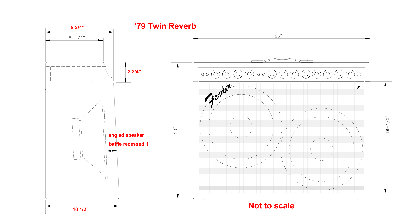

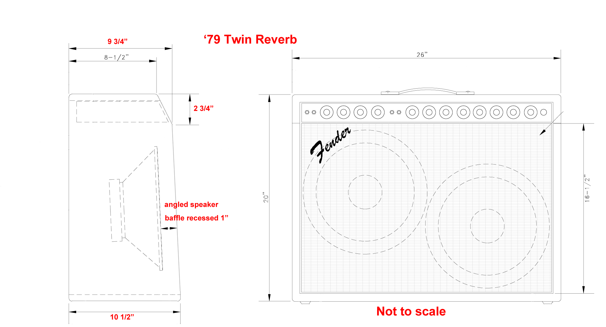

Got a couple of Twin reverb plans.
Added Vibroverb incase that is same size as SuperReverb?
TwinReverbCab.pdf
(69.48 KiB) Downloaded 595 times
vibroverb clone cab.pdf
(8.4 KiB) Downloaded 338 times
