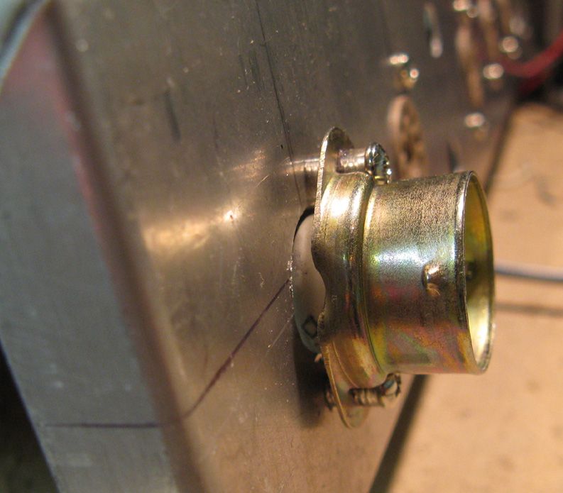

Isolated the input pentode with some silicone tubing, hope it works.
