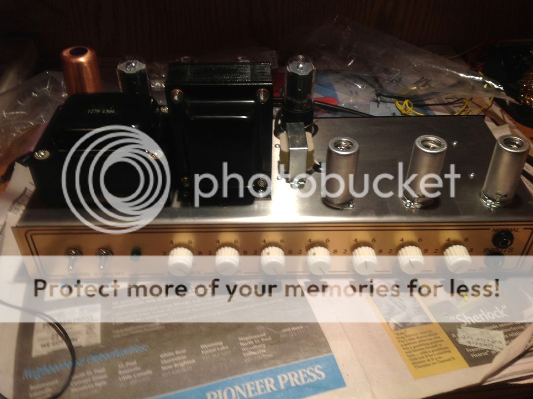

Hello everyone. I'm new to the forum, I've read a lot here and I finally decided to jump in. I'm a player, small time collector and electronics hobbyist. (Im a radio amateur, Extra Class. My nerdiness knows no limits)
I built my first ever guitar amp. I started on April fools day and lit her up four days later. It worked! I had no step by step, just followed the schematic and layout for a Weber Natalie kit. It's basically a JMP 4 holer without the low sensitivity inputs, an added PPIMV and running four 6v6s.
[IMG:936:699]http://i463.photobucket.com/albums/qq35 ... 6b4238.jpg[/img]
[IMG:1051:786]http://i463.photobucket.com/albums/qq35 ... b92a68.jpg[/img]
I'm liking it, but I have . a minor problem that I hope you can help with. ?!?! Please!

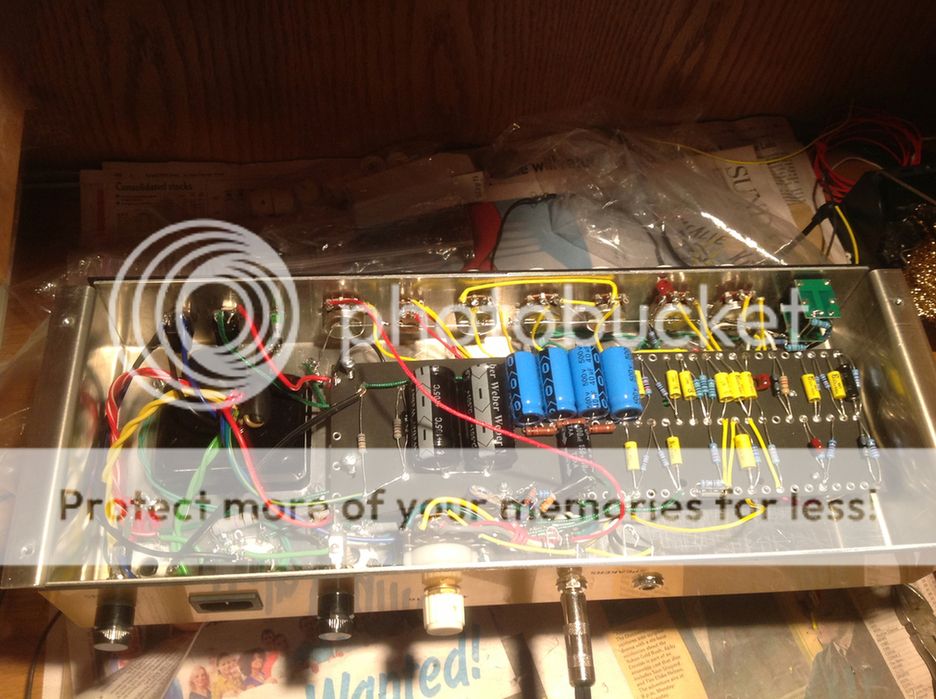

I think these things are all related, bt I'm not sure so I will list them.
The presence control oscillates when cranked up. It's more sensitive at higher loudness levels. Moving leads around improves it, but doesn't fix it.
Although not necessarily a problem, my ppimv is not shielded. The layout did not call for it, and I don't know if its causing problems.
The treble control is HOSED UP! It works fine either on zero or ten, but anywhere in the middle and loudness goes down and a low level distorted sound is there behind the regular sound. IT'S HORRIBLE! This ONE thing is driving me crazy! I've spent about 5 days trying to figure it out.
Anyone have any ideas on the treble thing? Could it be caused by feedback oscillations? As long as the treble is full up or down and the presence is less than full,mother amp sounds great! It seems weird that the treble would work full up if its an oscillation issue. The schematic and layout are here, in case anyone wants to look....maybe its a layout mistake?

The Presence circuit is part of the negative feedback (NFB) loop. Howling feedback is a common issue, easily fixed by swapping your output primaries (usually blue and brown, confirmed in the schematic).
This may solve your treble control issue. But if it does not, check the tone stack wiring again. Then check it again. Then post closeups.

Moving the leads around suggests the issue with howling might be due to the long red lead coming off the presence knob. I would suggest running it under the filter cap board and shortening it so its no longer than it needs to be. Keeping the leads short helps prevent feedback loops from occurring between the various stages.

The red lead is hanging above the board as a test. It was below the filter and it was bad. Getting it well above and away helped the oscillations a lot. I'll figure out how to finalize it after I gt the treble issue solved.
Re: New user, first build, almost works!
Twist your red pairs of wire on MV together and same for yellow pairs on MV to reduce noise. Shielded wire is normally used but twisting should help.
Can't tell from photo is third lug on mid pot is going to ground.

Having all of you preamp tubes so close to the bottom of the board and the pots maybe a source of the oscillations?
Checking the install of all your coupling and bypass caps so that the out bound lead is feeding the signal on down stream might be the fix also.

Stevem wrote:Having all of you preamp tubes so close to the bottom of the board and the pots maybe a source of the oscillations?
I don't think so. I've build three 50-watt plexis (1987 circuit) using this 6xM chassis with tubes in the locations you see. No problems. I like this chassis a lot.
