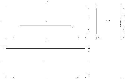

I have these plans although not for Marshall but similar that you can adapt.
- Attachments
- head_cabinet_511.pdf
- (34.27 KiB) Downloaded 564 times

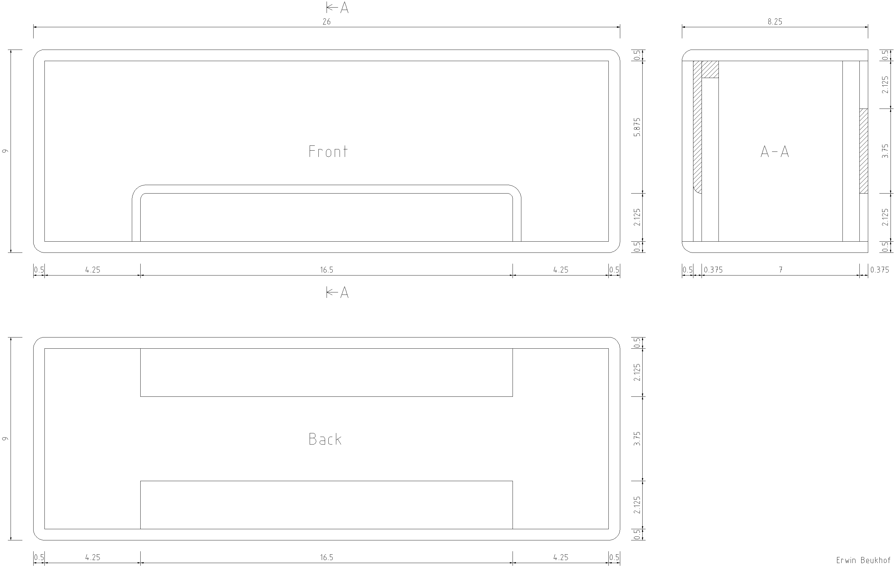

Only have small box drawing and 2205 open bottom style.
- Attachments
- 2205HeadBoxBB.pdf
- (21.46 KiB) Downloaded 278 times
