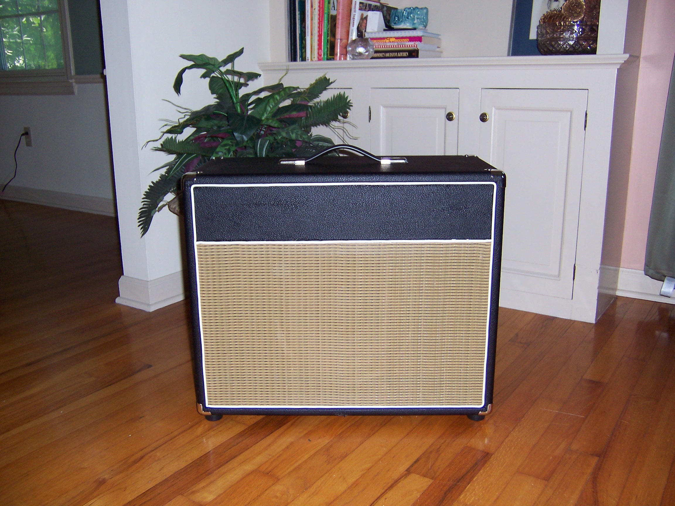

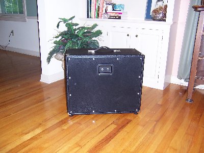

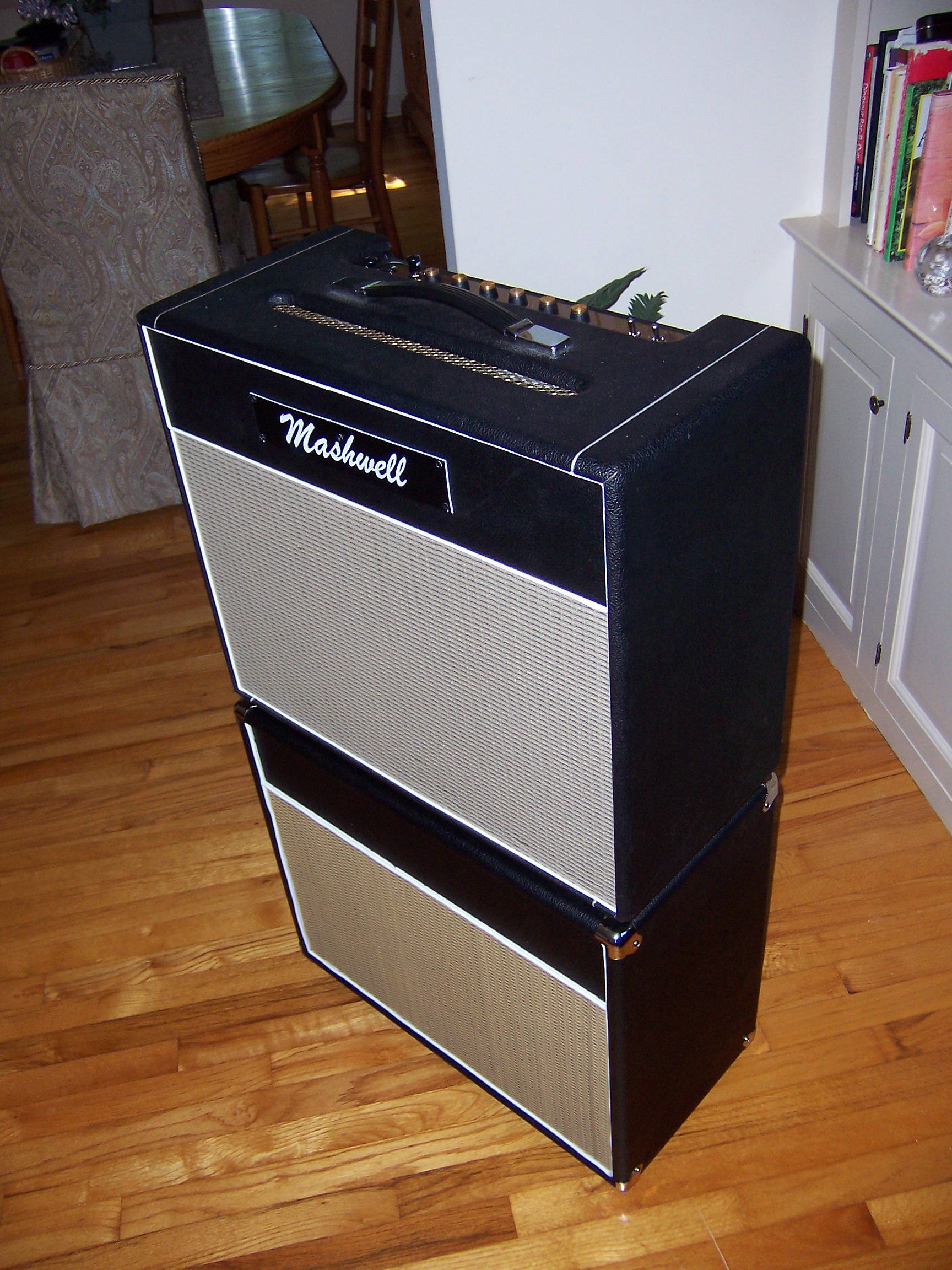

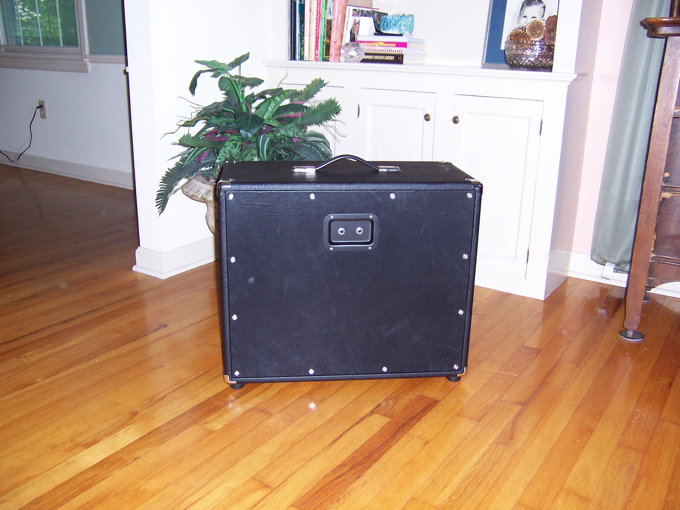

I picked up a raw cab on eBay, and dressed it in tolex, white piping, and wheat grill cloth. Not perfect, but hey .... it's only rock-n-roll.
EVM12L speaker in each cab.
JTM45 combo w/ KT66 output tubes

Fingers X-ed the baffle can take the EV and that the backboard is not in too close a proximity of the speaker, seeing it's closed back.
NickC
Posts: 1814
Location: Upstate New York
Re: Bluesbreaker Style Cab
Post by NickC »
solitaire wrote:Fingers X-ed the baffle can take the EV and that the backboard is not in too close a proximity of the speaker, seeing it's closed back.
The baffle and backboard are 1/2" baltic birch ply. Depth of cabinet is 10.5", which is 1" deeper than the present day Marshall Bluesbreaker RI combo amp cab. The construction is very solid.
It sounds good at low volume. No rattles, and not boomy. Haven't had a chance to really crank it up yet.
If it booms you can try a stressed brace from back of magnet to cab back.
Similar to the 4x12 brace.
