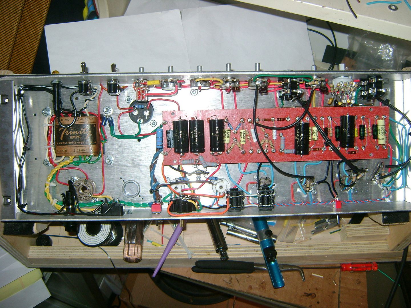

Re: Anyone with experience of the Trinity amps TC-15?
I've built a few TC-15s, they're great amps. Sort of half of a DC-30. Not a lot of clean on tap unless you're using single coils - I have found my London build to have a bit more clean in the EF86 channel. The TC-15 EF86 channels definitely has more grind. Everything's tweakable of course, but I keep both for different applications. The TC-15 12ax7 channel isn't really marshall, but with a few tweaks it can be. There are a few posts in their forum on how to take it into more of a marshall territory.
Here is my last TC-15 build
1359]http://i13.photobucket.com/albums/a264/ ... C03600.jpg[/img]
