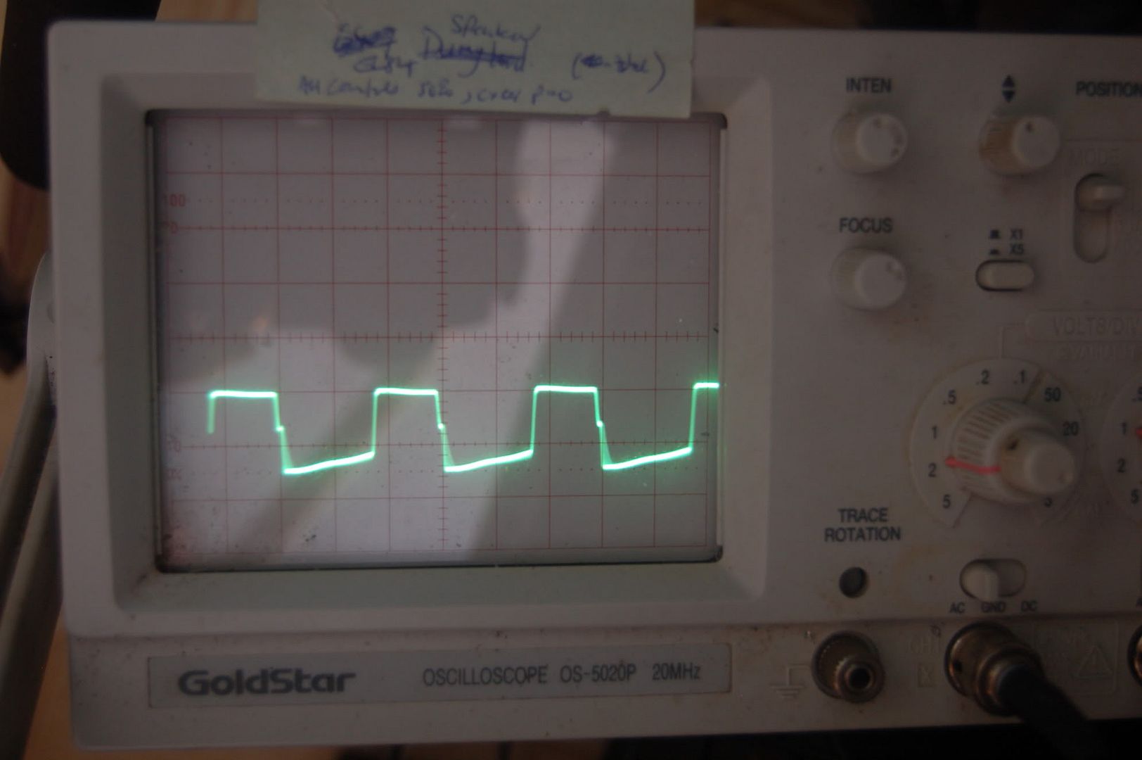

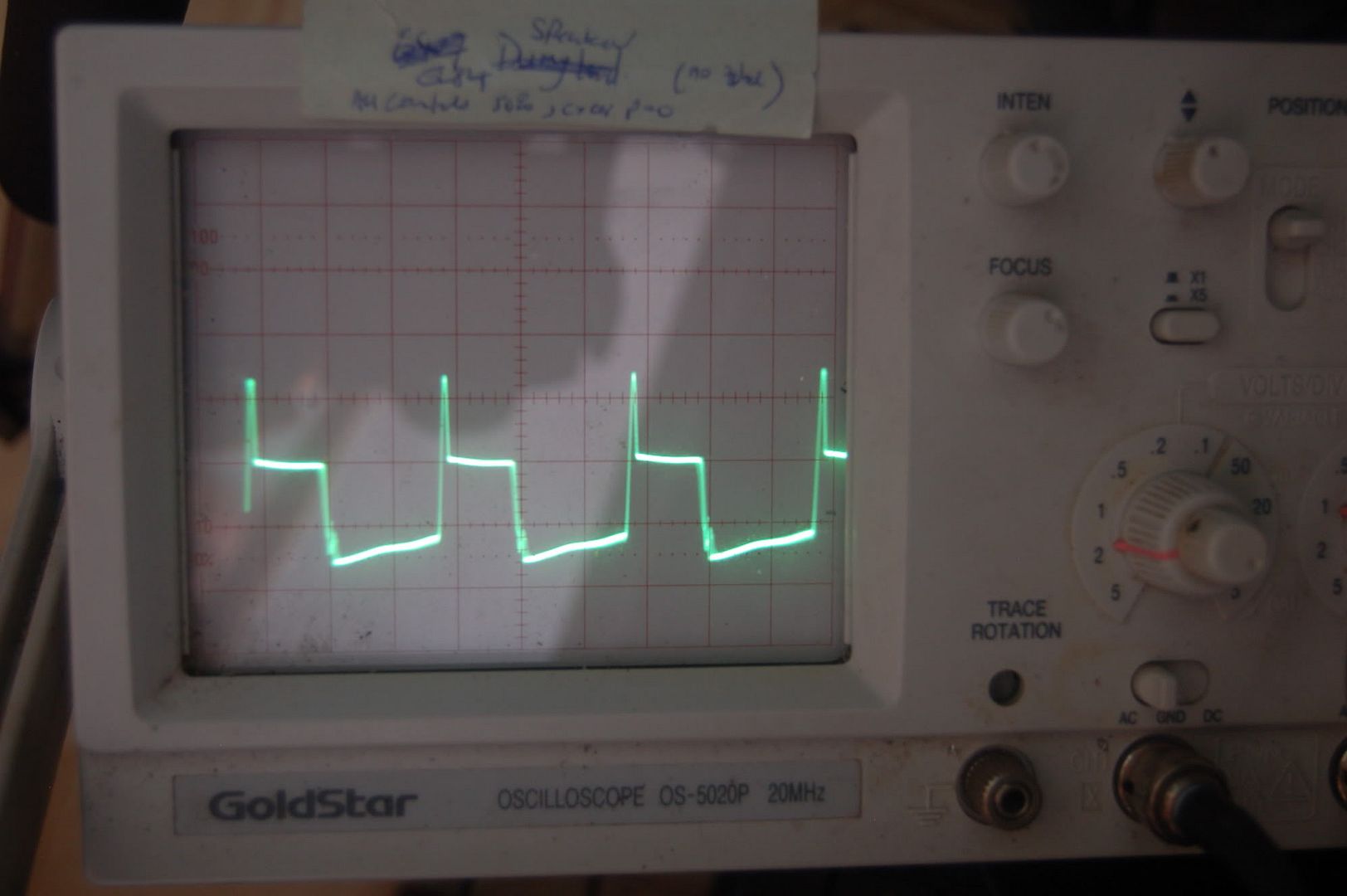

I have played with similar R-C networks on the secondary of the OT in an Express style circuit (a bastardised 4-4-0 with EL84 power section).
I was successful in getting rid of a nasty fizz, but in this case, the problem was clearly visible on the 'scope as a nasty spike on the output waveform. Note that it only showed up when driving a speaker. When driving a resistive dummy load, there was nothing to see.
Before:
1326]http://i255.photobucket.com/albums/hh14 ... C_9841.jpg[/img]
I tuned this out with a switched R/C network, and as the spike reduced, the tone got better. I ended up with 56R & 2u2 in series across the 16 ohm tap of the Hammond 125E OT (I had the OT wired for 10K:8 ratio). I found the values quite critical, though, so I would be wary of any 'cookie cutter' type solutions.
After:
1322]http://i255.photobucket.com/albums/hh14 ... C_9844.jpg[/img]
I figured this was only needed because of the mediocre quality of the OT.
My network has a cross-over frequency of ~1.2kHz with an equivalent impedance of ~70k ohm in parallel with the OT primary (if my maths is correct). The one in your link has a cross-over frequency of ~2.6 kHz with an impedance of ~6k in parallel with the OT primary, which seems quite a heavy load.
I don't know if it will help you, though.
I've also played a lot with the balance between the PI and the power section - the transition from clean to distorted can be really abrupt if the PI gain / output swing is high.
IMHO, the distortion flips on in an Express when the NFB breaks down due to grid conduction in the power section. The extent to which the power valves get over-driven then immediately depends on the available PI headroom when this happens. Again IMHO, I think 'tuning' involves trying to get this to happen just as the PI is starting to compress, too.
You might try swapping the PI for a lower gain valve (not necessarily a different type), or maybe getting the PI B+ down a little, or find some 'harder to drive' power valves.
I'm not an expert by any stretch, so take the above with a pinch of salt.
Andy
