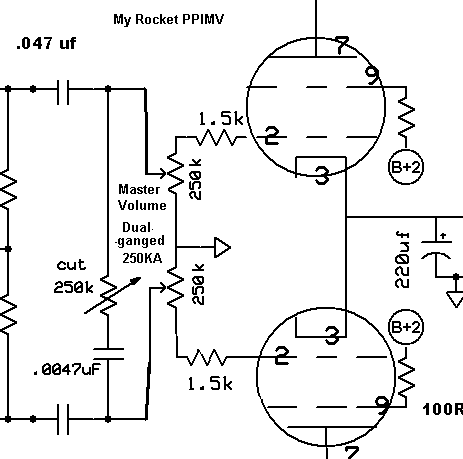

Anybody try one? I'm itching to swap the 220Ks with a dual pot. How about a cross-line(?) MV, ala Matchless Spitfire/AC30?

dynaman - Just checking in to your post. Yes, I have installed the LarMar type PPIMV into 3 Rockets at this point and find that it works very well. The Matchless type MV is different, but also works well from my experience. If I hadn't run into the LarMar MV I would have tried the typical Matchless type MV.
I think the thing to consider is that - considering the sonic results - all MVs tend to sound 'best' when engaged slightly. Which is to say the sound we love is very typically the speakers getting beat up. Last comment by me is that the LarMAr type MV sounds better on any setting than the Airbrake.

Like I said in the other thread, the PPIMV mentioned above works very well with the Rocket. TBH I even like it at extreme attenuation settings, it's relatively transparent even at super low volumes. But I use an SRO which doesn't have much speaker distortion to speak of, something to take into consideration.

Ok, cool. I'm gonna try the PPIMV first.

Short of an attenuator or power scaling, the LarMar should be the best type of master you can get on an AC30 or Rocket.  It should work even better than on Marshalls because you won't get the NFB loop collapsing at low output levels and should retain the tone, subject to power tube distortion/linearity right down to the lowest levels.

what exactly is meant by "larmar"?paulster wrote:Short of an attenuator or power scaling, the LarMar should be the best type of master you can get on an AC30 or Rocket. It should work even better than on Marshalls because you won't get the NFB loop collapsing at low output levels and should retain the tone, subject to power tube distortion/linearity right down to the lowest levels.

A few years ago Larry "Novosibir" and Mark "Rockstah" tweaked one of the PPIMV master volumes from the "Trainwreck" pages over on the Metro amp forum - for Marshalls mostly.  This turned into a gazillion page thread and their two names were mashed together making it a LarMar master.
IIRC, KOC has something similar in his TUT book released in the 90's, back in the days before internet to the masses.....
Re: PPIMV in Rocket?
That's about as succinct a summary as you can come up with. It's an improvement on a Ken Fischer design, so it's kind of apt to see it being used on a Rocket!

Another "+" for the PPIMV.paulster wrote:Short of an attenuator or power scaling, the LarMar should be the best type of master you can get on an AC30 or Rocket. It should work even better than on Marshalls because you won't get the NFB loop collapsing at low output levels and should retain the tone, subject to power tube distortion/linearity right down to the lowest levels.
