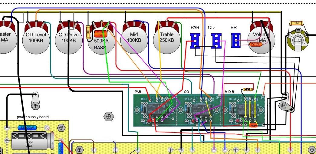

on the mid-boost fun
Post by angelodp »
Henry, on that thought about the
If you have the mid boost on a relay, a fun option is to also switch your .047 mid cap with a .01 on the other set of relay contacts.
I used to be a fan of 185V on V1A (100k plate) but lately I like 200 - 210 for the nice leading edge "ping" of brightness.
can i implement that here.
ange
