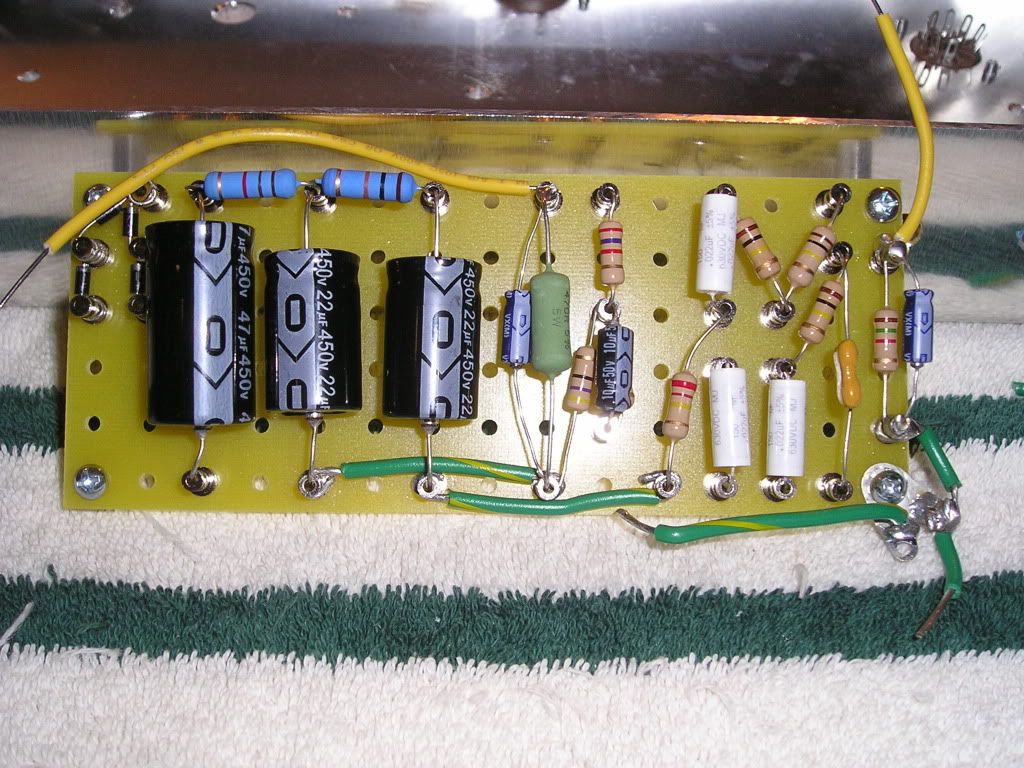

Hey Guys,
I got my board loaded and was wondering if I can get a set of eyes to see if I made any mistakes.
There dry mounted right now. I don't have all my leads on it yet... but that will me next.
Also on the white coupling caps, I don't know if there orientated correctly. I did'nt see any way of telling which side is - & + or does it matter?
Also I still need to bridge the 2 coupling caps together and the 2 100k resistors and the 47uf cap to the diods. I got a piece of buss wire and was wondering if I should use that or just use the leads from the caps and resistors and bridge them from the under side.
Sorry for all the questions.
Thanks.
[im[IMG 768]http://i443.photobucket.com/albums/qq15 ... 010938.jpg[/img]g][/img]
Thanks.
[im[IMG

So far so good dude...

Hey, Thanks alot surf.surfsup wrote:So far so good dude...

Film caps (the white ones) are non polarized, meaing they don't have a + or -
But many of us like to put the foil end of the cap towards the lower impedance side of the circuit.
It is believed to lower the noise floor.
Here is some talk about it and how to detect the foil side.
https://tubeamparchive.com/viewtopic.ph ... light=foil

blues junkie,
Your on a good start, take carefully slow and most of all-enjoy the experience.

Hey Guys, thanks for all the input.
Structo, Thanks for the link. I now understand how to position the non polorized caps.
I did the input jack with leads plugged into the amp trick to try to figure out the + & - side of the cap... but I could'nt tell any difference. so I guess I will assmble it as is and hope it is correct.
Anyways again thanks for everyone's help.
  so I guess I will assmble it as is and hope it is correct.Anyways again thanks for everyone's help.
