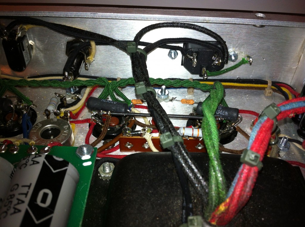

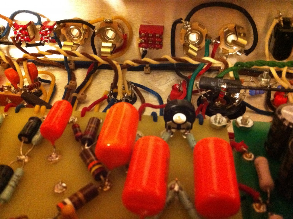

I went back and looked at your pictures.
It's hard to tell depth but the heater wires over your power tubes look like they are up against the screen resistors.
Re-check all your heater wiring dress and make sure it is up and away from everything else.
Also, when you recorded the hum, did you have a guitar plugged in?

I'm pretty sure I tried moving the power tube heaters further back, but with no audible reduction in hum. I'll give it another shot tonight. I'm not sure if the guitar was plugged in or not, but the amp makes the exact same sound with it plugged or unplugged.Structo wrote:I went back and looked at your pictures.

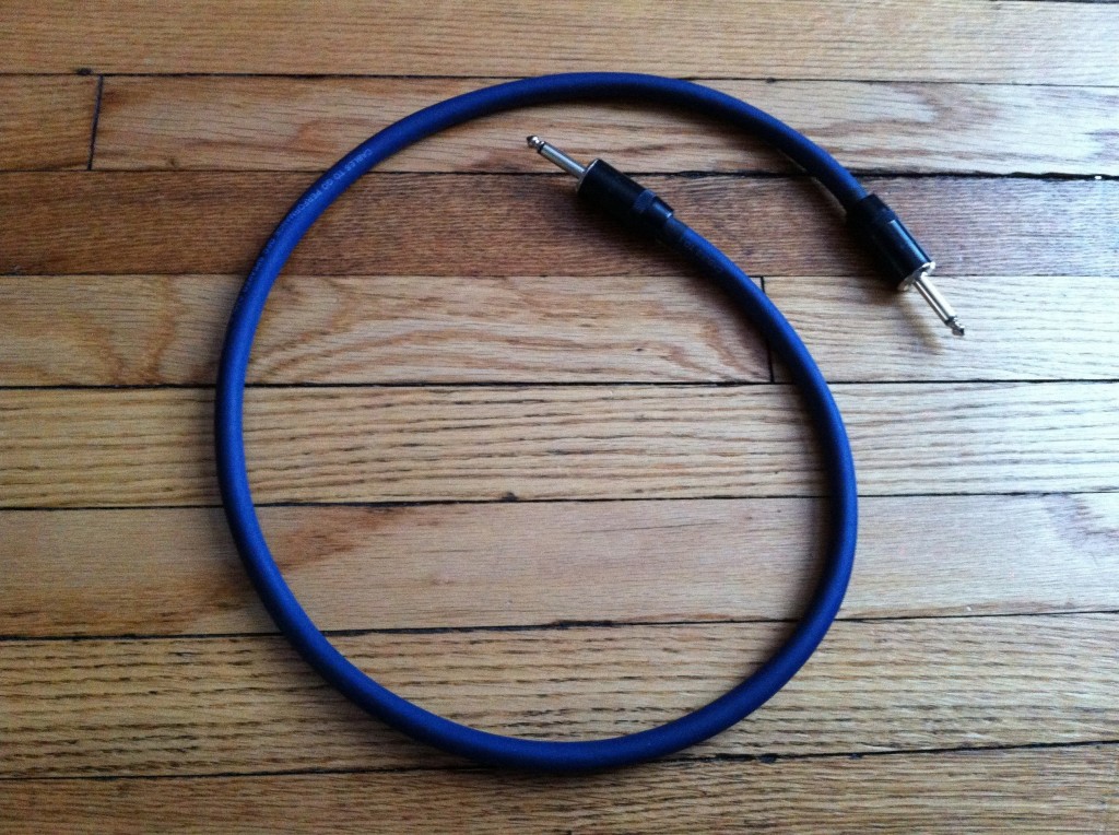

I know this seems crazy but, have you checked your speaker cable? I've had a Cord that drove me nuts trying to find this just audible hum. It turned out it was a bad connection from the factory. Since then I've switched to using George l's Speaker cable ends and either thick 18 awg Copper braided "Lamp Cord", or I really dig Evidence Audio Lyric cable. And I put them together myself, no solder, great connection. Better to check it out now, just incase.aflynt wrote:I'm pretty sure I tried moving the power tube heaters further back, but with no audible reduction in hum. I'll give it another shot tonight. I'm not sure if the guitar was plugged in or not, but the amp makes the exact same sound with it plugged or unplugged.Structo wrote:I went back and looked at your pictures.

Interesting. I'll try some different speaker cables. I didn't realize George Ls made them. I'm using some that I put together using Neutrik ends and some 12 gauge wire I bought off Amazon.

Re: YAOB (yet another one-zero-two build)

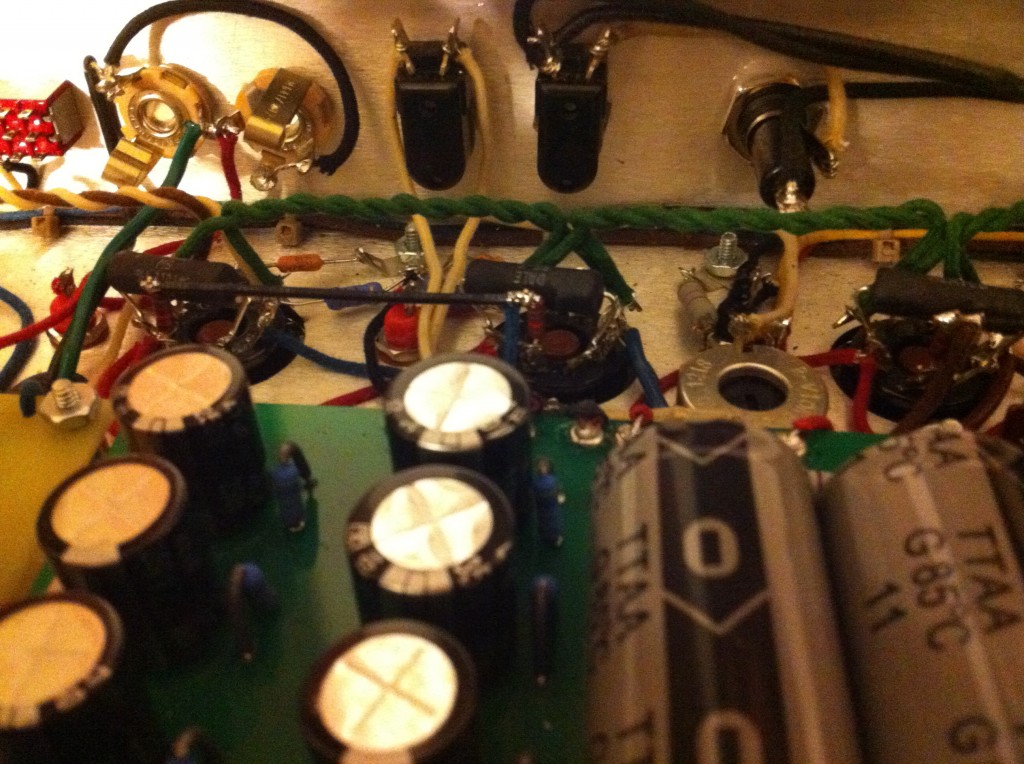

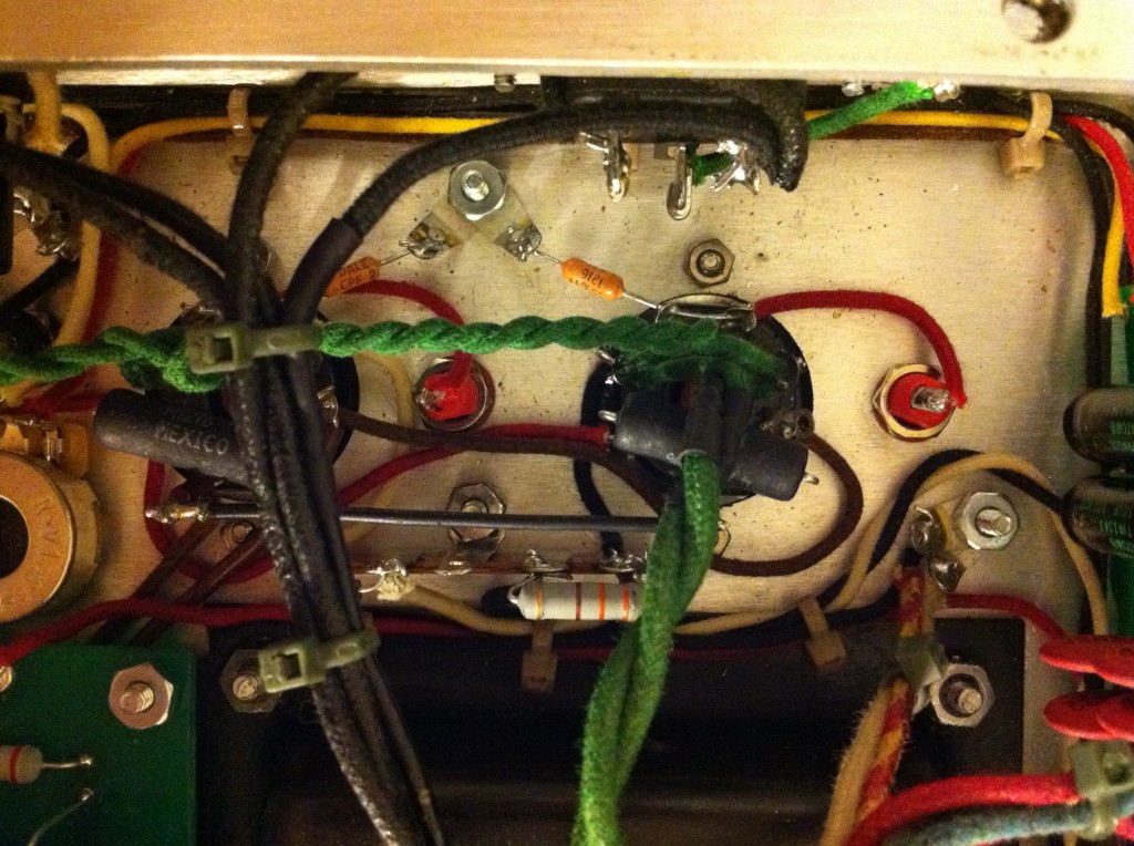

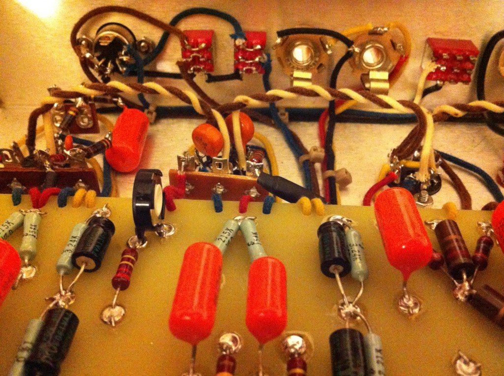

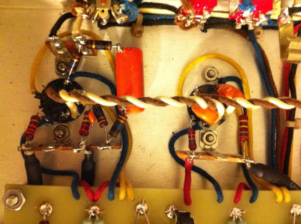

Here are some more detailed pictures of the heaters.
[img 764]http://www.aaronflynt.com/wp-content/up ... 24x764.jpg[/img]
-Aaron
You might also double check your power tube heaters. With them being both green, it would be easy to accidently wire them out of phase....worth a quick look.
If the hum disappears with the PI tube pulled then it can't be coming from the power tubes.  I don't like the look of the heater wires running up against the snubber caps on V2.  Can you bend the caps out to put some distance between them and the heater wires?
