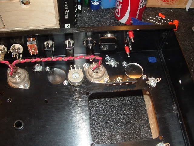

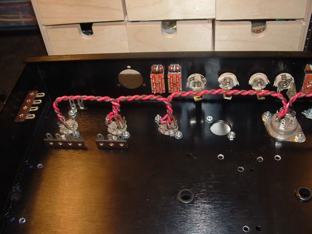

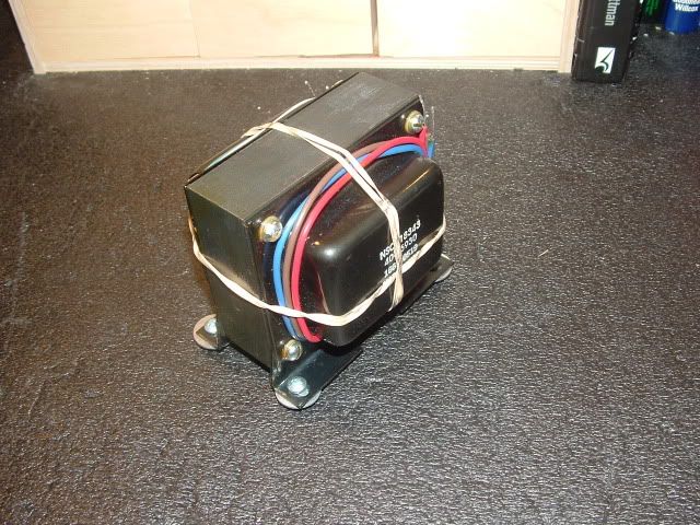

Did a bit of work a while back, then went away for a while. Came back yesterday and got a bit more work done today. So far I have done all chassis work. Well actually I need to grind the chassis under all the 1/4" jacks but o well. All hardware fits and there is no problems! Mounted and tightened all the back hardware but not the front yet. Still missing an 18mm 250K(A) pot!!!
Also started work on the PSU and main board eyelet. Still not total complete on either of them. Still have to do more research and figure a few things out. Also wired the heaters, did them in the true HAD ODS style.
O also got a 50W Bassman OT, it has 4R, 8R and 16R taps.
[IMG:640:480]http://img.photobucket.com/albums/v610/ ... aters1.jpg[/img]
[IMG:640:480]http://img.photobucket.com/albums/v610/ ... aters2.jpg[/img]
How do the heaters look? I tried to do them the same as the real deal.
[IMG:640:480]http://img.photobucket.com/albums/v610/ ... /ODSOT.jpg[/img]

Wire color coding same as real #124. Really like this solid core teflon wire.
How so I look so far?
Thanks guys!
